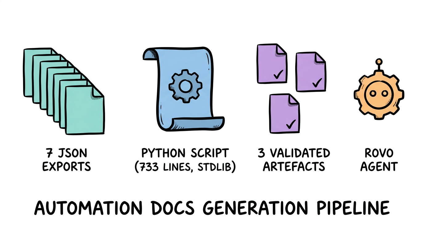

The pipeline has three stages that feed the Rovo agent:
Seven inputs feed the script: the automation rules export from Jira, plus six reference exports that resolve the raw IDs the rules are full of — project IDs, user account IDs, custom field IDs, issue type IDs, link type IDs, and status IDs. Three of those six come from the same admin CLI tooling used to manage the instance. Build the extraction layer once, and the agent knowledge falls out of it cheaply.
Three outputs come out the other side:

They ship as a set. Never update one without the others.

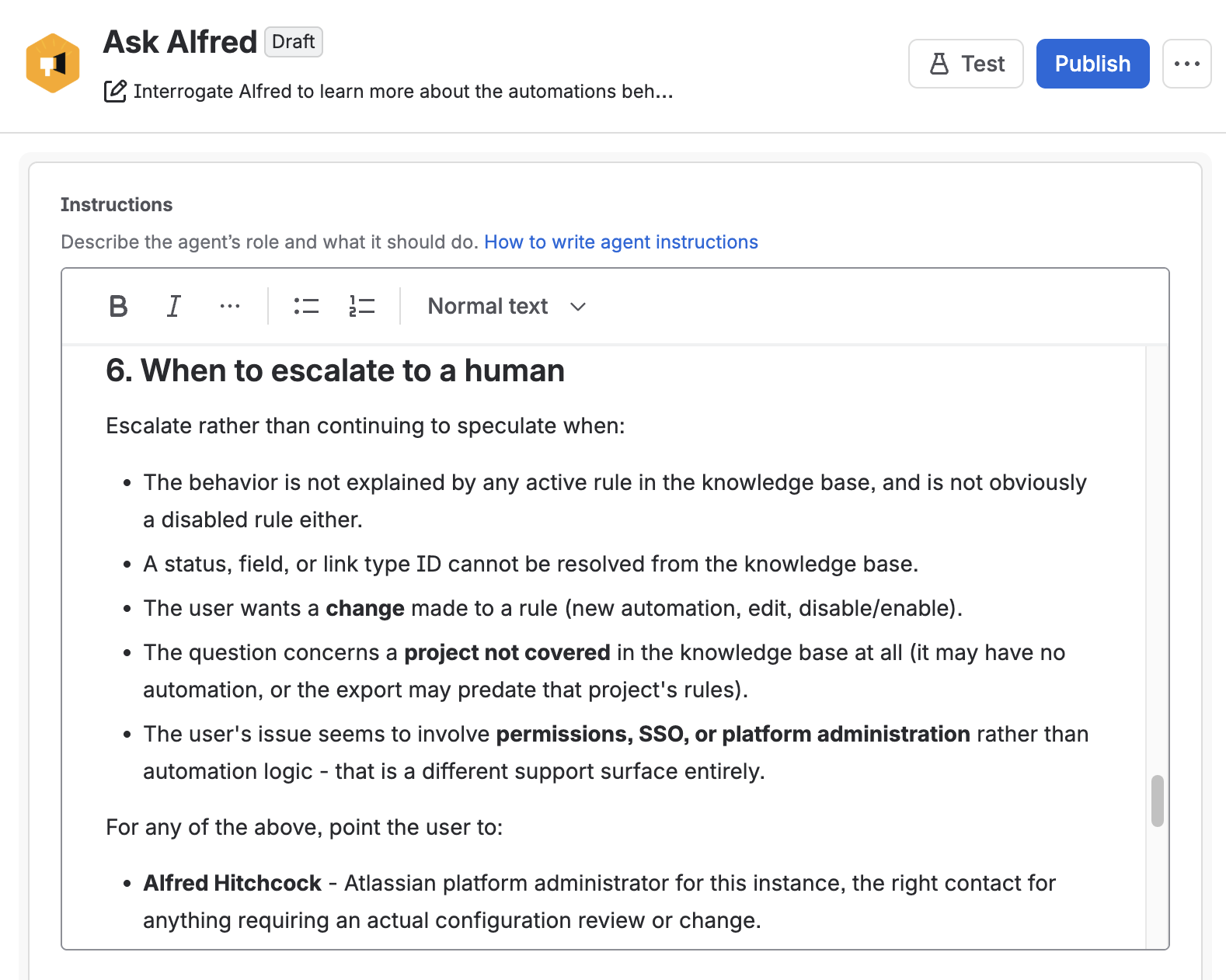

The agent instructions then bind the agent to that same distinction. It's instructed to preserve the confirmed/inferred language when it answers, and to say "I can't confirm that" rather than guess.

The agent instructions are a template, not a translation — the project list and escalation contact are the only dynamic insertions. Policy is a human judgement call, not something derivable from JSON.

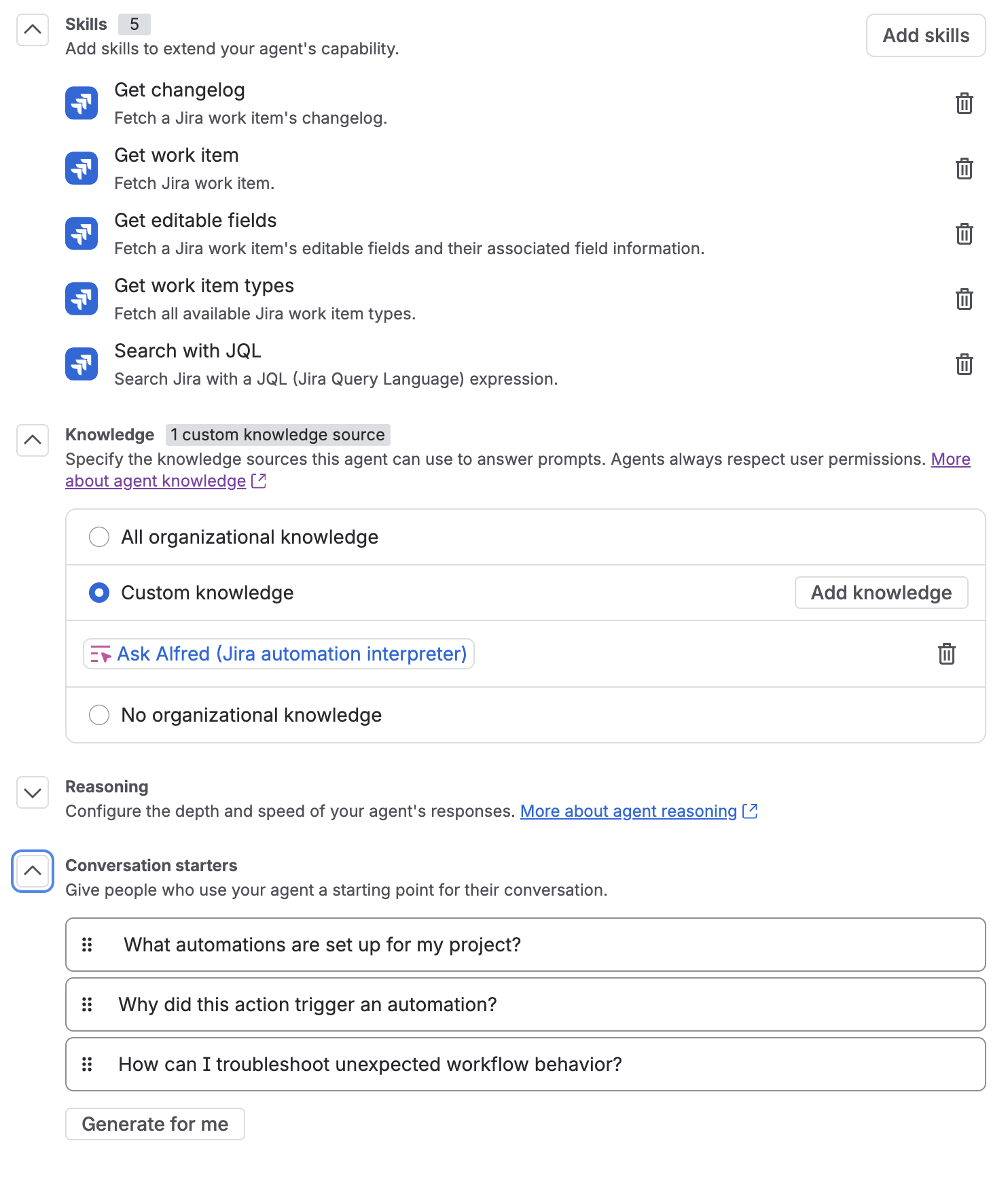

In the Rovo agent builder, the knowledge section is set to Custom knowledge with a single source attached: a Confluence knowledge base named Ask Alfred (Jira automation interpreter). That's the 192 KB plain-English translation file — the one the script generates. No other organisational knowledge is enabled. The agent knows exactly one thing, and it knows it well.
Five Jira skills are also enabled — Get changelog, Get work item, Get editable fields, Get work item types, and Search with JQL — so the agent can look up live issue state when it needs to, rather than reasoning purely from the static knowledge base. The knowledge base explains the rules; the skills let it check the facts.
Three conversation starters are configured to give users a foothold:
- What automations are set up for my project?
- Why did this action trigger an automation?
- How can I troubleshoot unexpected workflow behavior?
They're intentionally broad. The goal isn't to anticipate every question — it's to signal the shape of what the agent can do, so users don't open it and stare at a blank prompt.
