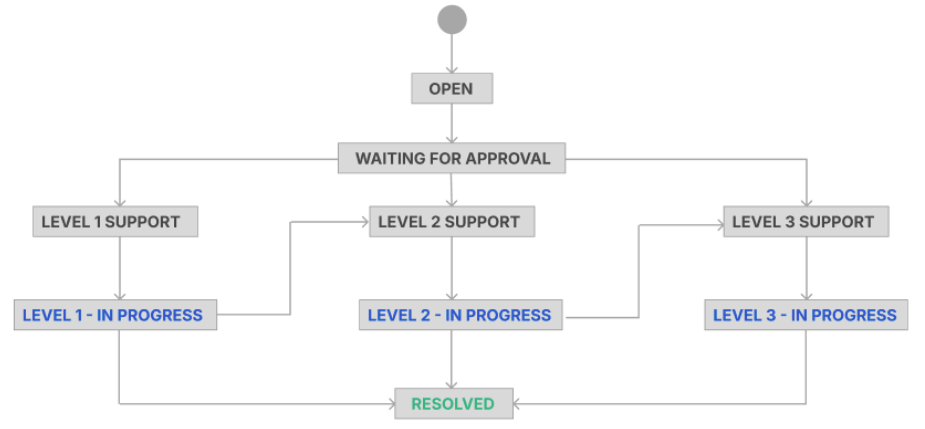

Atlassian publishes a way to calculate time spent at each stage of a workflow, and the total time on the issue, using native automation. It's worth a look, because it doubles as an honest illustration of what it takes to get any status-based duration without a dedicated report.
To track time across four support levels in one sample workflow, the setup calls for:
A start-date field, an end-date field, and a running-total field for every stage measured, plus one more field for the grand total across the whole issue.
Automation conditions that compare the changelog's "from" status against a numeric status ID, looked up manually from the workflow admin screen.
Extra arithmetic in every condition block, adding the new duration to the existing total, so a reopened issue doesn't overwrite the time it already logged at that stage.
That's for one workflow with four stages. Rename a status, add a stage, or let an issue skip one, and the fields and conditions need updating by hand. None of it applies retroactively either, since the automation only starts recording from the moment it's switched on.
This isn't a flaw in Atlassian's documentation; it's a fair picture of what native tools require to produce this number.

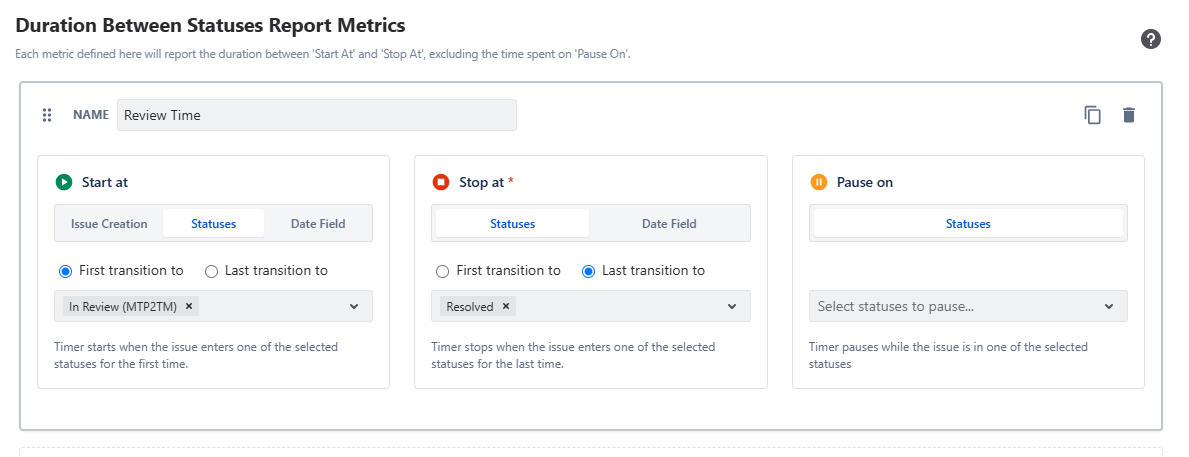

In Timepiece - Time in Status for Jira, this is a report type called Duration Between Statuses (DBS). Instead of a field pair per stage and hand-maintained status IDs, a metric has a name and 3 settings:
Start At: Where the clock starts: issue creation, one or more statuses, or a date field
Stop At: Where the clock stops: one or more statuses or a date field (required)
Paused on: Optional statuses where the clock pauses without ending the metric
Pro Tip: Instead of relying on status changes, you can set Start At and Stop At to trigger from date fields. This allows you to measure performance against actual, contractual deadlines rather than Jira workflow clicks.

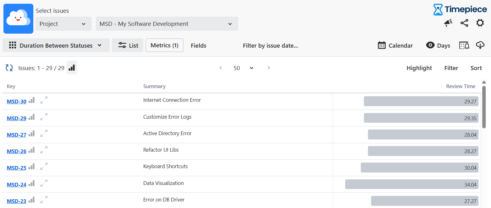

A metric named "Review Time," with Start At set to "In Review" and Stop At set to "Resolved," is calculated for every issue in the report using data Jira already has in its issue history, past issues included, with no fields to create beforehand.
If an issue can visit the same status more than once, choosing whether Start At or Stop At should count the first or the last visit sets exactly which occurrence anchors the metric, recalculated from issue history every time the report runs.
