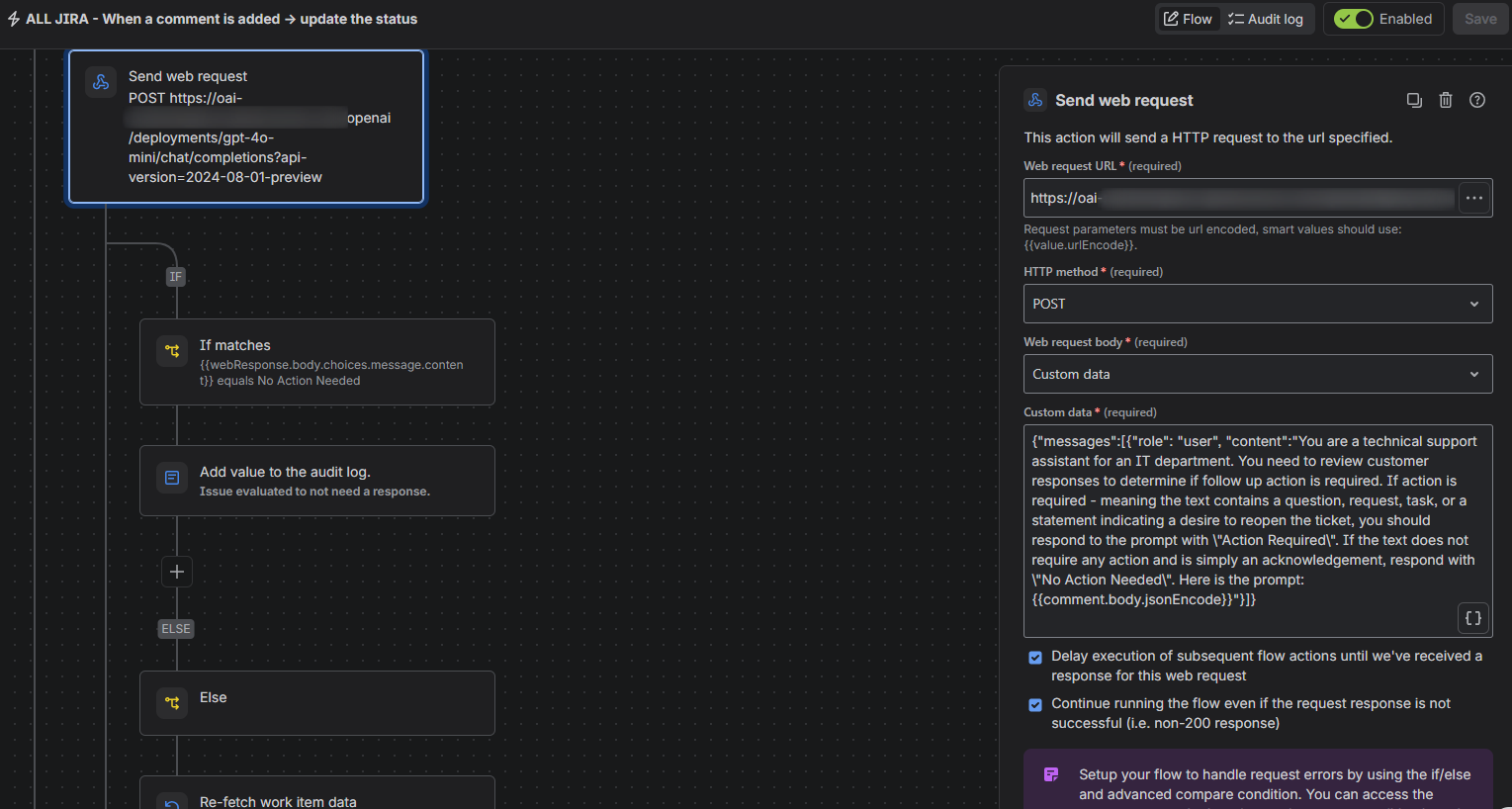

Our next step was configuring our automation rule to forward the comment body to the Foundry model. We did so using an authenticated web request action to send the prompt along with {{comment.body.jsonEncode}}.

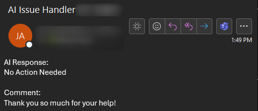

Initially, this was configured in a passive mode where we could review both the comment and the verdict it rendered via email without affecting the existing workflow. In the first 100, 98 had the verdicts we expected. One API call to foundry didn't receive a timely response, and one result was ambiguous whether the requester still needed assistance. In both cases, Automation would have reopened the request for the responder to review, which we felt was the preferred outcome.
Messages that were simply acknowledgements were properly assessed with "No Action Needed."

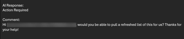

Messages that required follow-up were properly flagged as "Action Required," even when combined with appreciation for what was completed already.

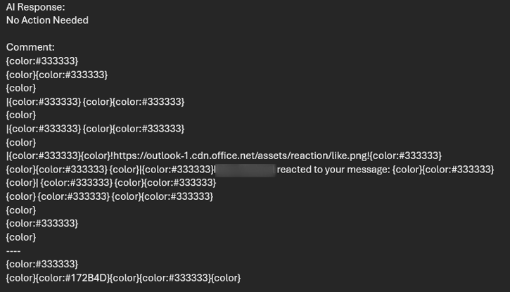

It even properly detected reactions 👍
The last step was to fully integrate this into the process with a conditional statement:

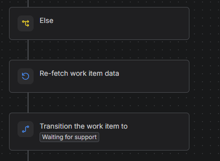

If matches {{webResponse.body.choices.message.content}} equals "No Action needed" This ensures that we require positive confirmation that no action is required. Any other response (or no response) will force the request into the ELSE condition which reopens the ticket.
