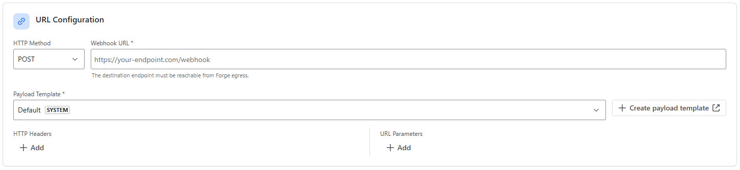

Choosing the method, the body, the headers and the query parameters per webhook.

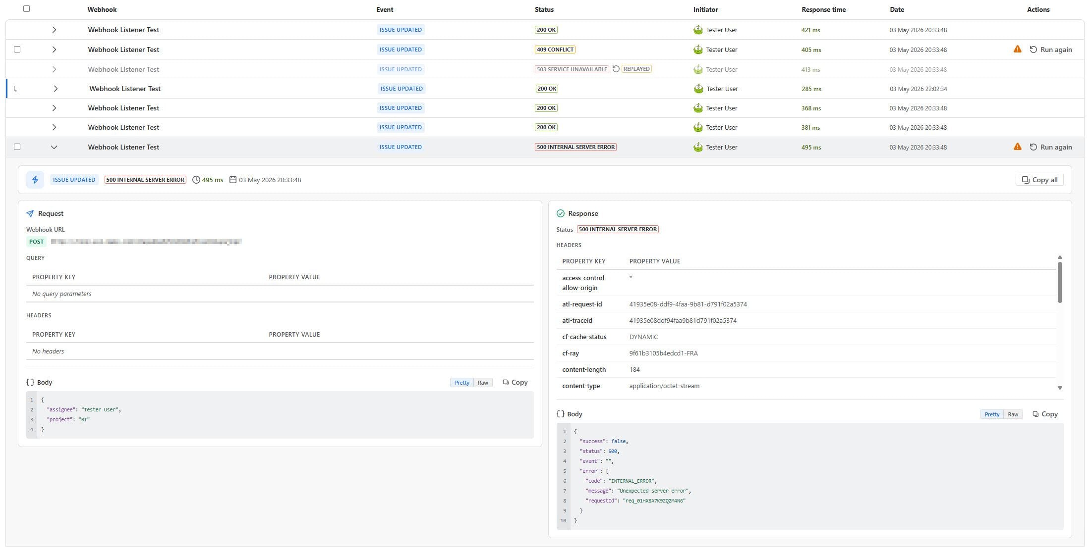

The same five cases, told apart: a 500 next to a 409 next to a replayed 503, and the receiver's own error body sitting beside the request that caused it.

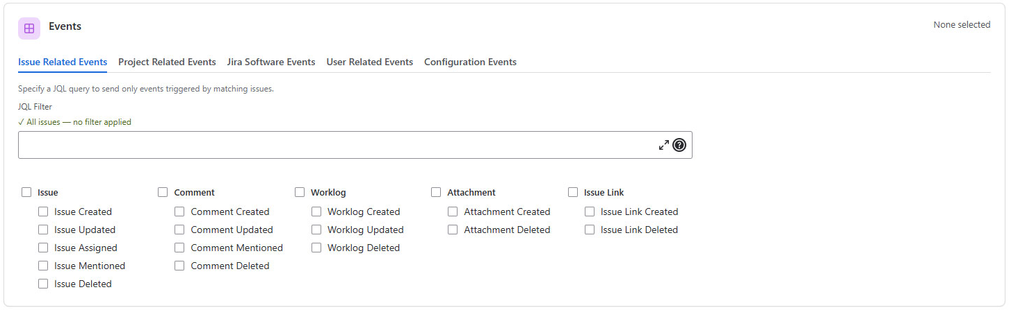

"Notify the on-call channel when someone is @-mentioned" and "sync our component list to the service catalogue" both sound trivial and both run straight into this.
Issue Assigned, Issue Mentioned and Comment Mentioned as ordinary checkboxes, alongside the JQL filter.

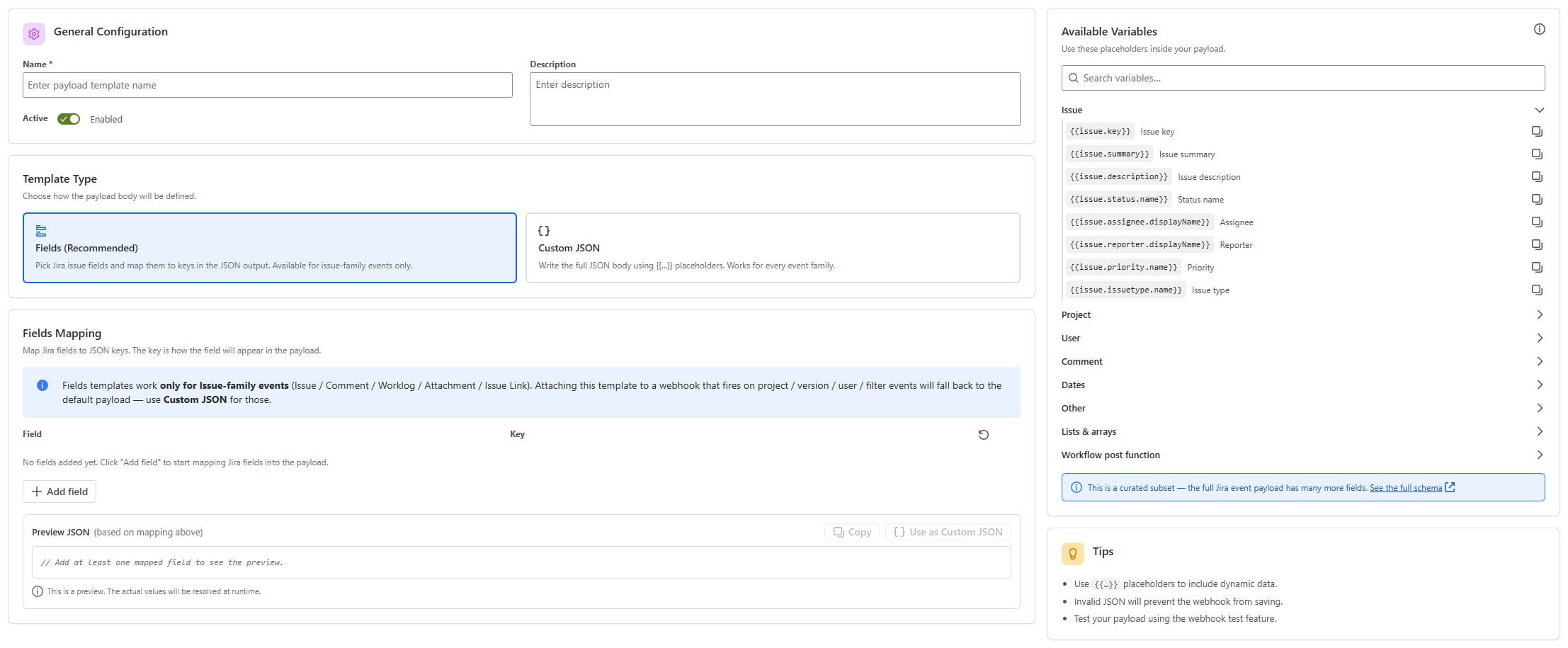

- Request shaping — choose the HTTP method, and define the body yourself. Either pick fields, or write the exact JSON with
{{issue.key}}-style placeholders. Custom headers and URL parameters too.
- Delivery logs — every attempt recorded with status code, request, and the response body the receiver sent back. When a delivery fails, you can see what the receiver said. Retention is configurable, 14 days by default.
- Replay — one-click or bulk re-send from the log. Worth being precise here: we deliberately do not auto-retry. Each event produces exactly one attempt, so a flaky receiver never gets amplified behind your back. You look at the log, decide what's worth re-sending, and re-send it.

Two ways to define the body: map Jira fields to keys, or write the JSON yourself.
