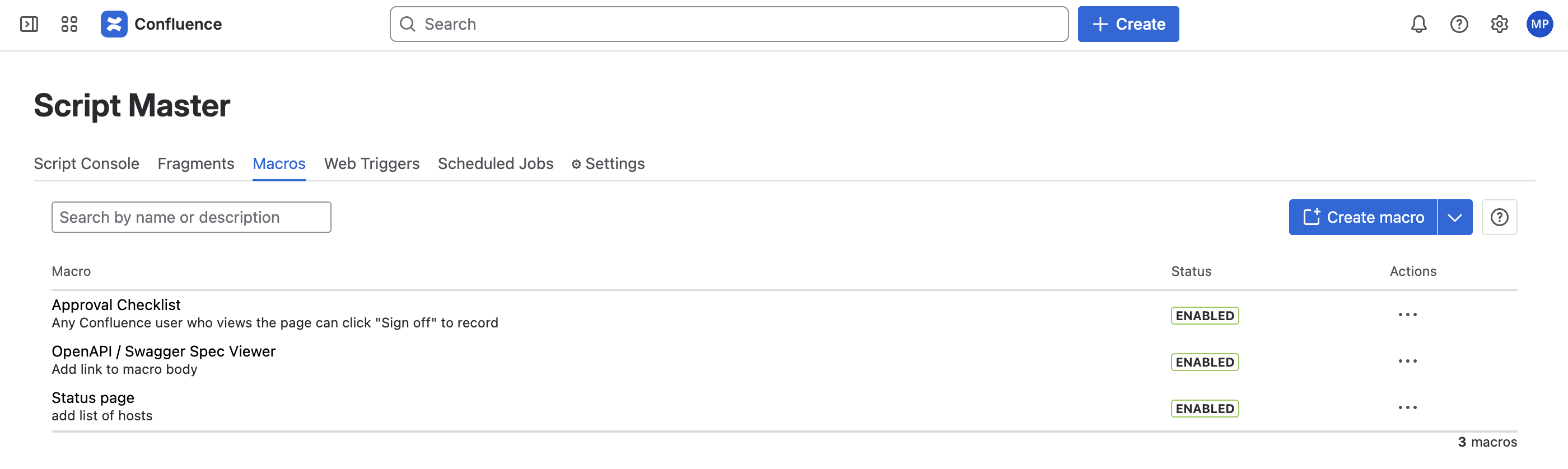

Image 1: Script Master main window
Click Macros in the navigation, then Create Macro. You'll land in the built-in code editor - syntax highlighting, autocomplete, and a library of ready-to-use snippets right there alongside your workspace.

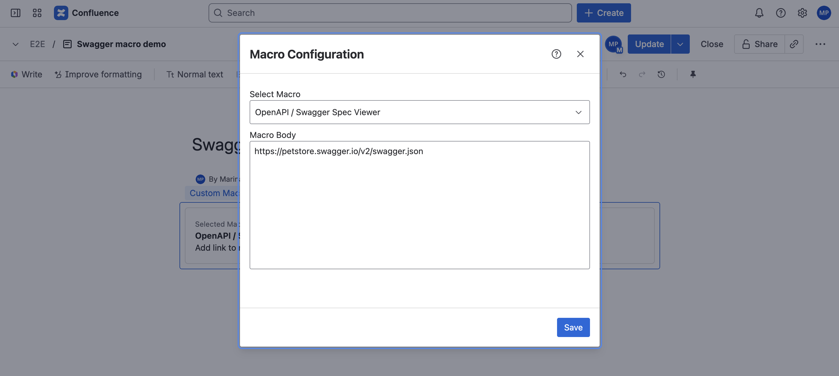

Now create a Confluence page and insert the Custom Macro. From the macro picker, select the one you just created. In the macro body, paste an OpenAPI spec URL - for example, petstore.swagger.io/v2/swagger.json. Save the page.
Image 2: Macro configuration

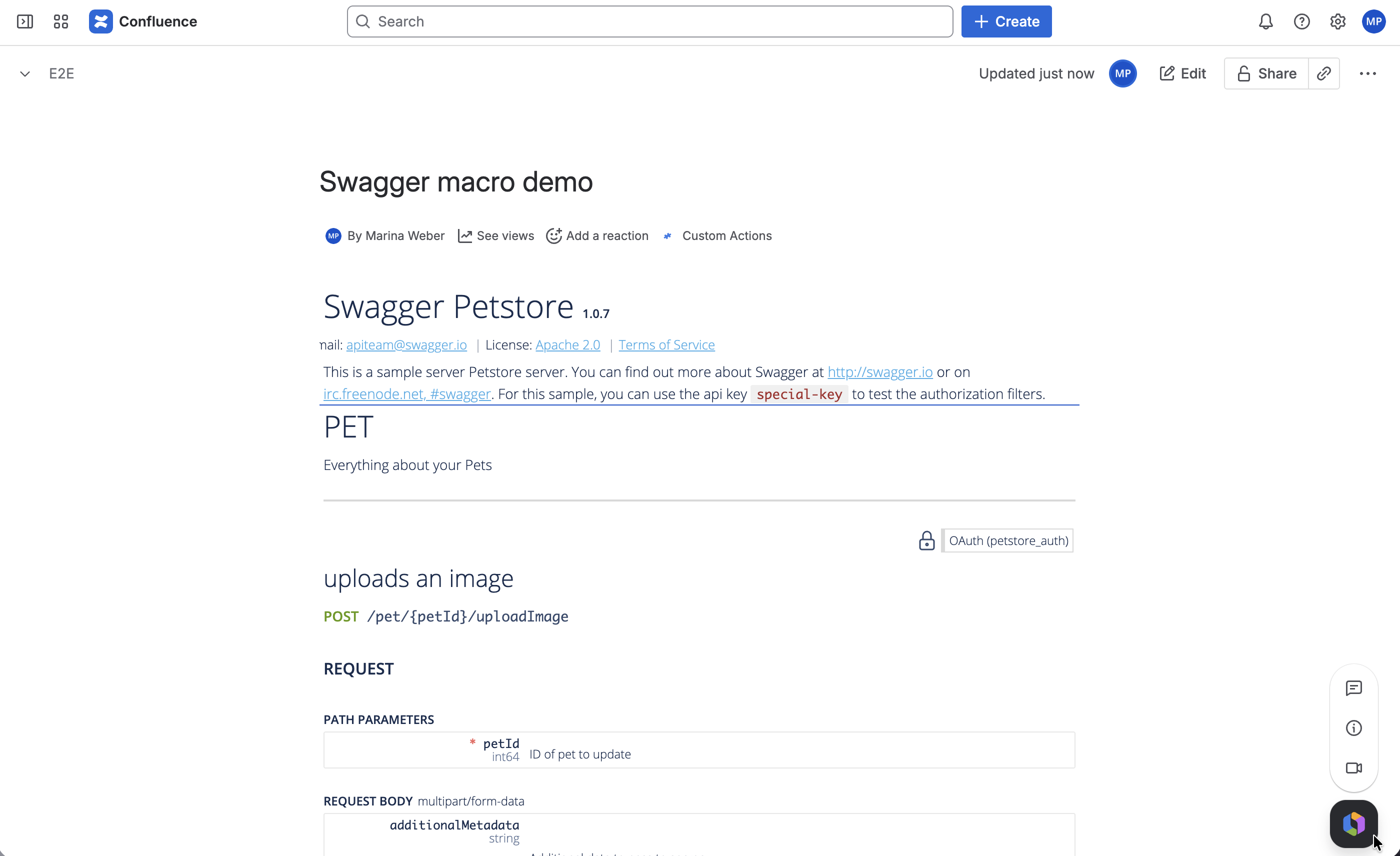

Image 3: Rendered Swagger UI on Confluence page
Your users now have a fully interactive API specification viewer, right inside Confluence. Total time? Depends on how fast your AI responds - but we're talking minutes, not days.
