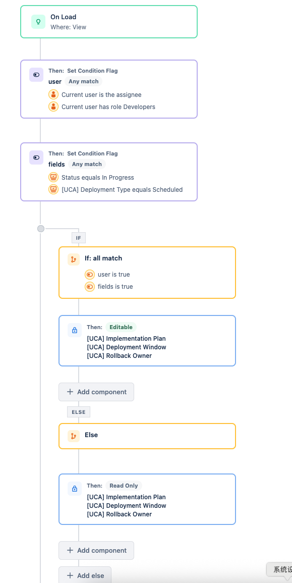

Another example: locking execution fields to the right people
A delivery team wants only the assignee or users in a developer role to edit `Implementation Plan`, `Deployment Window`, and `Rollback Owner` — but only when the status is `In Progress`. Everyone else should still see those fields, but they should be read-only.
As a visual rule in Auto Behaviour:
- Scope: `IssueView` for the target project.
- Conditions:
- `Status = In Progress`
- AND current user is the assignee, or is in the `Developers` project role
- IF branch (match):
- `Implementation Plan` → editable
- `Deployment Window` → editable
- `Rollback Owner` → editable
- ELSE branch (fallback):
- `Implementation Plan` → visible, read-only
- `Deployment Window` → visible, read-only
- `Rollback Owner` → visible, read-only
The key design choice here is that the fallback does not hide the fields. Other users still see the execution context; they just cannot change it. That is a deliberate UX decision that is visible in the rule itself — not buried in a conditional check on line 47 of a script.
