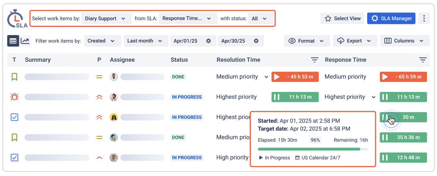

These answer different questions and should never be read as one number. For teams that want a live view without assembling this from JQL manually, SLA Time and Report for Jira provides an SLA Grid that does exactly this – sortable, filterable, and color-coded by breach state.

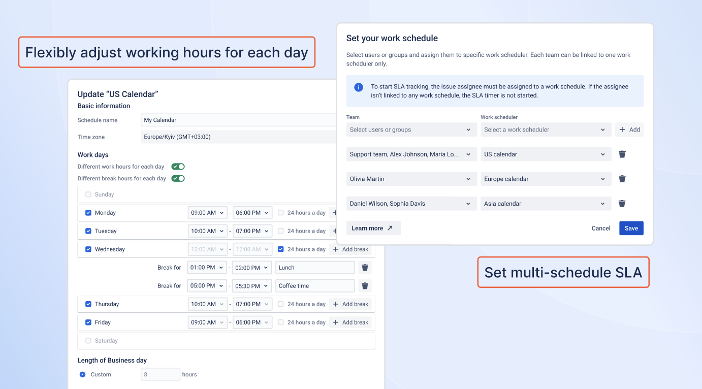

Calendar misalignment is one of the quietest sources of inaccurate SLA data. If the calendar doesn't match how your team actually operates, the SLA either runs when no one is working or pauses when people are available.
Common findings: a team switched to rotating shifts but the SLA calendar still reflects 9–5. A global team added APAC coverage but the clock runs on Central European Time, so tickets submitted Friday evening in Singapore breach over the weekend while the calendar says the business day has barely started. Check the calendar assigned to each active SLA goal and compare it to actual coverage.

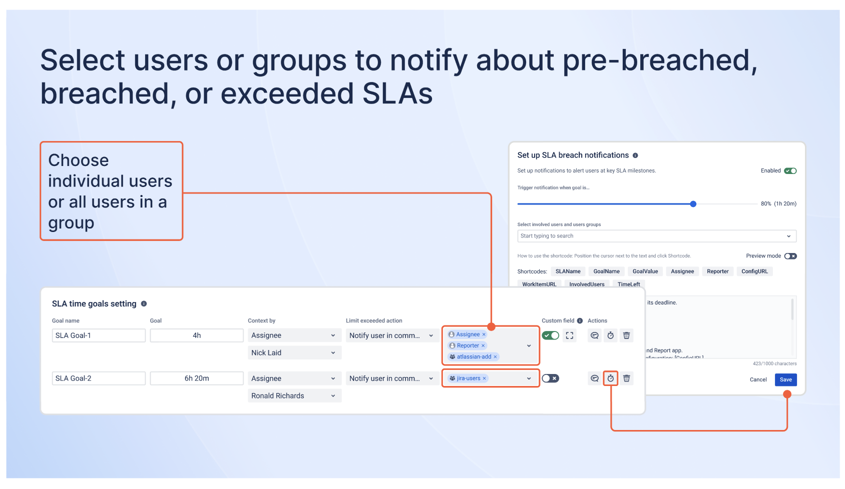

If tickets breach over weekends unnoticed, set up an automation that checks for approaching SLAs on Saturday morning and posts to a duty Slack channel. If high-priority incidents are slipping, add a pre-breach notification at 50% of the target – not 90%, which is almost always too late. If a handoff gap exists, automate a ping if a ticket sits in "Pending Engineering" for more than one business day without an assignee change.
SLA Time and Report supports this with configurable pre-breach and breach alerts tied directly to SLA state – useful when native JSM automation becomes too rigid for the workflow logic you actually need.
