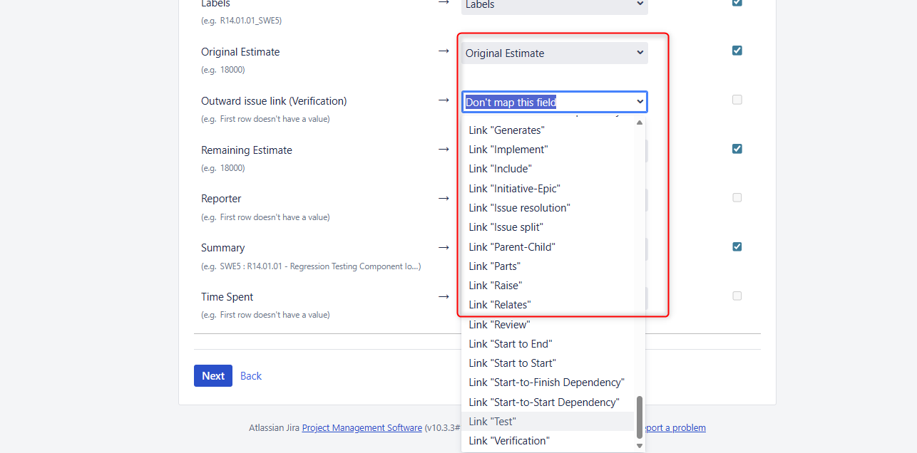

Issue link direction not applied as expected
- The project has a custom issue link type Verification, configured as:
- Inward link: verifies
- Outward link: is verified by
| Outward issue link (Verification) |
| R14.01.01_SWE5 |
- During the CSV import, mapping was attempted using both:
- Inward issue link (Verification)
- Outward issue link (Verification) (tested separately in different imports)
- Despite this, after import, the linked issues consistently appear only as “is verified by”, and it is not possible to obtain the “verifies” relationship through CSV mapping.
