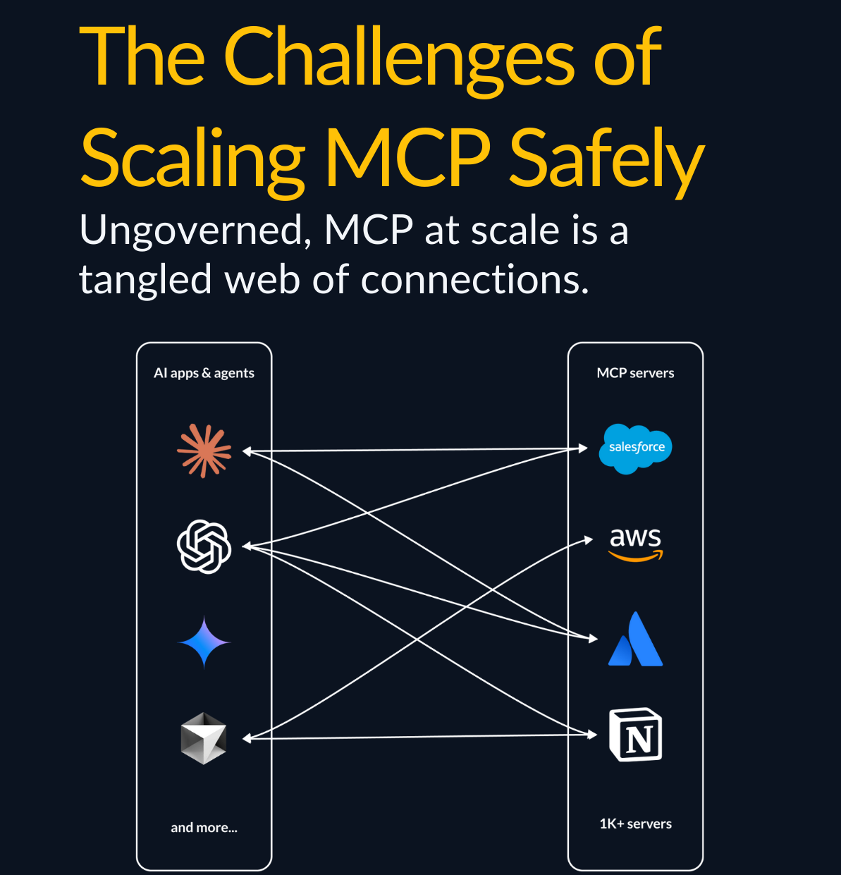

The Problem: When you connect your MCP client (e.g., Claude or Cursor) directly to multiple MCP servers (e.g., Atlassian, GitHub, Notion), you're managing:
- 3+ separate authentication flows
- No unified security policy
- No central audit trail
- Each connection is a potential attack surface
In essence, most teams roll out MCP like this:

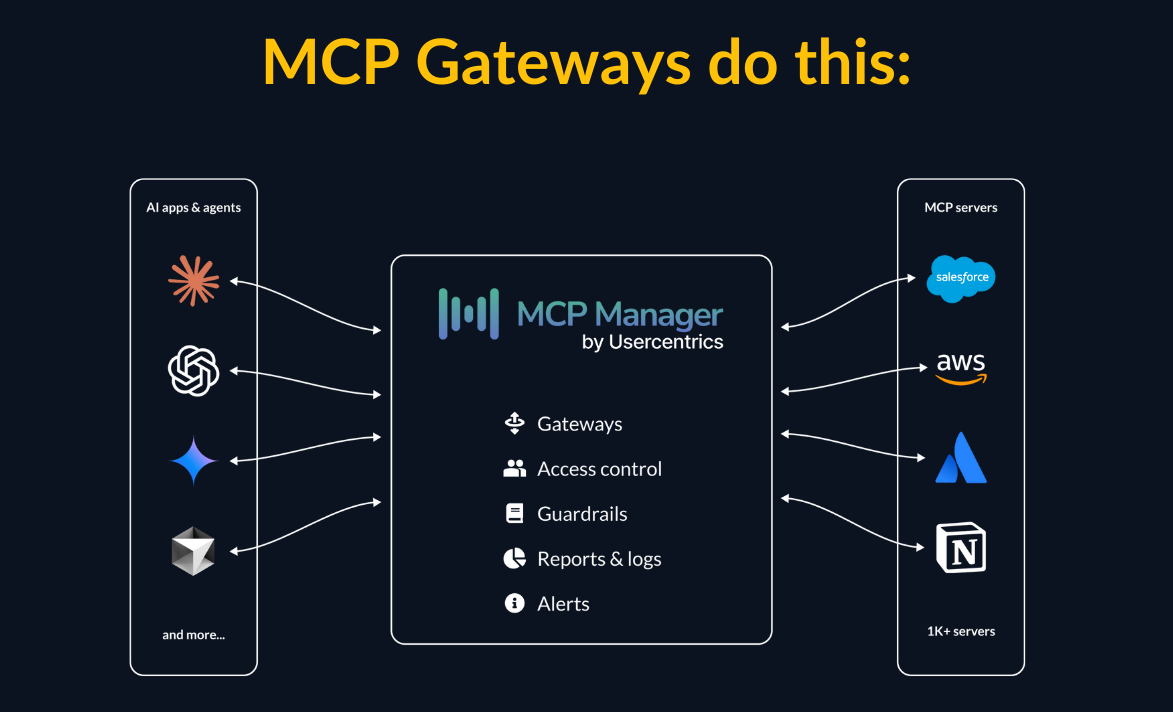

The Solution: MCP Gateway
Instead of this tangled web of data flows, you want an MCP gateway.
What this gives you:
- Centralized monitoring & policies - PII detection, RBAC, guardrails applied everywhere
- Single authentication point - manage all credentials in one place
- Unified audit logs - see all AI-to-data interactions across servers
- Tool-level provisioning - stop context bloat and overly provisioned agents by controlling what tools servers can call
- Security threat prevention - the ability to stop MCP rug pull attacks, tool poisoning, data exfiltration, and more
- Easier troubleshooting - one dashboard instead of hunting through multiple systems
