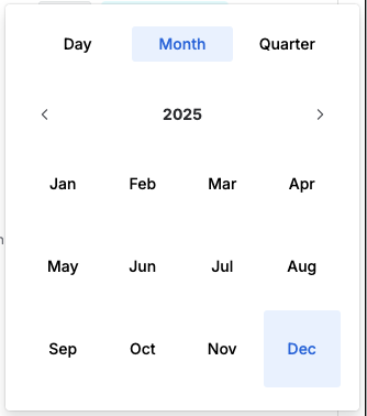

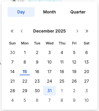

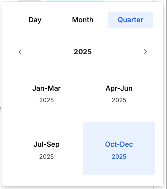

For those who are diving into using Jira Product Discovery, date fields there operate a little differently than elsewhere in Jira. Most notably, you can expand your dates to cover entire months, or even calendar quarters. For most Jira Product Discovery use cases, having a fuzzy date range instead of a single date can be very useful for planning. However, the structure of the date field in Jira Product Discovery deviates from how standard Jira works, and can cause confusion with automation rules.
Jira Product Discovery date fields can store dates in three different levels: a single date, a month, or a calendar quarter. As a result of this flexibility, date fields in Jira Product Discovery store two values, a start date and an end date.
Here’s how that impacts those three date options:
- A single date - The start and end dates are the same.
- A month - The start date is the first of that month, while the end date is the last of that month.
- A calendar quarter - The start date is the first of the quarter, while the end date is the last of the quarter.

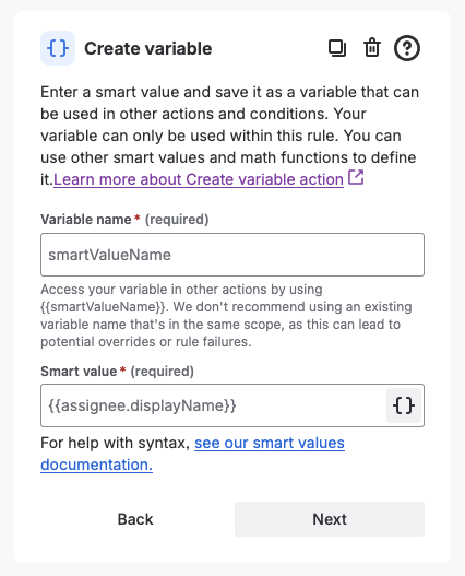

The easiest way to pull this value out, and store for future use within Jira Automation, is through the "Create variable" action. This action lets us create a new Smart Value / Variable in our automation execution, and populate it with the details of another smart value.
You can name the variable whatever you desire, it's the smart value field we need to focus on. You can choose whatever method described above to pull the date out. For later on, it's important to note if you store this as a date object, or a plain string.

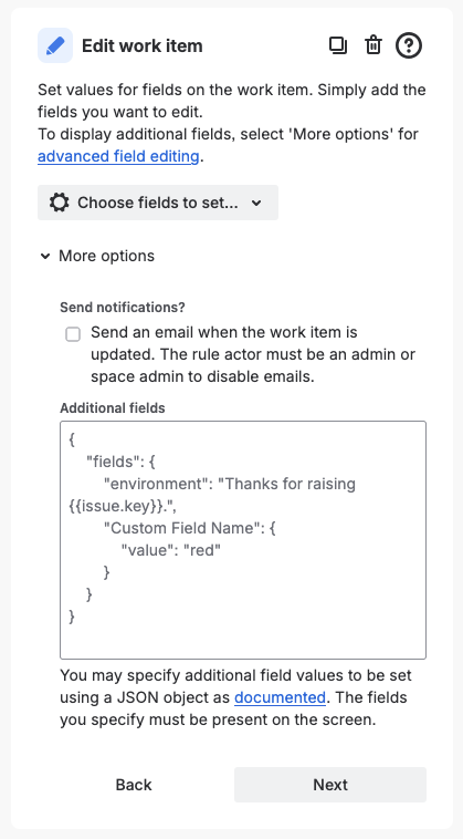

In addition, Jira Product Discovery date fields are not normally available as part of the standard fields listed in the "Edit work item fields" action, so we'll need to get a little advanced.
In the "Edit work item" action, there is an option for "More options". Expanding this menu lets you insert your own JSON to modify the fields on a given work item. This is where we need to get creative.
Here's the structure of the data we need to put in this field:
"fields": {
"customfield_54321": "{\"start\":\"yyyy-MM-dd\",\"end\":\"yyyy-MM-dd\"}"
Essentially, we're modifying a specific custom field, and giving it the JSON value it's expecting. Inside that are the two dates we need to provide.
What's great is this field supports Smart Values. So, all we need to do is input the variables you've created at the start into the field, and you're done.
