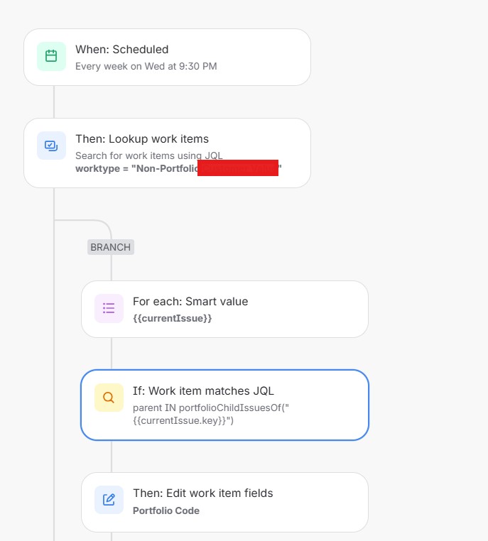

So ultimately I need to it to loop through the issues keys so it will update all child issues under ABC-123 and all child issues under ABC-124.

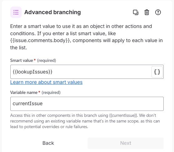

Based on a few examples, I built this so far but it does not work:
The advanced branching rule is
Can anyone give me some direction on the right path to get the outcome I'm after?
Also what should the JQL on the scheduler be set to given this automation will be updating many work types in many projects in jira?
