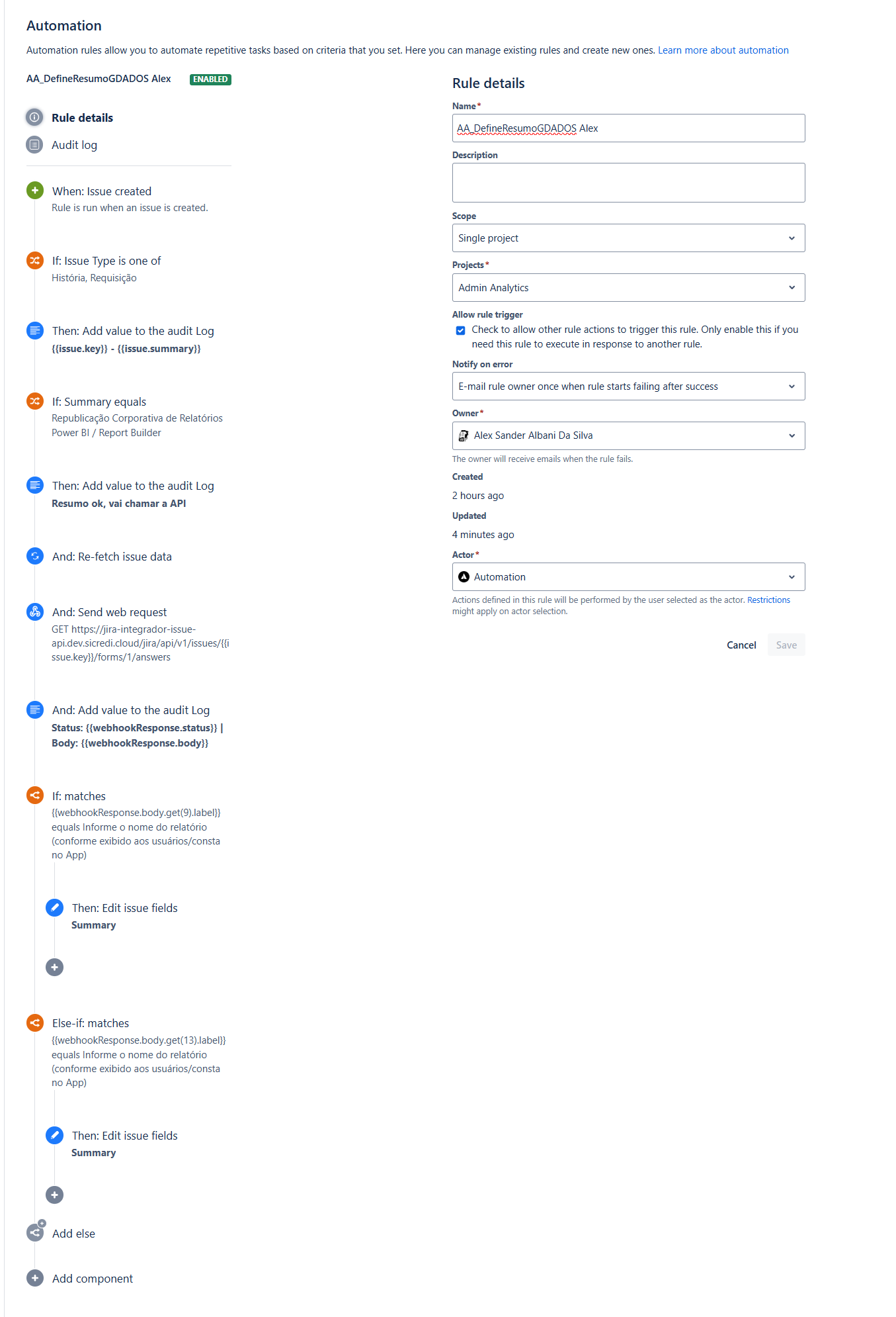

This is the rule:

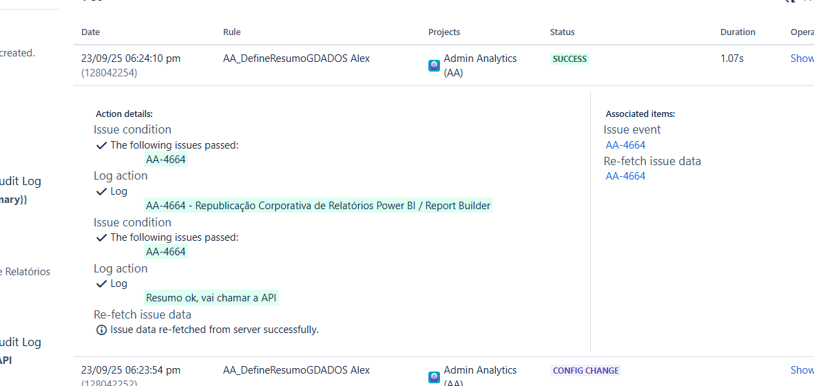

This is the execution log when a issue is created and the rule triggered. Note that it stops in the "Re-fetch issue data":

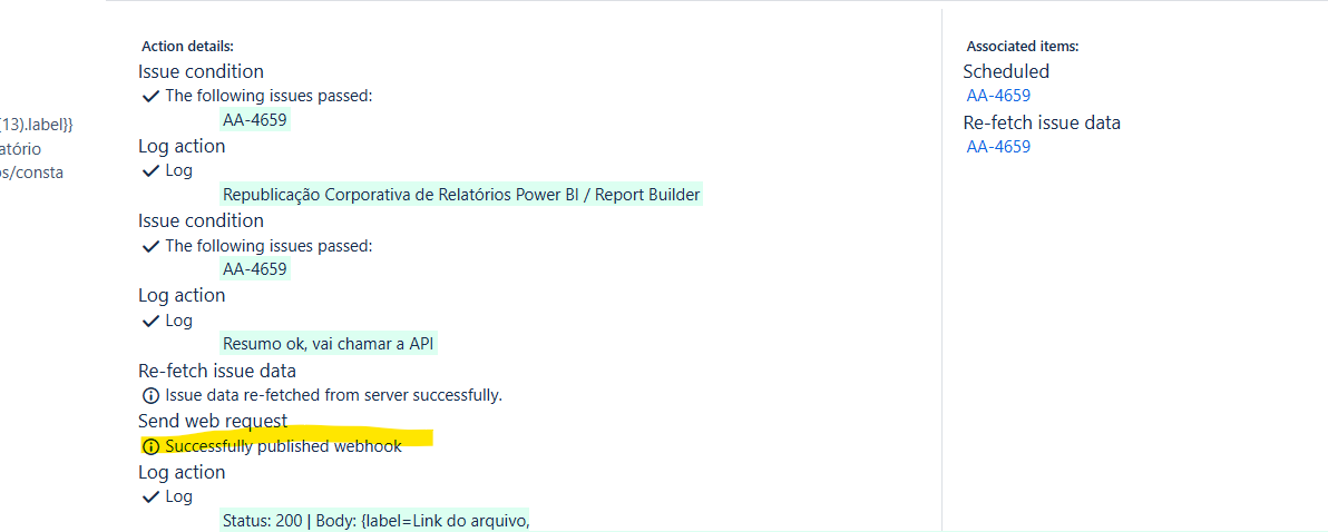

And this is an exemple of log with the same steps, with a trigger other than "issue created". In this case the trigger was a Schedule and the web request was raised:
