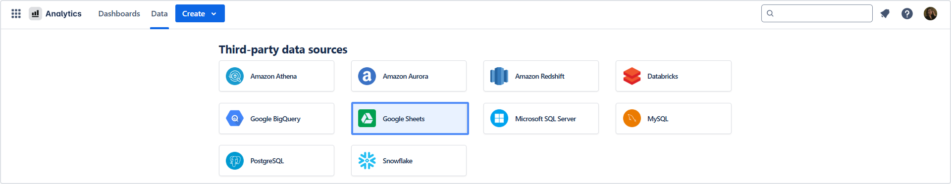

All integration options have already been listed above. I tested the one that is compatible with our Time in Status app — it allows you to access data via Google Sheet.
Here’s the exact flow I used for Time in Status:

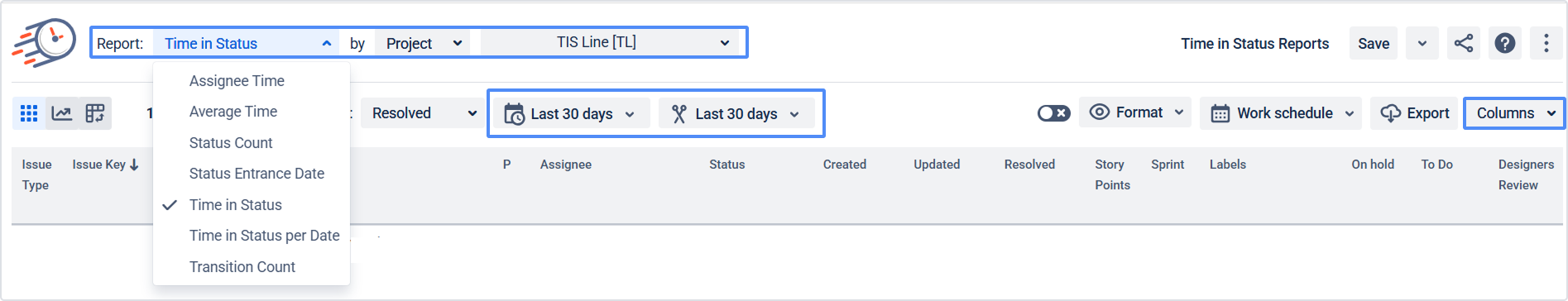

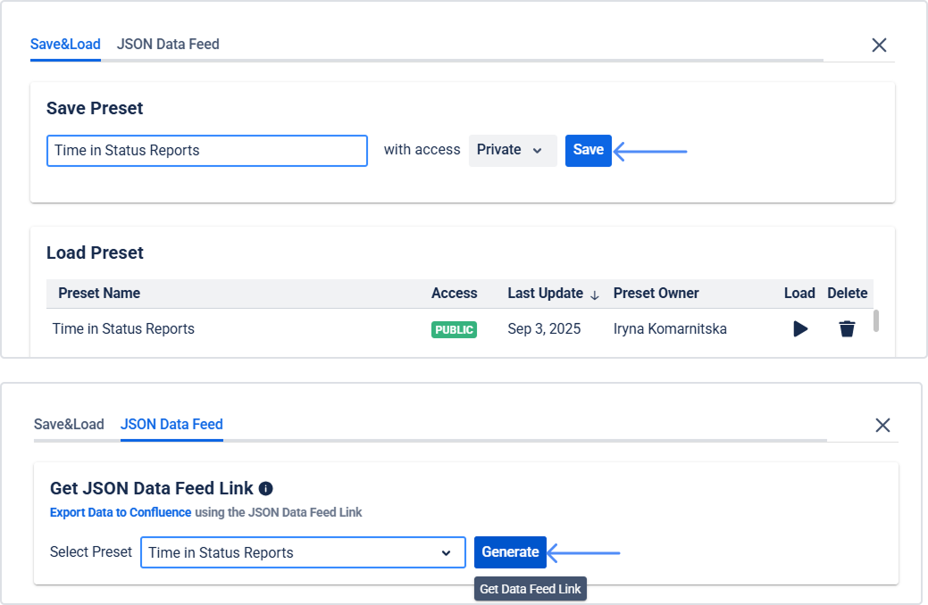

- In Build & save a preset in Time in Status. Use rolling dates (Last 7/30 days, Last month) so the data stays fresh without edits.
- Create a JSON Data Feed link for that preset and pipe it into Google Sheets with a refresh trigger. Changes to the preset sync into the sheet automatically.

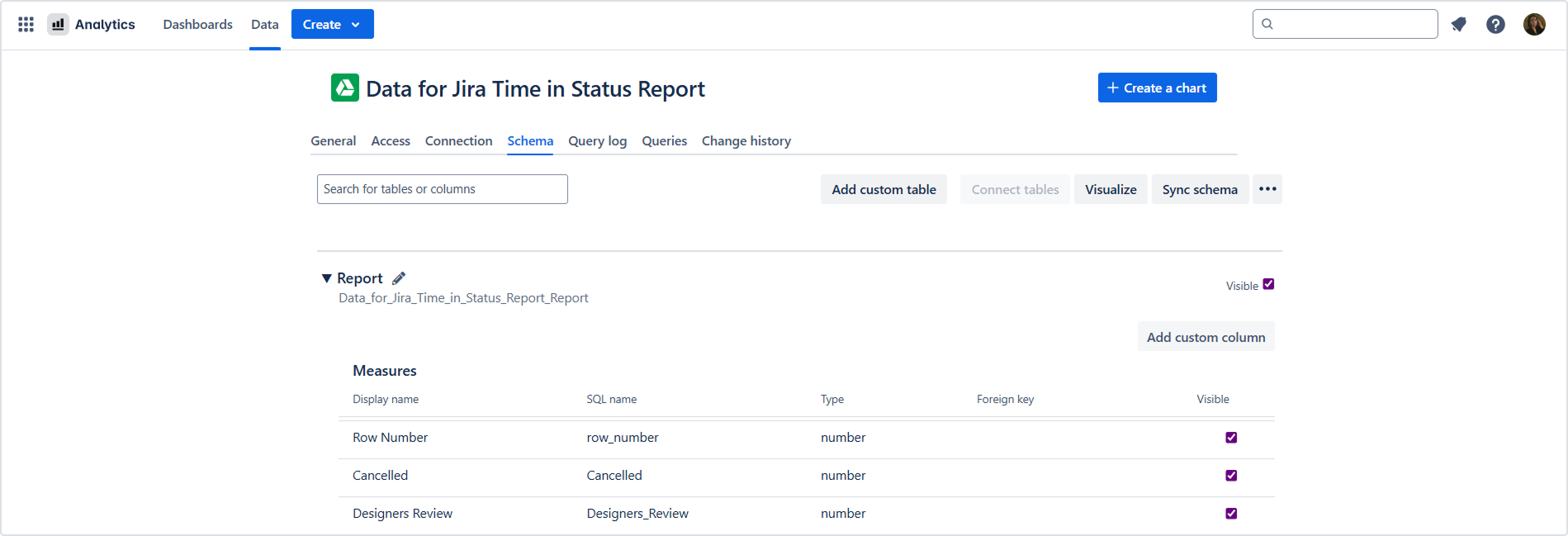

- In Atlassian Analytics, add Google Sheets as a data source, ensure dates are typed as dates and numbers as numbers, and then build your charts/filters. (You can also set a default workspace time zone.)

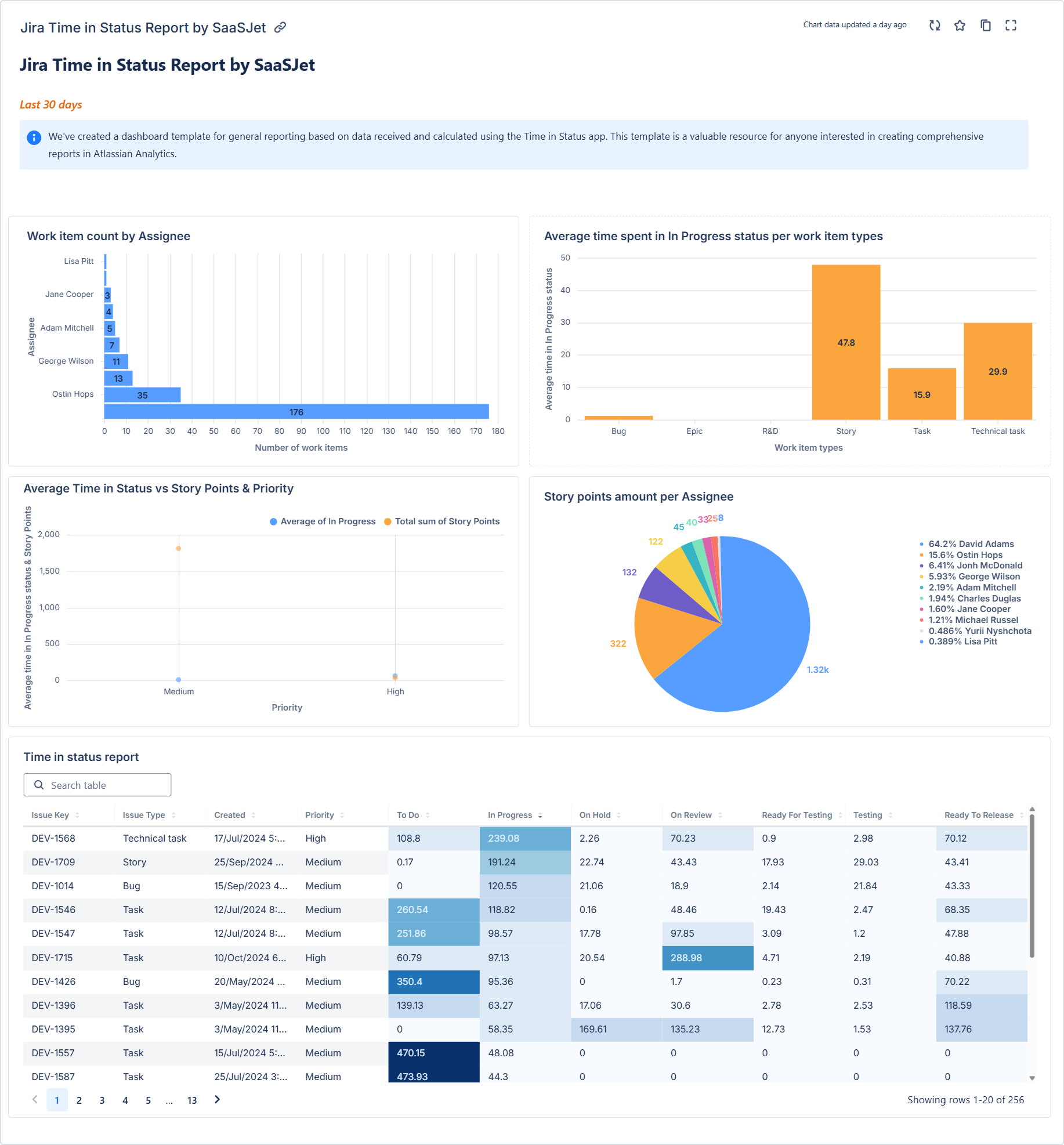

After configuring all the settings, I created this dashboard, but in reality, it's just an idea. You can create more charts and tables based on data from the Time in Status app, depending on your needs.
Your dashboard updates when the sheet updates. That’s it. If you add/remove columns in the preset, you’ll probably need to re-check visuals in Analytics. Stable columns = fewer surprises.

- Don’t rename columns casually in Sheets. Dashboards are picky about that.
- Type hygiene matters. Dates must be dates, not text that looks like dates.
