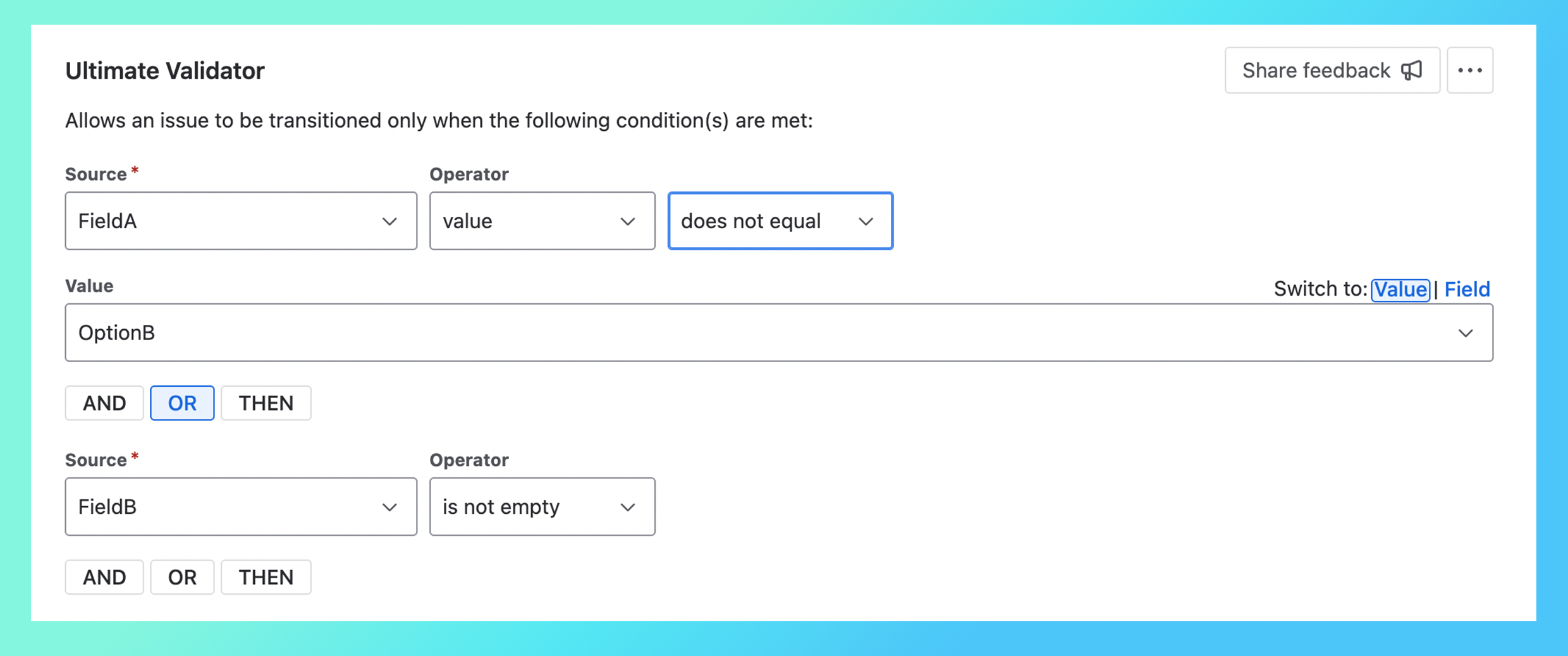

Previously, you could use the OR operator to simulate conditional logic. While functional, it required “reversing” the logic, which was not intuitive.
Example – old approach (using OR):
- FieldA = single select.
- FieldB should be required if optionB is selected in FieldA .
- To configure this, you would:
- Check whether optionB is not selected.
- OR, if it is selected, check whether FieldB is not empty.
This works because the second clause (mandatory field) is only checked when the first clause is false. However, the logic is reversed, which makes it harder to read.

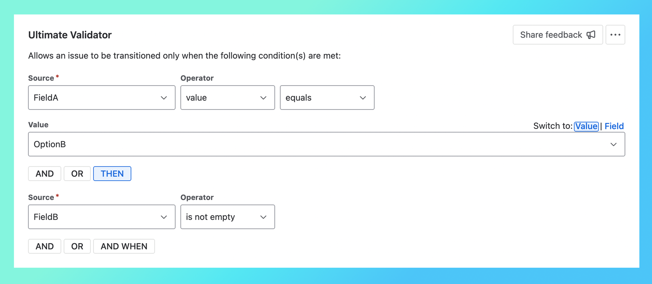

The New Approach: WHEN → THEN
With WHEN → THEN clauses, the same case can now be expressed naturally:
- When optionB is selected
- Then require FieldB to be not empty
Conditions separated by a THEN connector are wrapped in parentheses, allowing you to safely combine multiple requirements.

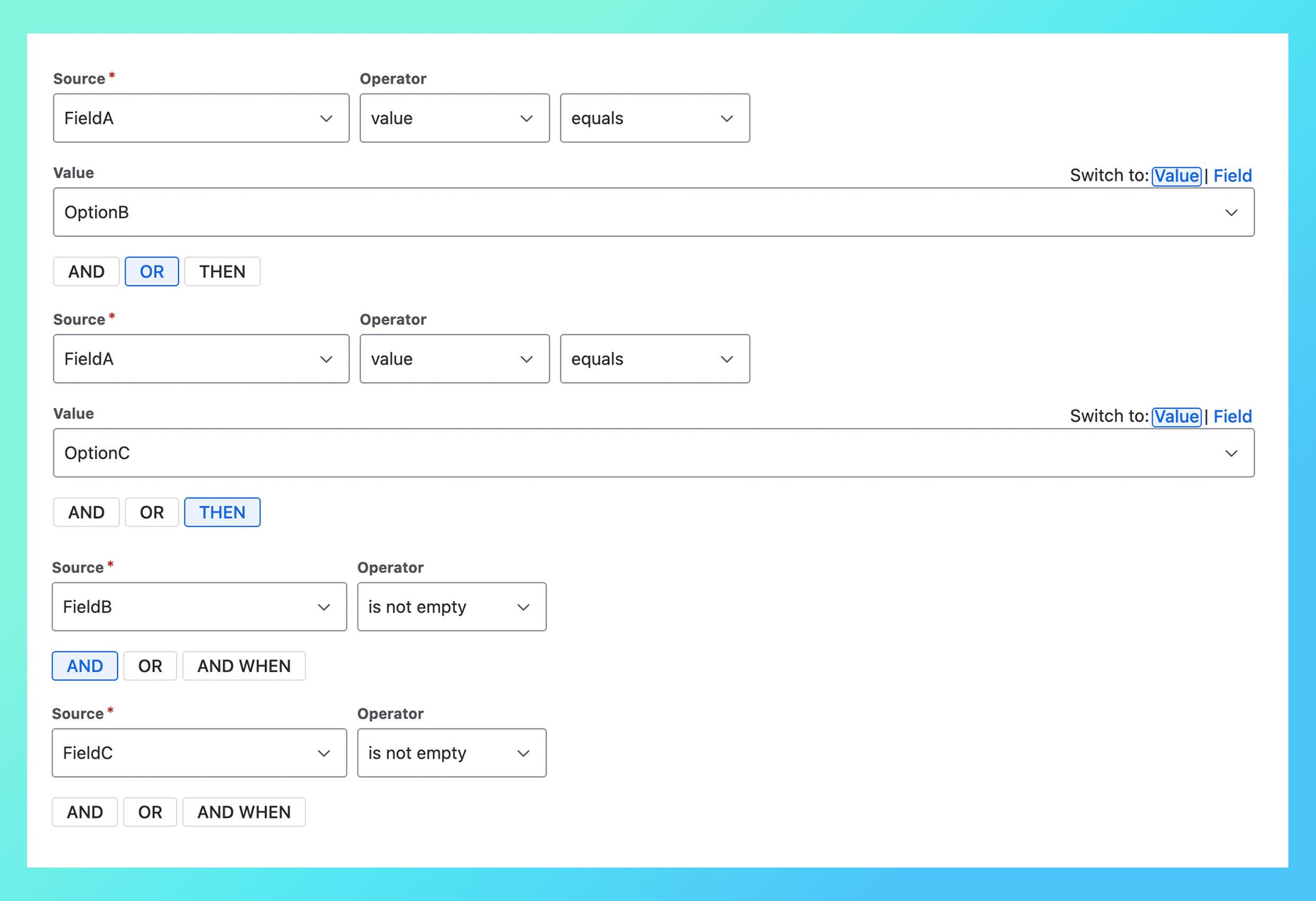

Example – multiple options:
- Make two fields (FieldB, FieldC) mandatory if optionB or optionC is selected.

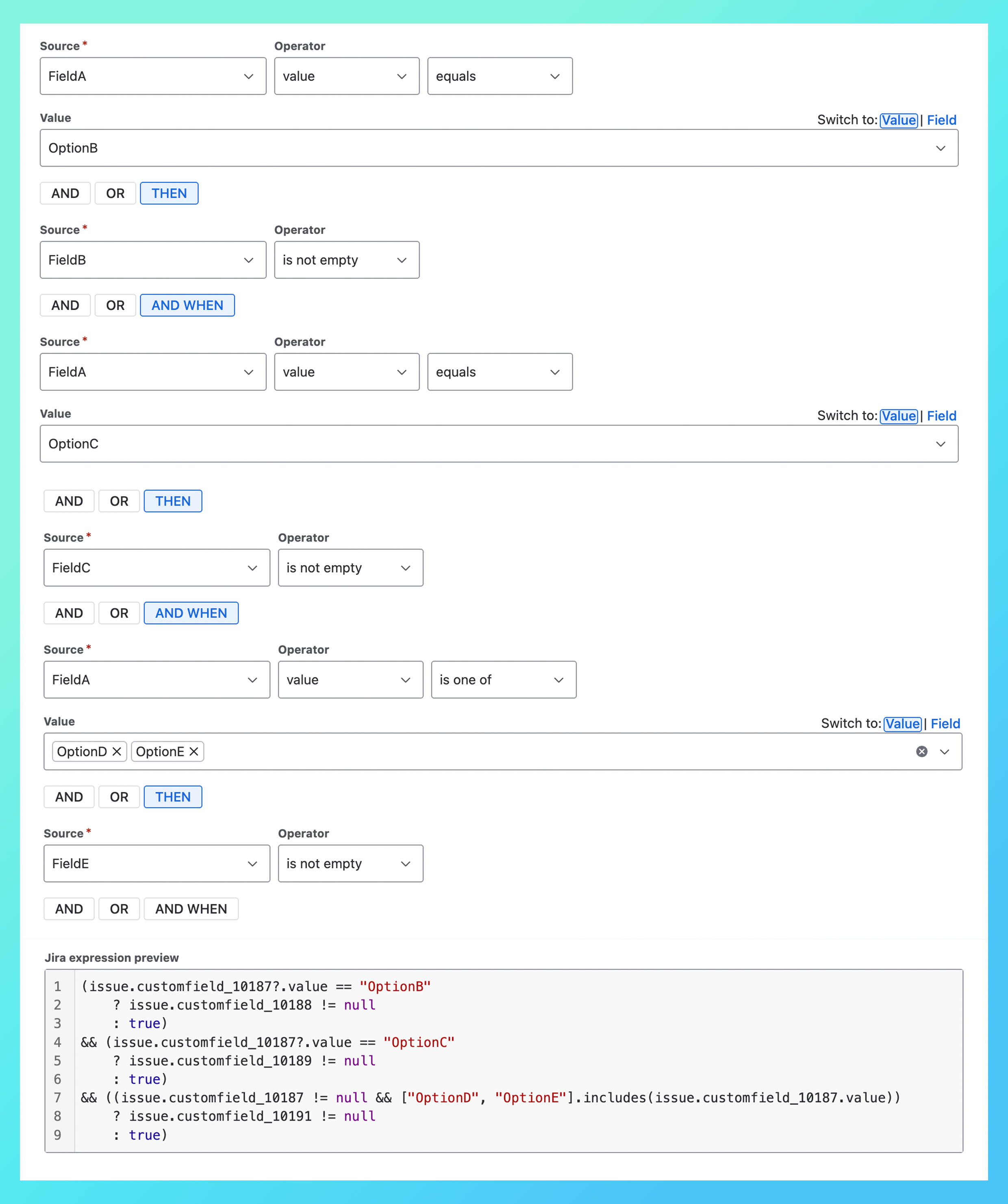

Chaining with AND WHEN Clauses
For more complex scenarios, you can chain multiple conditional blocks with AND WHEN.Â
Example – different fields required for different options:
- FieldB is required WHEN optionB is selected.
- FieldC is required WHEN optionC is selected.
- FieldE is required WHEN optionD or optionE is selected.
At the bottom of the configuration screen—just like in all our validators—you’ll find the Jira Expression Preview panel. This shows the exact Jira Expression generated from your setup, so you can confirm the validator does what you expect.
