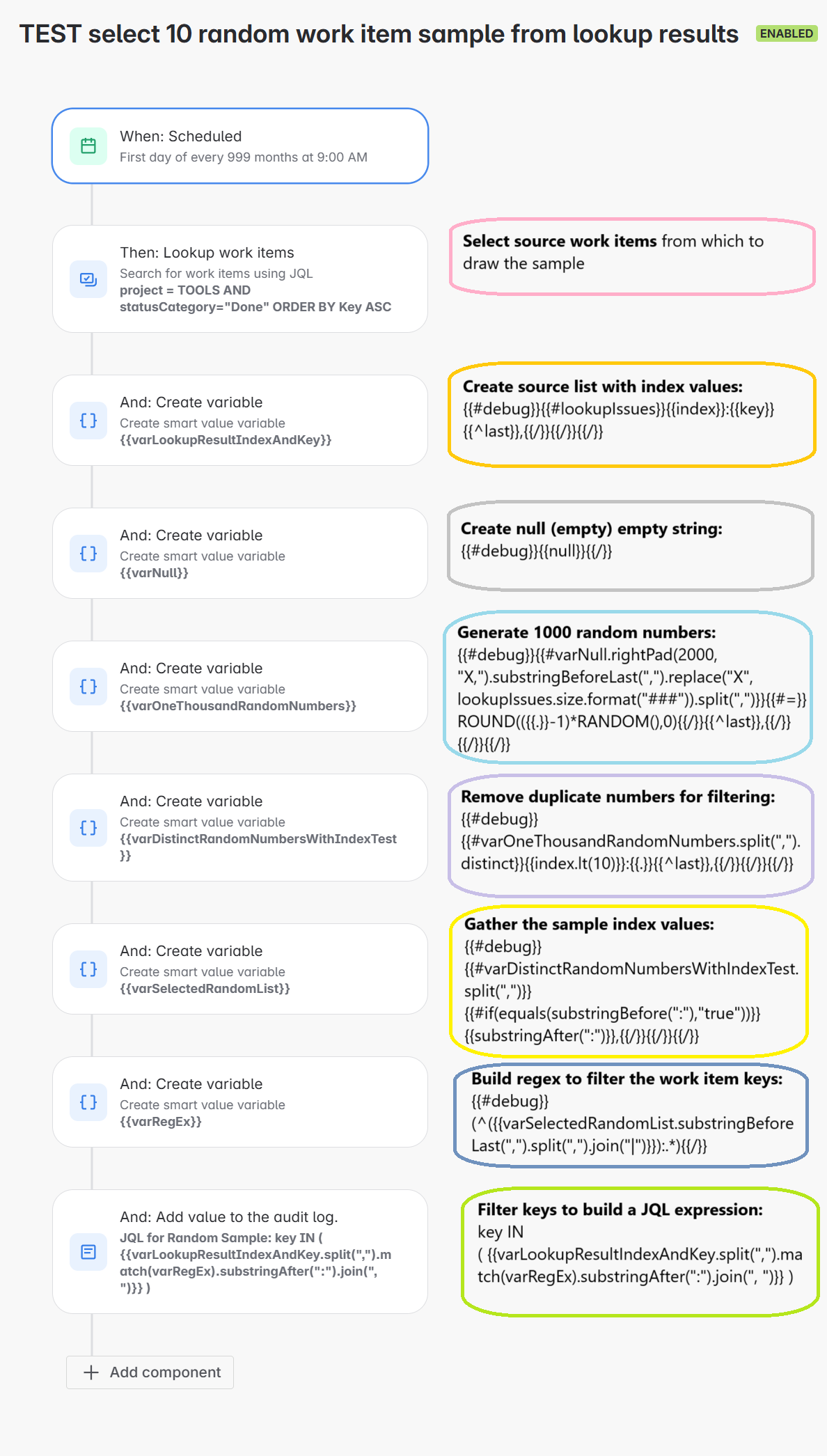

Using the rule for context, we explain how the pieces work, particularly the Create Variable actions. First, let's see the entire rule.
Other than the trigger and Lookup Work Items action at the beginning, the steps are essentially a series of Create Variable actions. These incrementally use each prior result to get to the answer.

Select source work items from which to draw the sample
We create and test the JQL for the source work items. My example rule only looks for completed items for a single project:
project = TOOLS AND statusCategory="Done" ORDER BY Key ASC

Create a source list with index values
We gather information from the lookup results, keeping only the work item key and the position in the list: the index. That is stored in a variable for the final filtering later.
- action: Create Variable
- variable name: varLookupResultIndexAndKey
- smart value:
{{#debug}}{{#lookupIssues}}{{index}}:{{key}}{{^last}},{{/}}{{/}}{{/}}

Generate a large pool of random numbers
We will need two variables to generate the large pool of numbers...
- variable name: varNull
- smart value:
{{#debug}}{{null}}{{/}}
Variables cannot be created empty in the rule editor, but we need an empty one as a starting point for our next expression. There is no smart value {{null}} and when an unknown smart value is used, that evaluates to an actual null value. And that then creates an empty string: a string with a length of 0. We covered this technique in the earlier article on using variables as numbers.
- variable name: varOneThousandRandomNumbers
- smart value:
{{#debug}}{{#varNull.rightPad(2000, "X,").substringBeforeLast(",").replace("X", lookupIssues.size.format("###")).split(",")}}{{#=}}ROUND(({{.}}-1)*RANDOM(),0){{/}}{{^last}},{{/}}{{/}}{{/}}

Remove duplicate numbers from the pool
The sample we created has no limitations, and as we see above, it contains duplicate values. We need to eliminate those with the distinct function, and then get just the first 10 distinct values.
And so, we run into the next challenge: although the {{index}} smart value would seem to help accomplish this, it cannot be used inside of a list filtering, conditional expression. We will defer this: check if a number is in the sample, but do no filtering yet.
- variable name: varDistinctRandomNumbersWithIndexTest
- smart value:
{{#debug}}{{#varOneThousandRandomNumbers.split(",").distinct}}{{index.lt(10)}}:{{.}}{{^last}},{{/}}{{/}}{{/}}

Gather the sample index values
Then with one more variable, we get the actual list of indices in the sample:
- variable name: varSelectedRandomList
- smart value:
{{#debug}}{{#varDistinctRandomNumbersWithIndexTest.split(",")}}{{#if(equals(substringBefore(":"),"true"))}}{{substringAfter(":")}},{{/}}{{/}}{{/}}

Build a regular expression to filter for the work item keys
We have our list of indices, and we need to filter for the work item keys. We do that with a regular expression and the match() function.
- variable name: varRegEx
- smart value:
{{#debug}}(^({{varSelectedRandomList.substringBeforeLast(",").split(",").join("|")}}):.*){{/}}

Filter keys to build a JQL expression
Applying that regular expression to our very first variable from the Lookup Work Items result, we get what we wanted:
JQL for Random Sample: key IN ( {{varLookupResultIndexAndKey.split(",").match(varRegEx).substringAfter(":").join(", ")}} )
