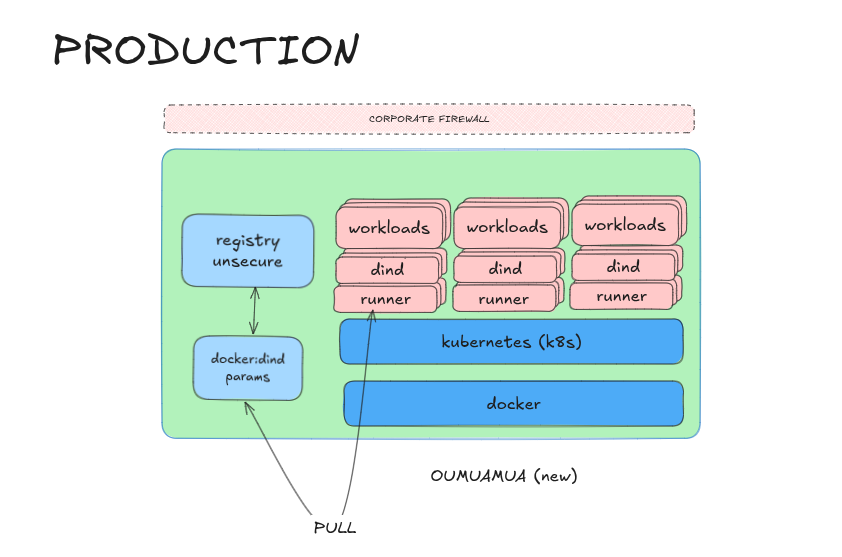

EDIT: Solution Implemented & Remaining Limitation
Thank you all for the input. I wanted to share the solution I eventually implemented and a minor limitation I encountered.
Initial Workaround (Abandoned):
Initially, I managed to work around the direct authentication issue by routing registry access through a proxy server that used IP whitelisting for authorization. While this technically allowed access, it introduced significant delays, making image download times during pipeline execution unacceptably long.
Final Solution (Improved Performance):
Due to the performance issues with the proxy, I opted for a different strategy focused on local access speed:
- Local Unsecured Registry: Deployed a standard private Docker registry container directly on the same Docker daemon that hosts the Kubernetes (k8s) node. This registry was configured to run without authentication (unsecured) for simplicity and speed, relying on network isolation instead.
- Customized DIND Image: Created a customized
docker:dind (Docker-in-Docker) image. The key modification was configuring the Docker daemon inside this DIND image to trust and allow pulling from the local, unsecured registry. This typically involves adding the --insecure-registry <registry-host-ip>:<port> flag to the DIND daemon's startup parameters. - Autoscaler Deployment: Configured the Bitbucket Runners Autoscaler (using its Helm chart/settings) to utilize this customized
docker:dind image for the runners it provisions.
This setup allows the DIND service within each runner pod to pull images very quickly from the registry located on the same host machine.
Remaining Limitation (Hostname Resolution):
The only drawback with this approach is accessing the local registry from within the DIND container using a hostname. Modifying the /etc/hosts file inside the docker:dind container (either during build or runtime) proved problematic. Therefore, any references to the private registry within pipeline steps (e.g., in image: definitions or docker pull commands inside scripts) must use the K8s node's IP address and the registry's port (e.g., image: 192.168.1.100:5000/my-image:latest) instead of a hostname like my-local-registry:5000.
Architecture Diagram:
