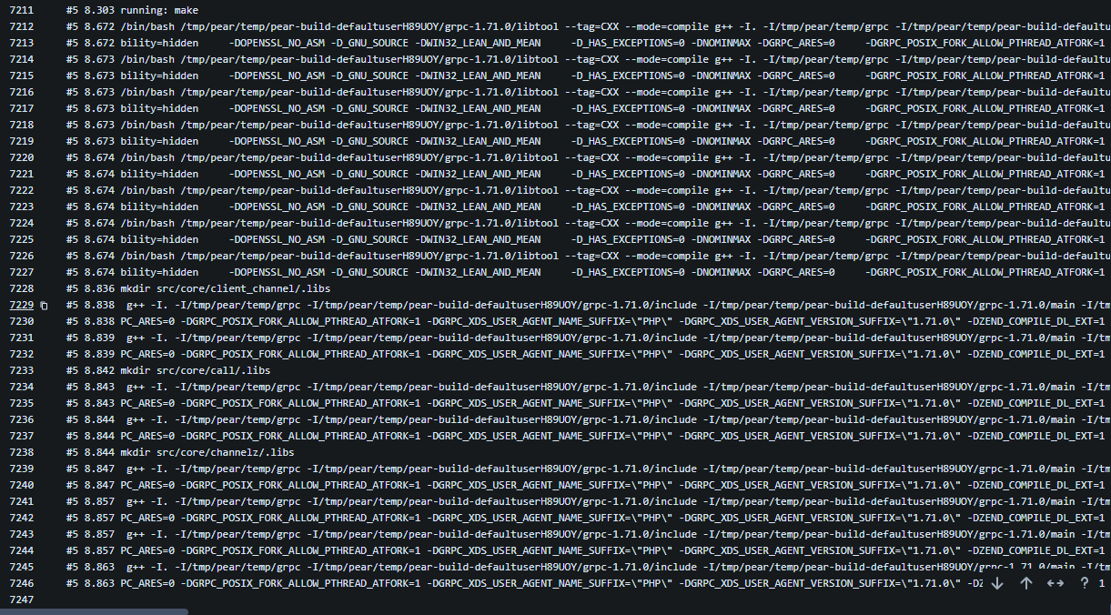

We have been using Bitbucket Pipelines to build a base docker image with a contained Dockerfile. Previously, this has been working fine, but recently, it has started hanging on the `pecl install grpc` line and fails after overrunning the max 2 hour run time.
I have tried upping the resources to no avail, has anyone been able to successfully build this for php8.2?
# Install PHP extensions
RUN docker-php-ext-install bcmath bz2 calendar exif ffi gd mbstring mysqli pcntl pdo_mysql opcache shmop sockets sysvmsg sysvsem sysvshm xsl zip gettext intl
RUN pecl install mongodb && pecl install imagick && docker-php-ext-enable mongodb imagick
RUN MAKEFLAGS="-j 8" pecl install grpc && docker-php-ext-enable grpc
