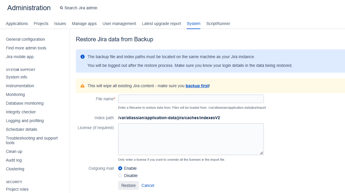

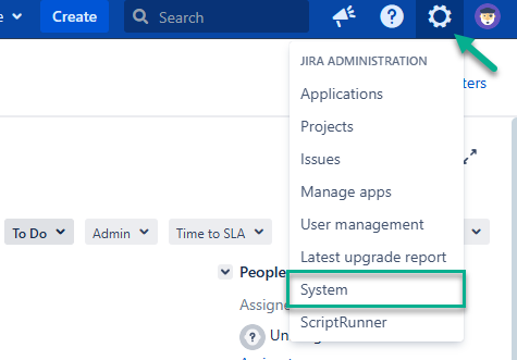

- Go to Administration > System.
- Navigate to Import and Export > Restore System.
- After that, specify the backup file. Type the name of your zipped XML backup file in the “File name” field. Check that the backup file exists in the correct location according to the page instructions.
- Confirm Index Path. The Index Path indicates the location where Jira will retrieve search index data. The chosen path in the backup file maintains its original structure and cannot be modified.
- Then, you need to start the process of restoring by clicking on the Restore button.
Also, during this process, it is recommended to pay attention to a few things. Firstly, Jira will automatically log you out after restoration because it uses backup user account data to replace current account data. You need to obtain login credentials for a backup user who holds the Jira System Administrator global permission.
Secondly, you must restore backup attachments into a directory that Jira can access. Jira must have read and write permissions for the directory and its subdirectories, where this backup should be restored.

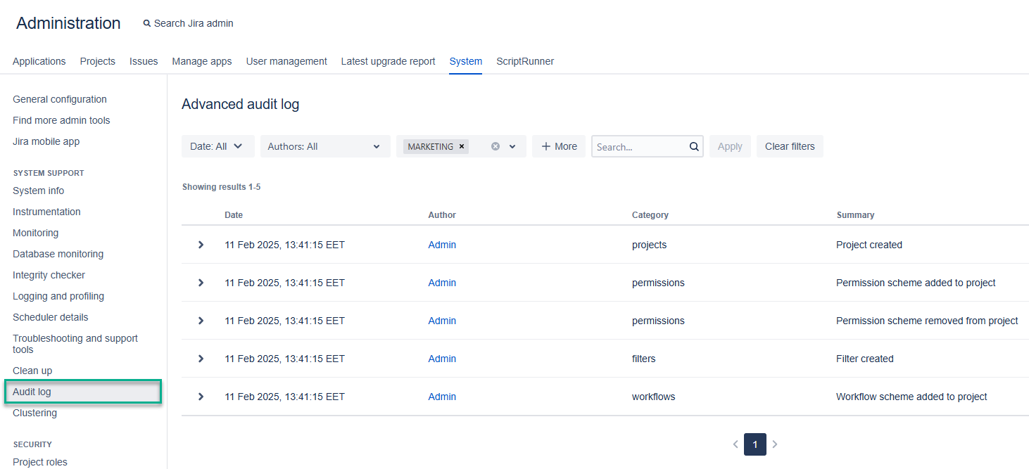

System activities and user actions are documented in Jira Data Center audit logs, which include records of deleted issues. Administrators check audit logs to discover which user removed specific issues and when, to keep track of who is responsible and what happened during recovery work. However, audit logs cannot restore issues that have been deleted from the system.
To access audit logs in Jira Data Center, do the following:
- Go to Administration > System > Audit Log.
- Choose Settings in the top-right corner.
- Set your Coverage level to Advanced or Full to ensure the system tracks issue deletions.
- Examine the audit log to find Issue deleted entries. The log shows which user performed the deletion and when the action occurred.
Note that users can find this feature in Jira Data Center starting from version 8.8.0.

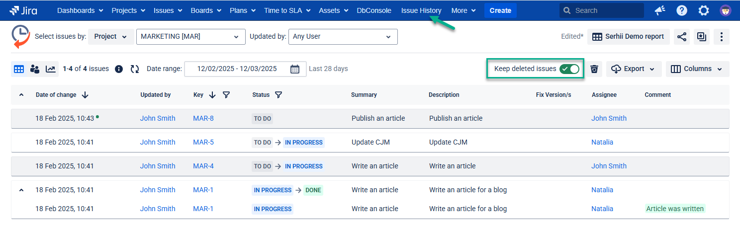

- Enable Deleted Issue Tracking. Navigate to the app's settings. Enable the "Keep Deleted Issues" option (it is necessary). The app maintains a record of every deletion through this activation.

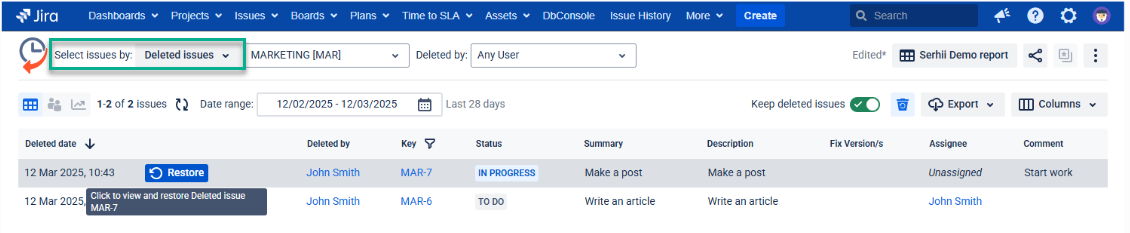

- Then, use Deleted Issues filter. Also, you can choose the required project, date range, etc.

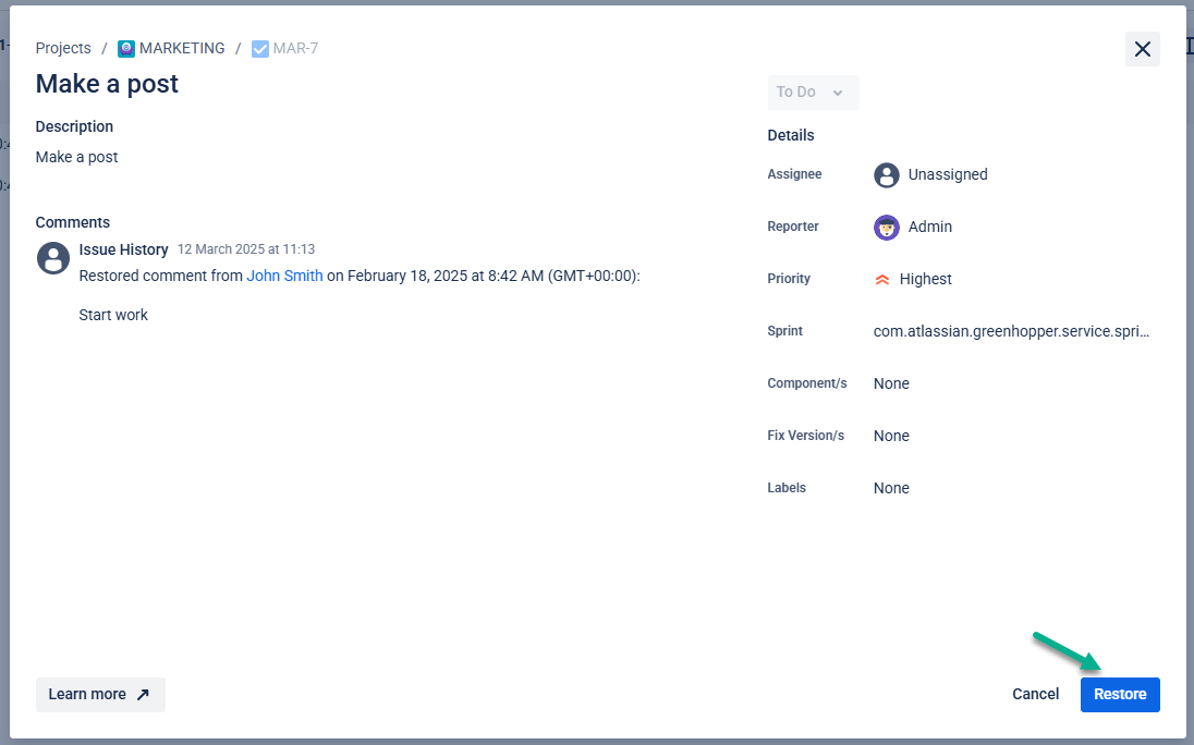

- Restore the Desired Issue. Select the issue you need to recover. Hover over the desired issue, then click the Restore button that appears. The preview window shows details of the issue after you click Restore. Use the Restore button to confirm the recovery process.
You can restore deleted issues in Jira Data Center through the Issue History for Jira app by following this procedure.
