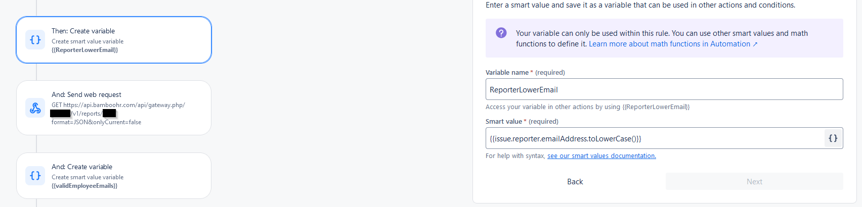

I can't figure out if/how it's possible to put in the value of issue.reporter.emailAddress.toLowerCase() where the "email@domain.com" is in the query.
Either end up with errors about parameter mismatches and needing to close braces and other statements or blank searches.
I also tried creating a separate smart variable to reference it but have the same issue where I can't seem to format it correctly.
Any tips on getting the variable in there?

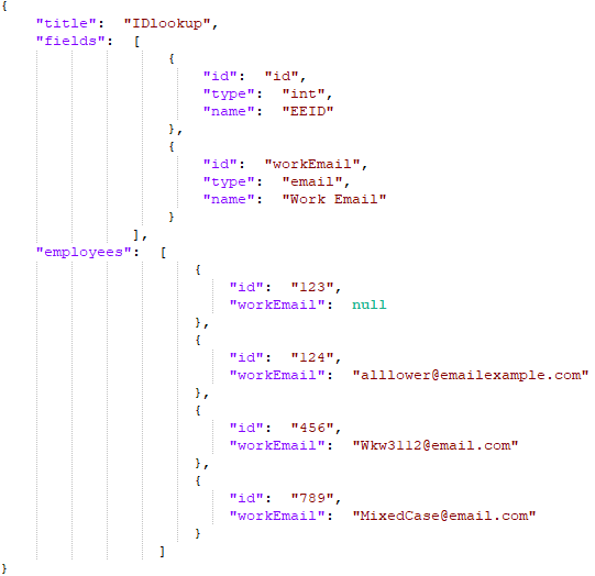

For reference the webresponse I'm trying to get id values out of looks like this:
I have the value of the workEmail property, trying to get the associated id.
