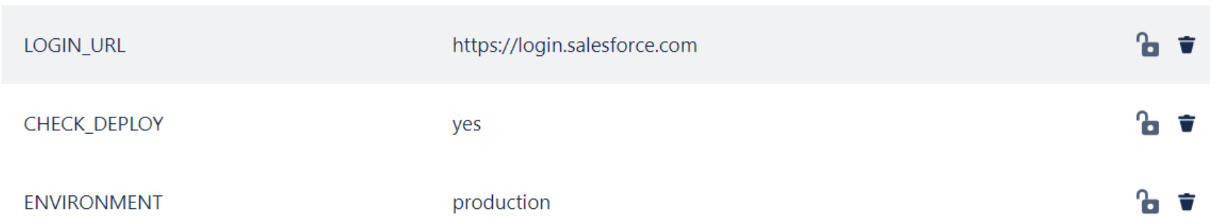

And in bitbucket > repository settings > deployments:
I have added the sandboxes for staging environment and the production environment. For each environment I have set ENVIRONMENT variables:
USERNAME
CONSUMER_KEY
LOGIN_URL
ENVIRONMENT
Like this:

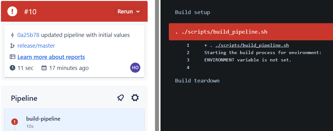

but when I push a commit to test the deployment, the ENVIRONMENT variable returns an error.
ENVIRONMENT variable is not set
I use echo in the script to be able to log the error and $ENVIRONMENT is empty.
set -e
# echo is used to print the message on the console
echo "Starting the build process for environment: $ENVIRONMENT"
if [ -z "$ENVIRONMENT" ]; then
echo "ENVIRONMENT variable is not set."
exit 1
fiCurrently the build fails here when I have clearly created the ENVIRONMENT variable:
