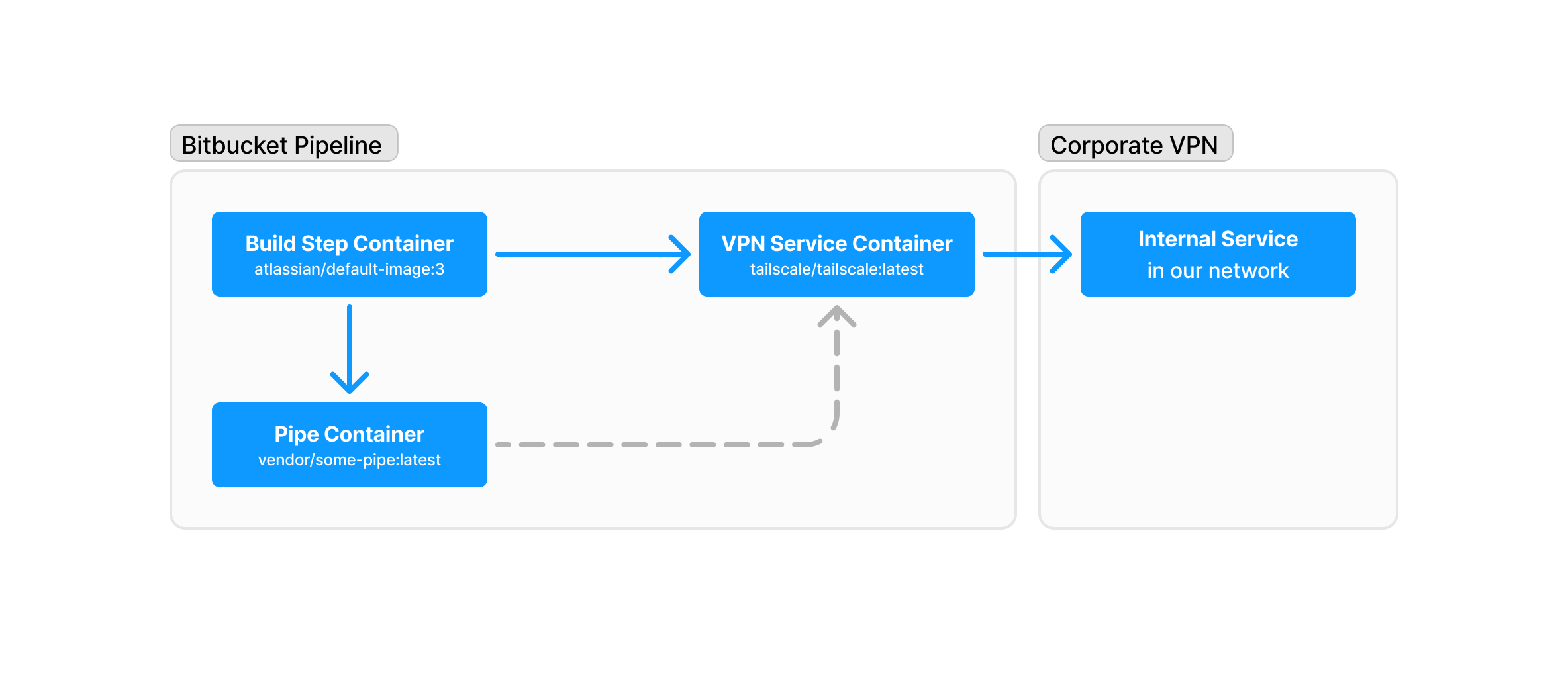

TL;DR: I cannot reach a service container from a custom Pipe. Is this by design, and what can I do about it?

This does not work, however, because the proxy cannot be reached from within the pipe container:

I think this may be related to the way pipe networking is set up, but there is nothing in the documentation mentioning limitations in this regard, neither in "Databases and Service containers", nor in "Use Pipes in Bitbucket Pipelines".
I could include Tailscale in the Dependency Track pipe container, but that would make it way too specialised for everyone else to use, and I think that'd be a sad state of affairs for Pipelines.
