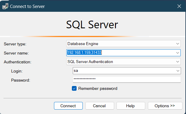

start the application and click on connect then configure as following:
Server name: node IP,31433

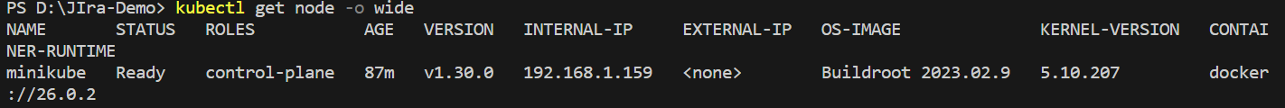

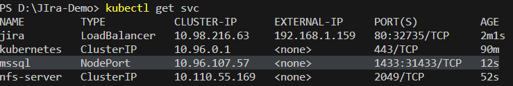

you can get the node IP using this command:
node IP:

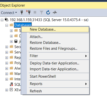

after connecting the database click on database folder and select New Database:

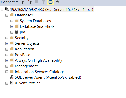

and create new database with the name Jira and the owner is SA
Now the database is ready to go
and can be used in any database configuration.

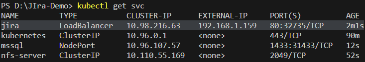

check that the service is created and running

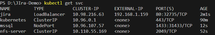

NFS-Server IP
before we start we need to know the nfs-server ip:

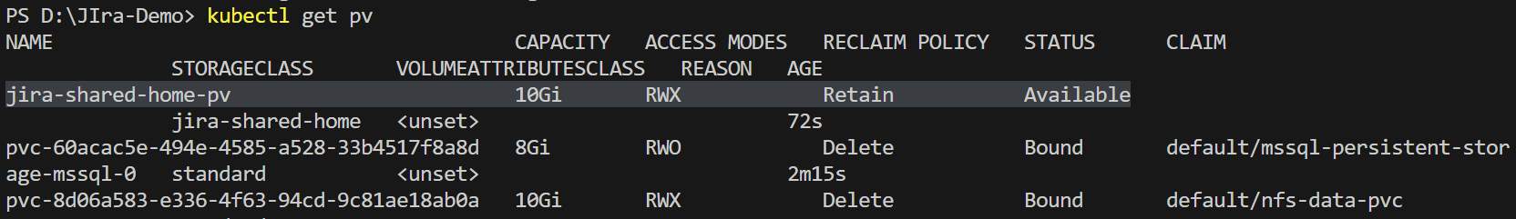

check that the PV created:

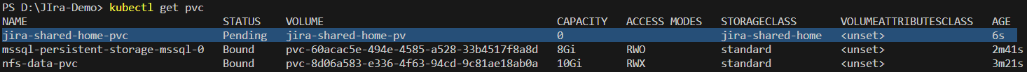

check that the PVC created:
