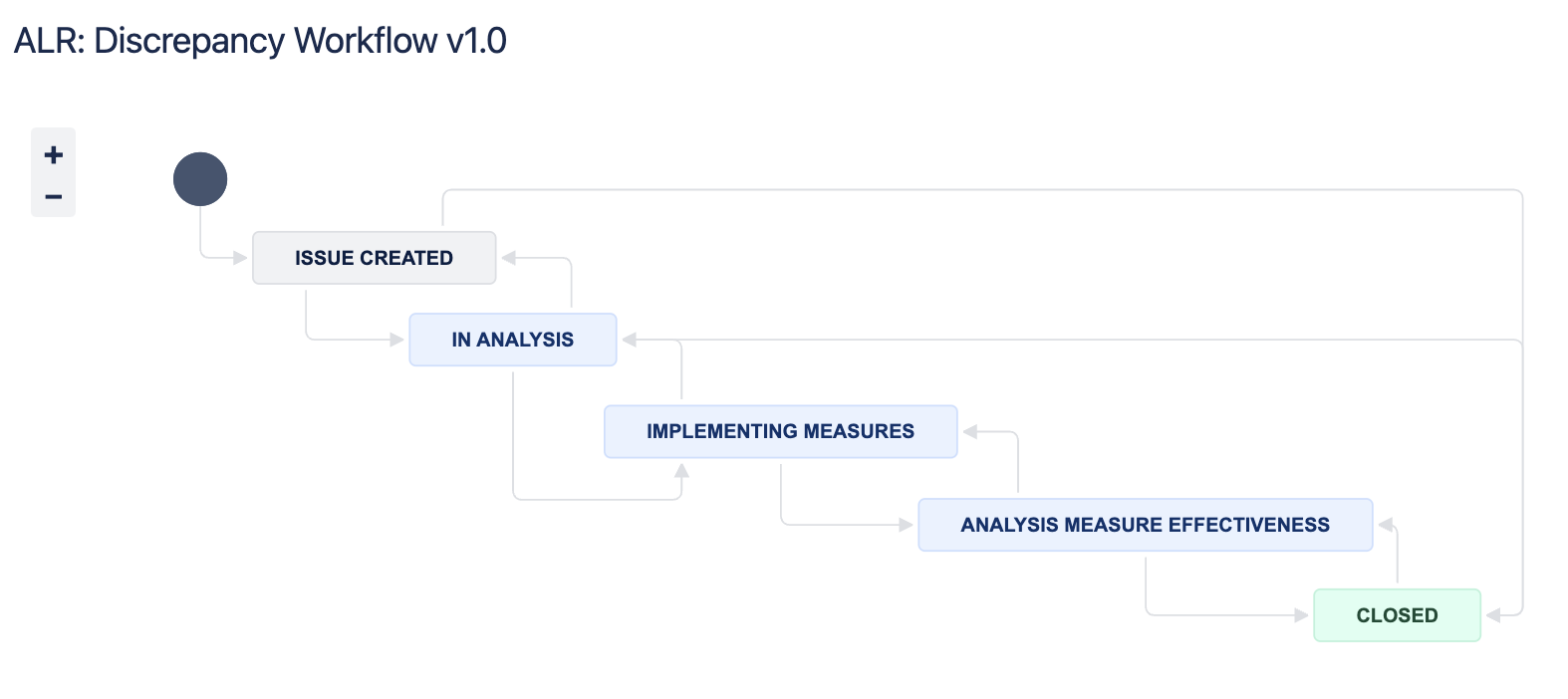

The Workflow for the Discrepancies contain a step to analyse the root cause and create appropriate mitigation subtasks. When all subtasks are done we needed a phase where the assigned user can reflect and measure the effect of the Mitigations before closing the Discrepancy.

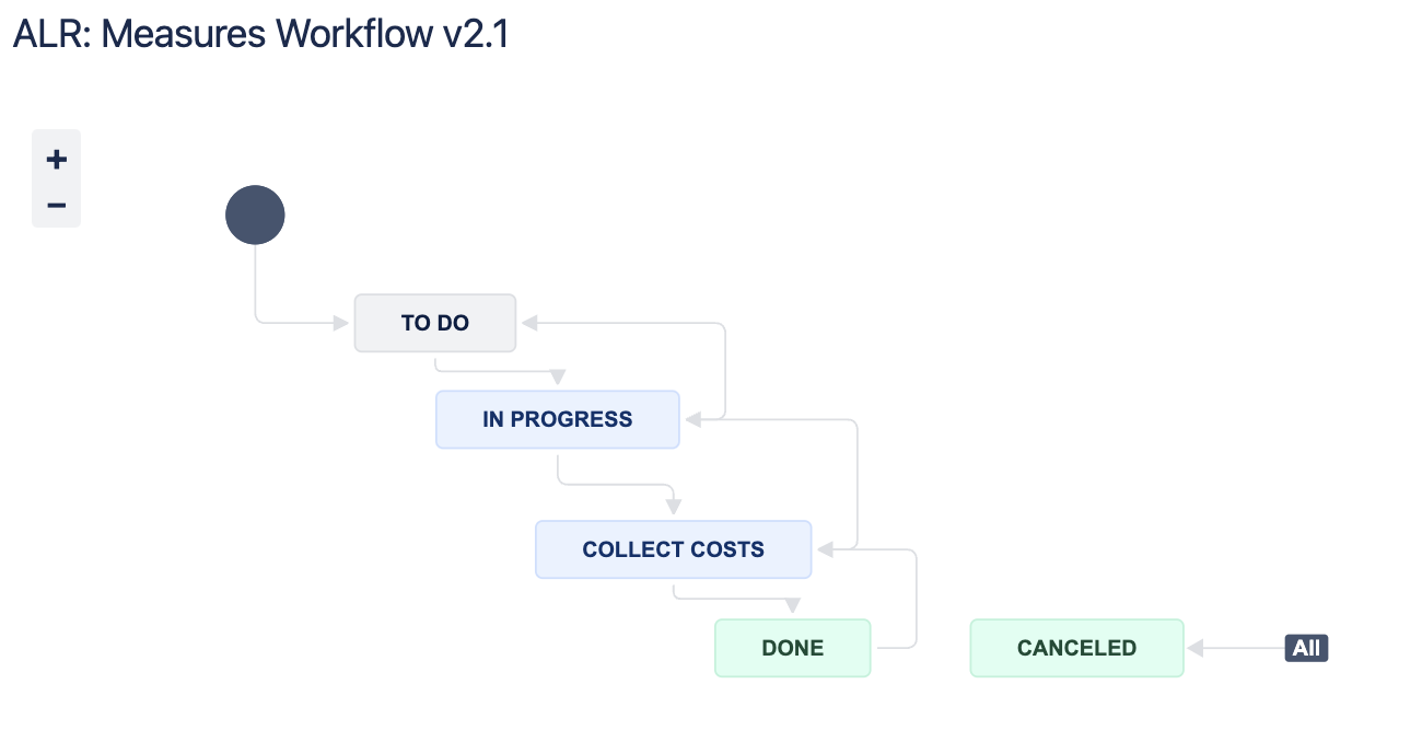

The workflow for the Mitigation (sub task issue type) needed to track the process of implementing a mitigation, collecting the cost of each mitigation before closing it.

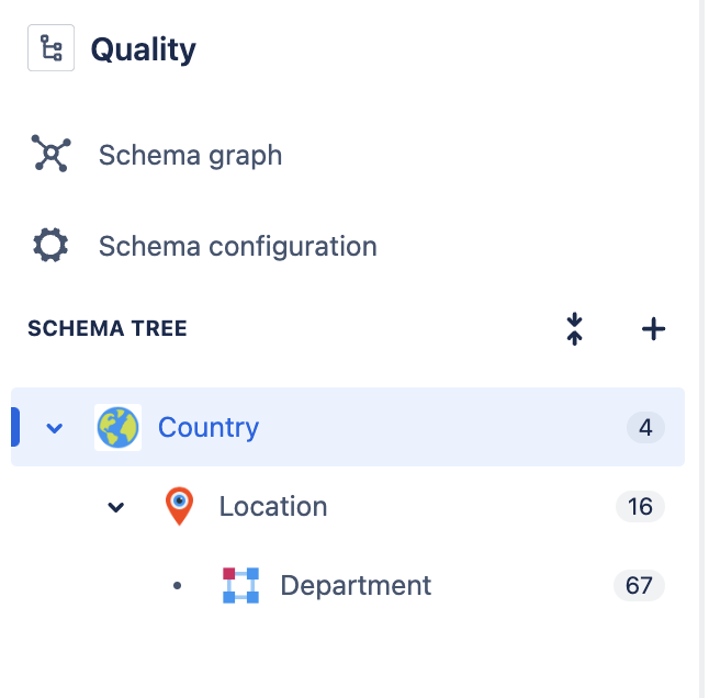

We use Assets to hold important objects to support our issue data. Upon issue creation the reporter choose the department where the discrepancy was happening. As this company has a lot of sites we then want to relate department to a location which is related to a country. This can be coupled with an automation to set these values on the actual Discrepancy issue to allow for slicing reports on any level to benefit the overall analysis.
Another benefit of assets is that we have an jira user attribute on the department object type and an automation to assign an incoming discrepancy based on this relationship. The quality department can then easily maintain and update the asset list both of departments they want to have and the users responsible per department.
