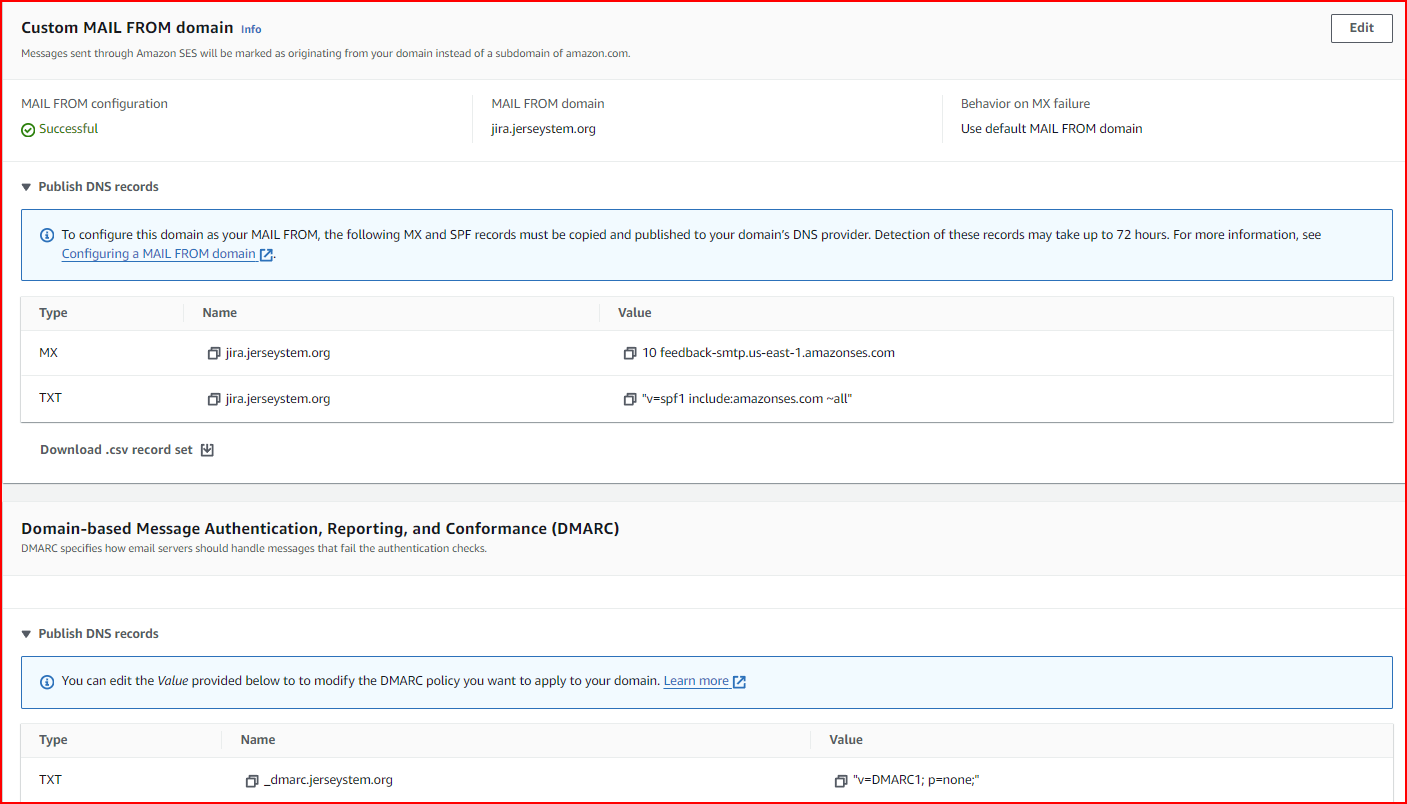

- Find the identify which you are using to send your email message from Jira (ours is jira@jerseystem.org) and click on it.
- Scroll down to the section on "Custom MAIL FROM domain. If you have not configured the MAIL FROM domain. then this section will show "Not started" under the MAIL FROM configuration column and the other two columns - MAIL FROM domain and Behavior on MX failure - will be blank.
- Click the Edit button on the right.
- In the General details display that pops up, click on the box next to "Use a custom MAIL FROM domain". A MAIL FROM domain sub-window appears.
- In the box "Enter a subdomain", enter the subdomain in your email domain that exists (or you will create) and that will get two additional DNS records. For us, since our jira instance has a DNS address of jira.jerseystem.org, the answer was pretty easy - we used "jira" in that box.
- Unless your DNS admin says otherwise, I'd leave the default check option for Behavior on MX failure as "Use default MAIL FROM domain".
- Then same changes.
- Coming back to the Custom MAIL FROM domain, click on Publish DNS records. This will open up a window with the two records to add to the DNS record for your identity you are using (for us, jira@jerseystem.org).
- Click on the "Download .csv record set"
- Pass that information to the DNS administrator
- You should also check the DMARC policy, "_dmarc.<your domain>" (ours is _dmarc.jerseystem.org. Ours is set to "v=DMARC1; p=none;". Download and send that to your DNS administrator.

Here's what our sending Identity page looks like for the affected areas:
At this point, in may take a while for the changes to propagate through the DNS environment. But, maybe a day later you can check on status. Here's what you can do to check:
In AWS SES:
Find the identity you used above. Once the information is properly propagated, you will see what we have above, specifically:
- MAIL FROM configuration column: Successful (with a little checkmark)
- MAIL FROM domain: your entered subdomain in item 8 in the AWS SES configuration above (recall, mine was jira.jerseystem.org)
- Behavior on MX Failure: whatever you selected in item 9 in the AWS SES configuration discussion above.

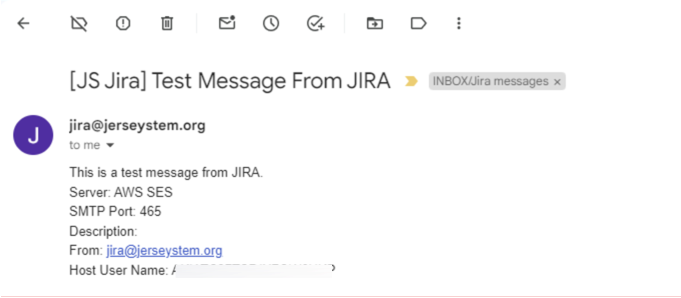

In Jira and your GMail web browser
Use the System admin function Mail | Outgoing mail to send a Test message using the associated SMTP Mail server to yourself. When it appears in your Google Email, check to see if the phrase "via amazonses.com" no longer appears next to the From email address, as in picture below:

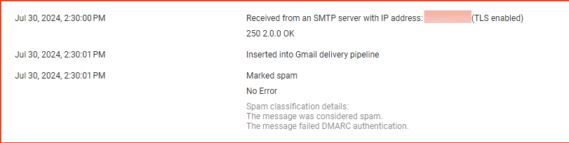

After about 5 days, Filter on sender = <your jira email sender, e.g., mine is jira@jerseystem.org> and use a custom date range of at least 14 days that includes a few days on either side of the date you made the DMARC change.
Then download the results to a csv file. In that file, look for receiving users who have "Marked Spam" as the event status prior to the time when you made the change and then the same user after, but as close as to as possible to, the date the change became effective. You should see "Delivered" as event status instead.
