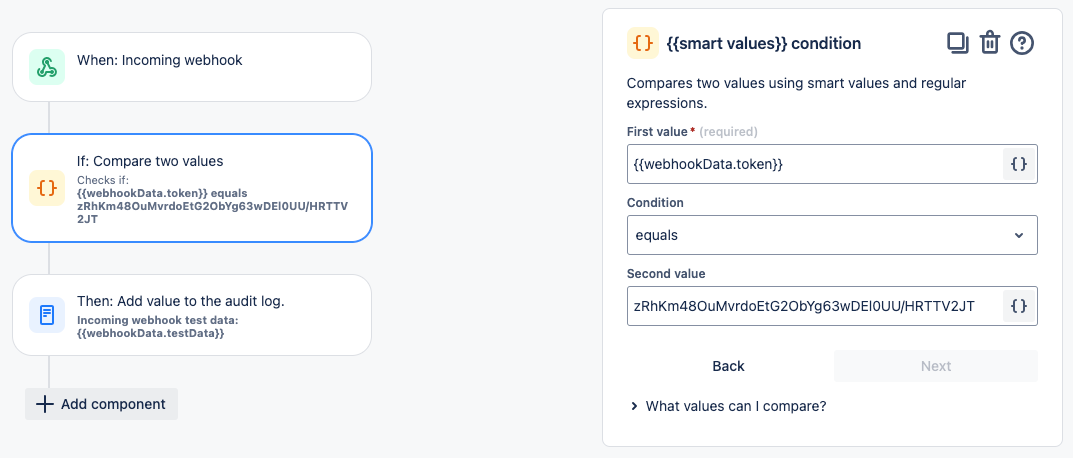

Data sent as part of the request to the incoming webhook can be accessed via the {{webhookData}} smart value. If our token is sent using token as the key, this would be accessed via {{webhookData.token}}.
We can use this smart value to validate that the token is part of the payload that was sent:

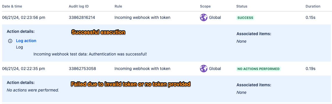

If the token validation is successful, our audit log will display the value of the testData key in the payload, otherwise the audit logs will show that no actions were performed.

The following cURL command can be used to test the payload, substituting the URL for your unique incoming webhook URL that the automation rule will generate:
curl -X POST -H 'Content-type: application/json' \
https://automation.atlassian.com/pro/hooks/509551bb11f2cfd6a4b12ea6644e145eef1 \
--data '{
"token": "zRhKm480uMvrdoEtg20bYg63wDE10UU/HRTTV2JT",
"testData": "Authentication was successful!"
The above should result in a successful execution of the automation rule. I have included an example where the validation failed due to an incorrect token value being provided as well:

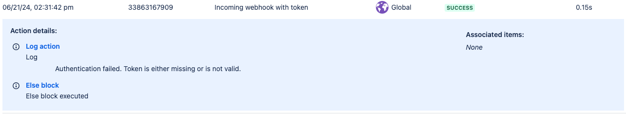

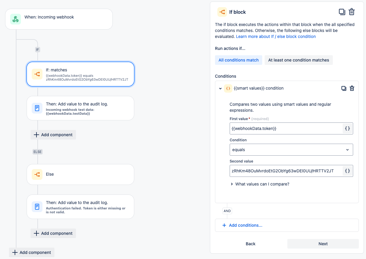

An if/else block could be used with the conditional check to provide a clearer message in the audit logs if the token validation fails whether due to the token missing or being incorrect.
However this will return a successful execution on the automation logs instead of no actions performed, making it harder to flag within the audit logs.
The audit log entry for when the else block is triggered:
