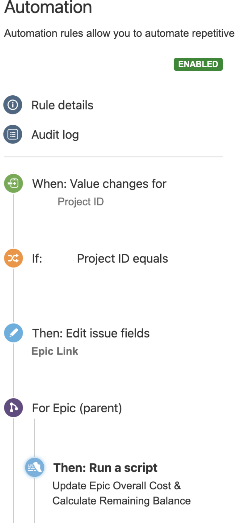

I want to use my Procurement Dept.'s project Epics to track budget information and perform sum and difference calculations for the Overall Cost assigned to the Budget, and Remaining Balance respectively.
I have used some script examples in the Adaptavist library to help me get to this point, and want to make sure I am not missing anything.
The goals are as follows:
- A4J will edit the Epic Link of 'Purchase' issue types based on a custom field selection
- Each 'Purchase' issue has a custom field Cost that will be defined later by the Procurement Agents
- I want to sum each Cost as the Epic Link is edited and set the Epic custom field Overall Cost as each issue is linked
- The Epic should then use a static Budget custom field to calculate the difference between Budget and Overall Cost, and set the value of a final custom field, Remaining Balance
Rule Structure
Below is the script I was able to compile from library examples. Looking for confirmation this will work as expected, and help setting the Remaining Balance field value.
