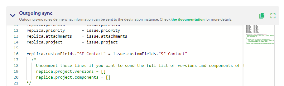

Under the “Rules” tab, enter the following code snippet into the Jira “Outgoing sync” text box.
replica.customFields."SF Contact" = issue.customFields."SF Contact"
Note: The issue.customFields function points to the custom field name within the Jira issue. The replica works as a payload or a message. It contains information you want to pass between the two systems.

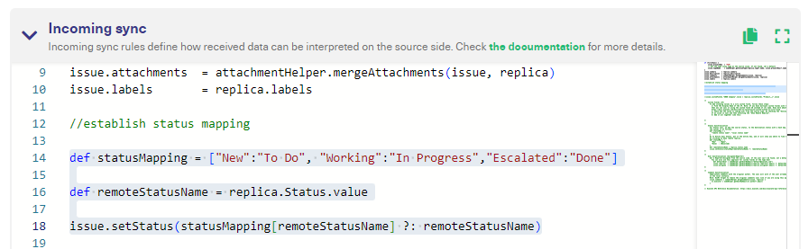

In the Jira “Incoming sync” text box, enter the following snippet:
def statusMapping = ["New":"To Do", "Working":"In Progress","Escalated":"Done"] def remoteStatusName = replica.Status.value issue.setStatus(statusMapping[remoteStatusName] ?: remoteStatusName)
Note: The statusMapping variable establishes the relationship between statuses. The remoteStatusName maps to the replica’s status. Eg., A “New” case on Salesforce appears as “To Do” in Jira.
Once done, click “Publish” to save the changes.

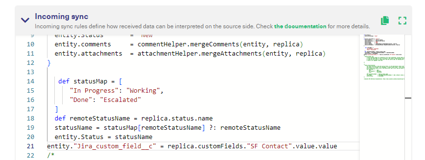

On the Salesforce side, enter the code in the “Incoming sync” text box.
def statusMap = [ "New":"To Do", "In Progress": "Working", "Done": "Escalated" ] def remoteStatusName = replica.status.name statusName = statusMap[remoteStatusName] ?: remoteStatusName entity.Status = statusName
entity."Jira_custom_field__c" = replica.customFields."SF Contact".value.value
Note: The statusMap variable establishes the relationship between statuses. The remoteStatusName maps to the replica’s status name. Eg., An “Escalated” case on Salesforce appears as “Done” in Jira. The entity."Jira_custom_field__c" function points to the custom field “Jira custom field” within Salesforce. The replica contains information you want to pass between the two systems.

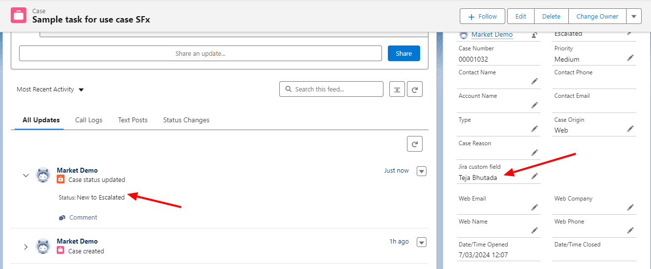

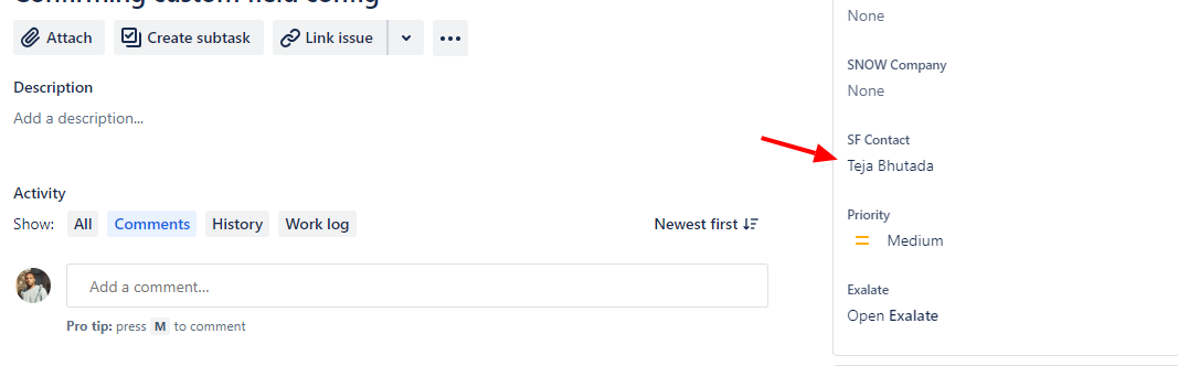

Now go back to the Jira issue and choose a user from the “SF Contact” drop-down list. Then change the status to “Done”.
Back on Salesforce, you will see the account name appear in the “Jira custom field” automatically.
