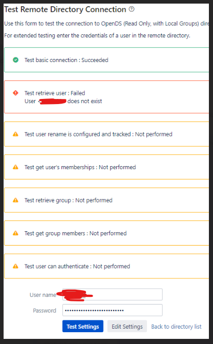

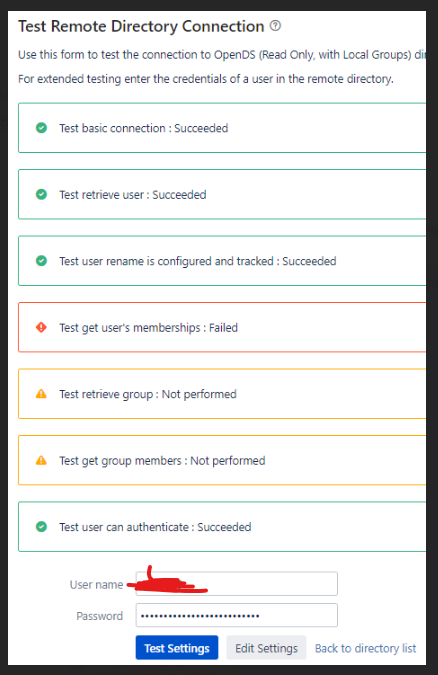

I went and looked at the user directory configuration for the zone that I *know* this user exists on a ran a quick test against my credentials:
And then I ran the same quick test against the newly added user:
No error messages or anything, just flatly telling me that the user doesn't exist in the AD server where I *know* both of our accounts live. What could possibly account for this behavior?
