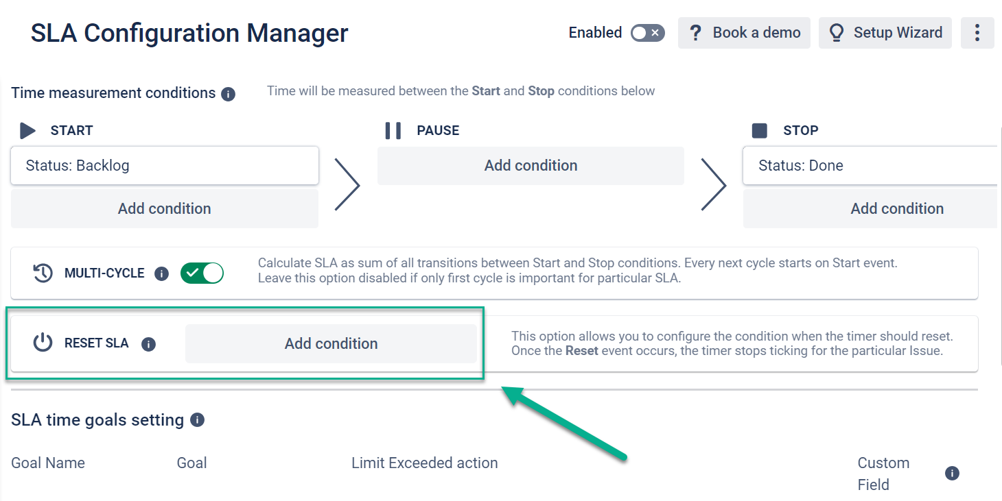

👏 Clap to unlock performance: Reset SLA field in the SLA settings.
This magic feature can be found in the SLA Manager of the SLA Time and Report for Jira add-on. This is a separate field for the SLA Reset condition directly below the Start-Pause-Stop conditions, and this condition only needs to be set. After that, if this condition is met, the goals will be reset to zero, and the score will start over.
That's all. It's that simple.
If you still do not believe, see for yourself! On the Marketplace page, you can learn more about the advantages of the add-on and use the 30-day trial.
