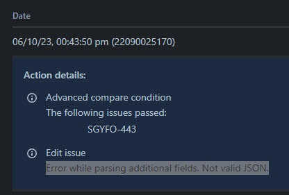

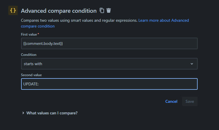

I have setup an automation in which where the comment starts with "UPDATE:" it should populate another field with the comment value.

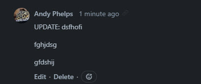

This seems to work when the comment is just one line of text, once it's two lines or includes an @ tag for someone it starts to fall over with.
Error while parsing additional fields. Not valid JSON.
I have tried to just use the "text" version but get the same thing.
Example comment that is failing:
