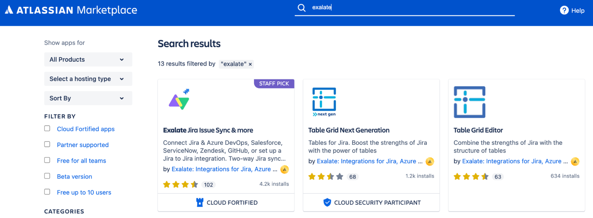

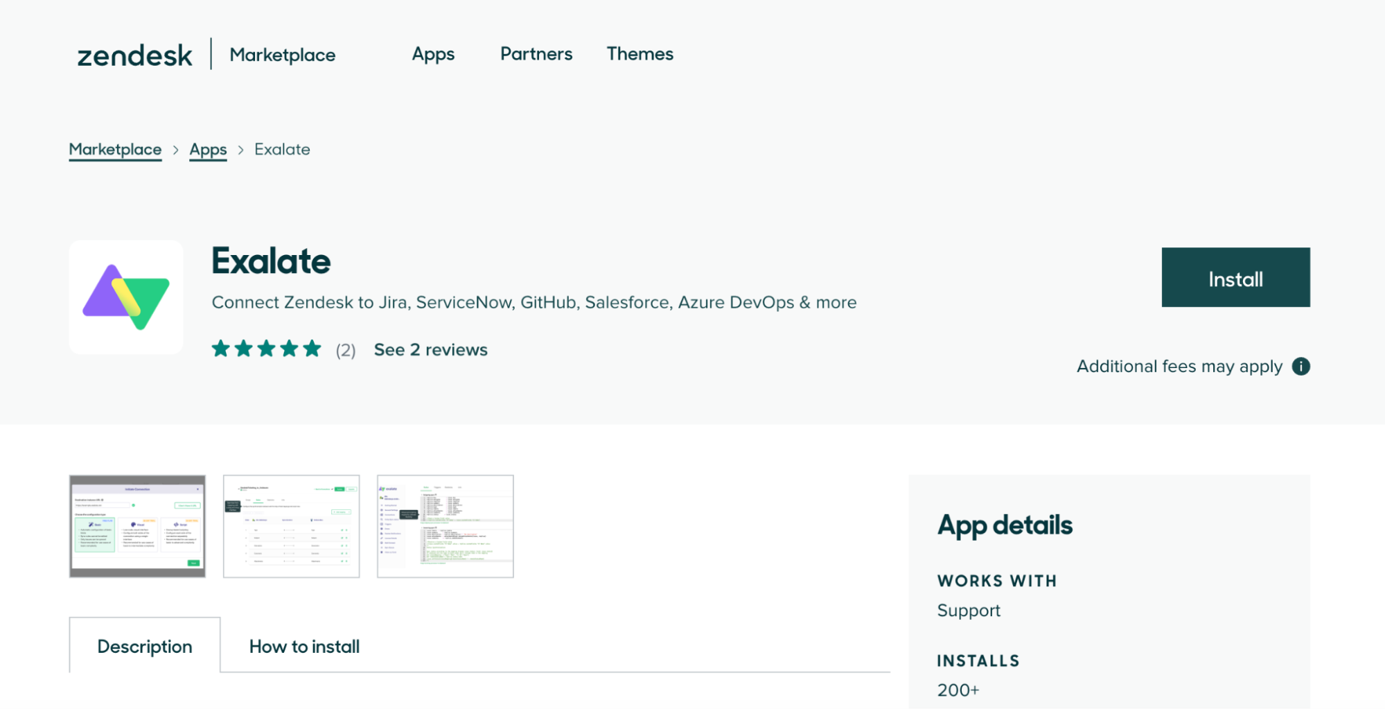

You can install Exalate for Zendesk from the Zendesk marketplace and Exalate for Jira from the Atlassian Marketplace.

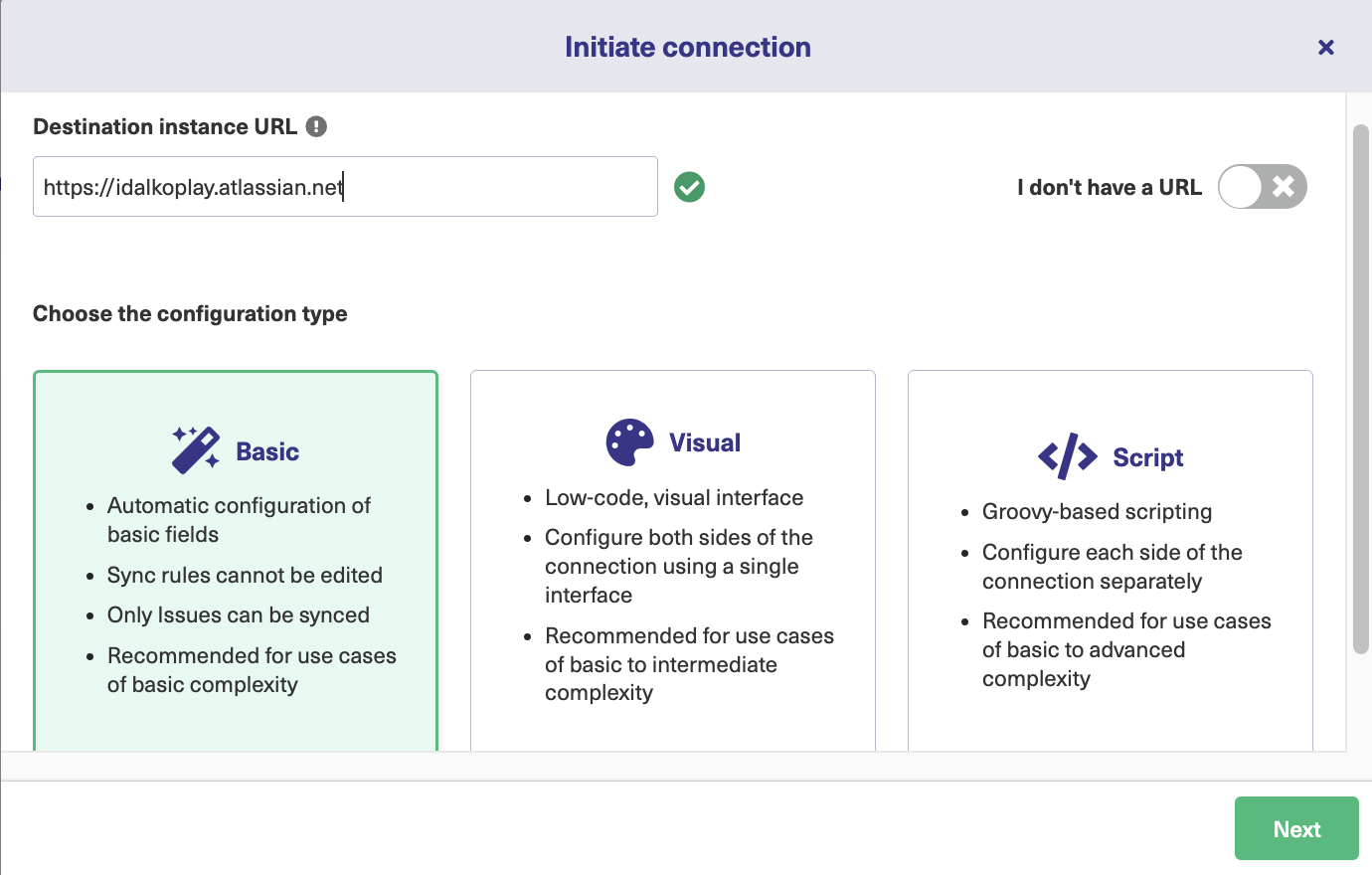

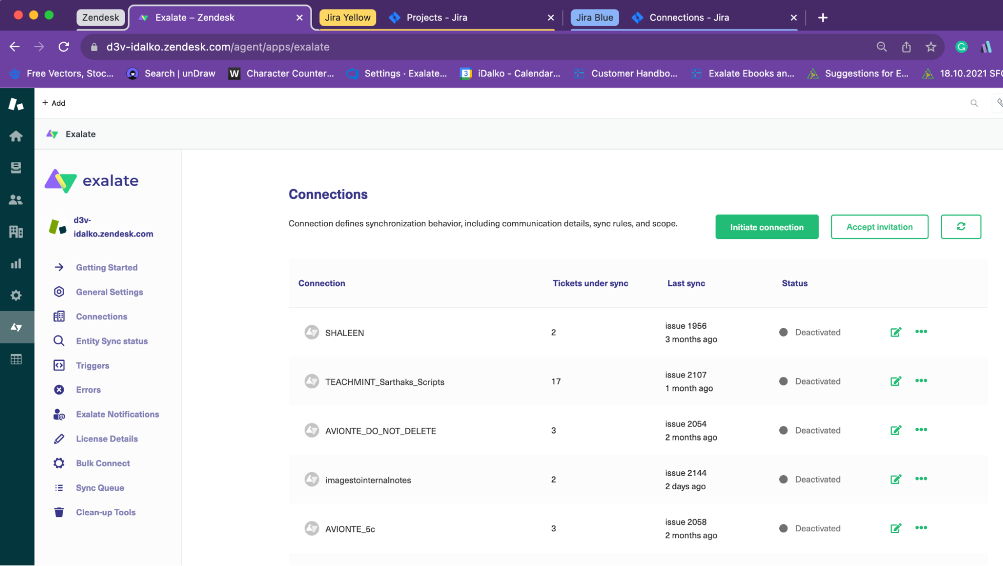

Head to the “Connections” tab in the Zendesk Exalate admin console and click “Initiate connection”.
Enter the destination Jira instance Y URL.
You’ll be prompted to choose between three Exalate modes. The Basic and the Visual Mode are no-code modes, whereas the Script mode is a low-code mode based on Groovy scripts for simple to complex use cases.
Select the “Script mode” and click “Next”.

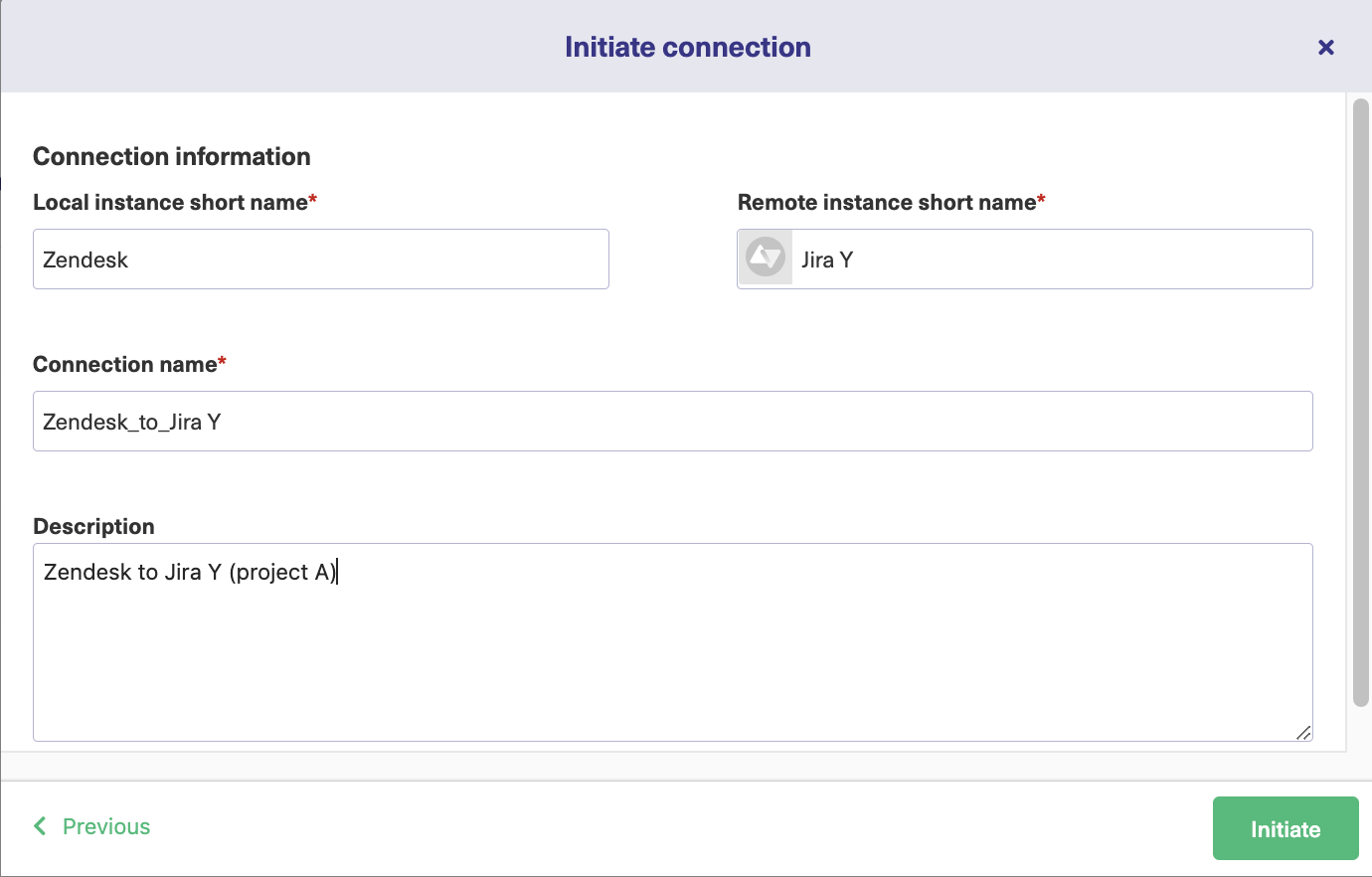

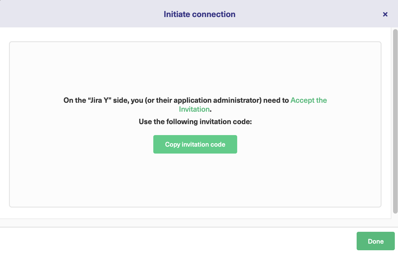

Enter the connection details. We are keeping the connection names as per the list above. In this case, the connection name is Zendesk - Jira Y.

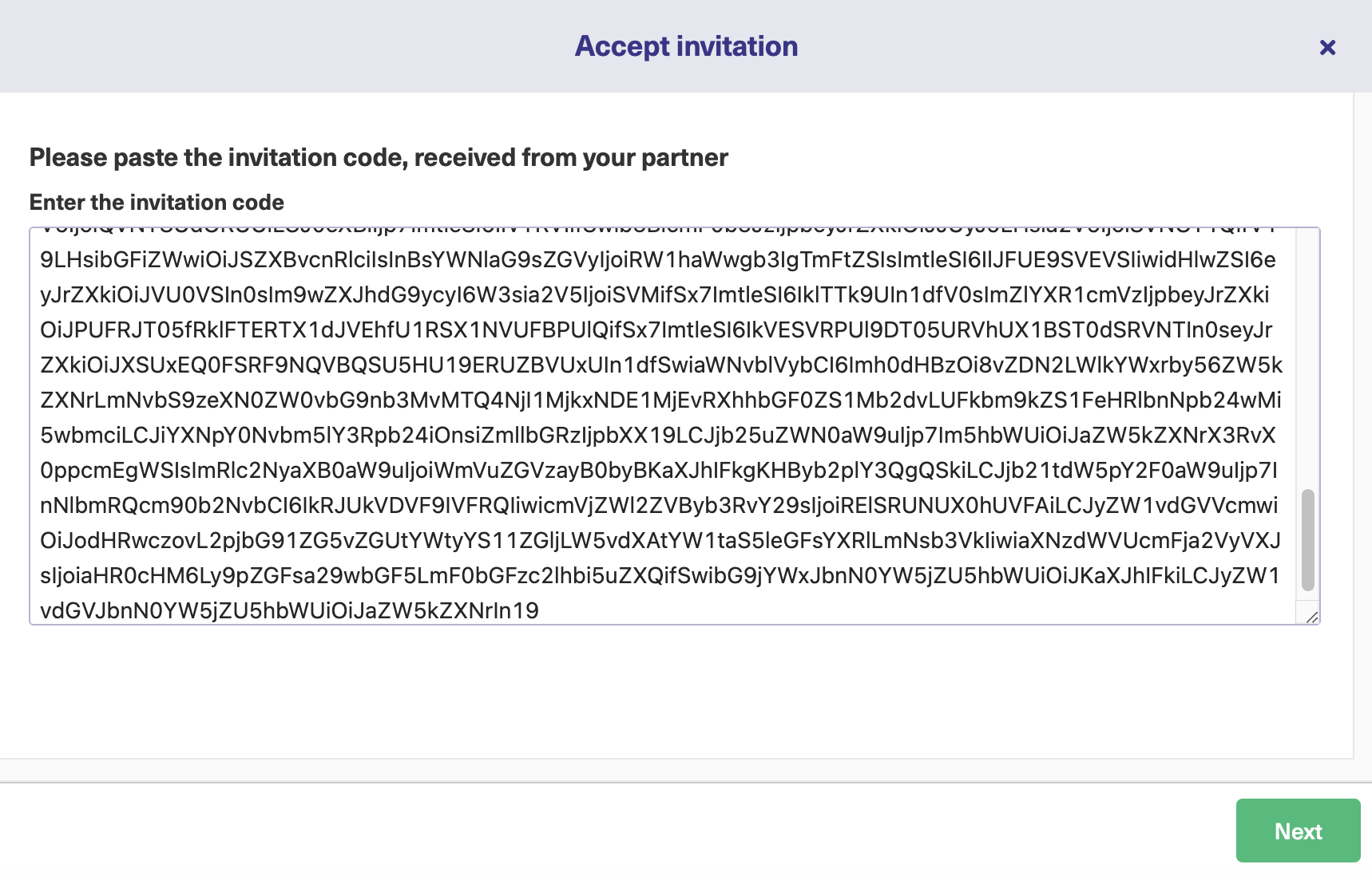

An invitation code is generated. Copy it. Click “Done”.

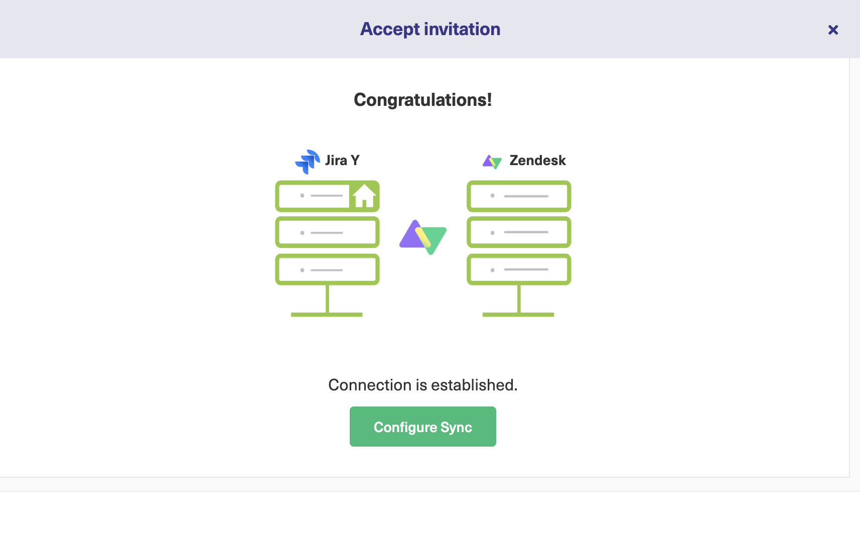

Open the Jira Y instance’s Exalate console, and this time, click “Accept invitation” under the “Connections” tab.
Paste the invitation code in the text box.

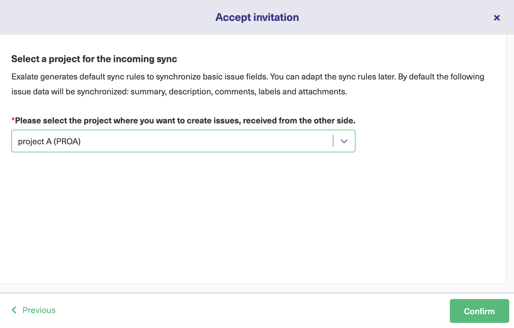

Select project A, the project in which the Zendesk ticket must arrive.
That’s it. You have connected your Zendesk instance to Jira Y (project A).

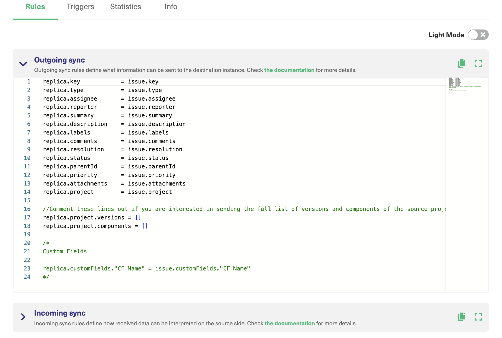

Once all your instances are connected, you can configure the sync under the “Rules” and “Triggers” tab. These tabs appear when you click “Configure sync” after the connection is established or when you edit the connection.
Sync rules govern the information flow. You can specify the fields you want to sync under this tab. You can choose to sync all fields or select only specific ones. You can also choose the direction of the sync.
After making changes to the sync rules, click the “Publish” button to save them.

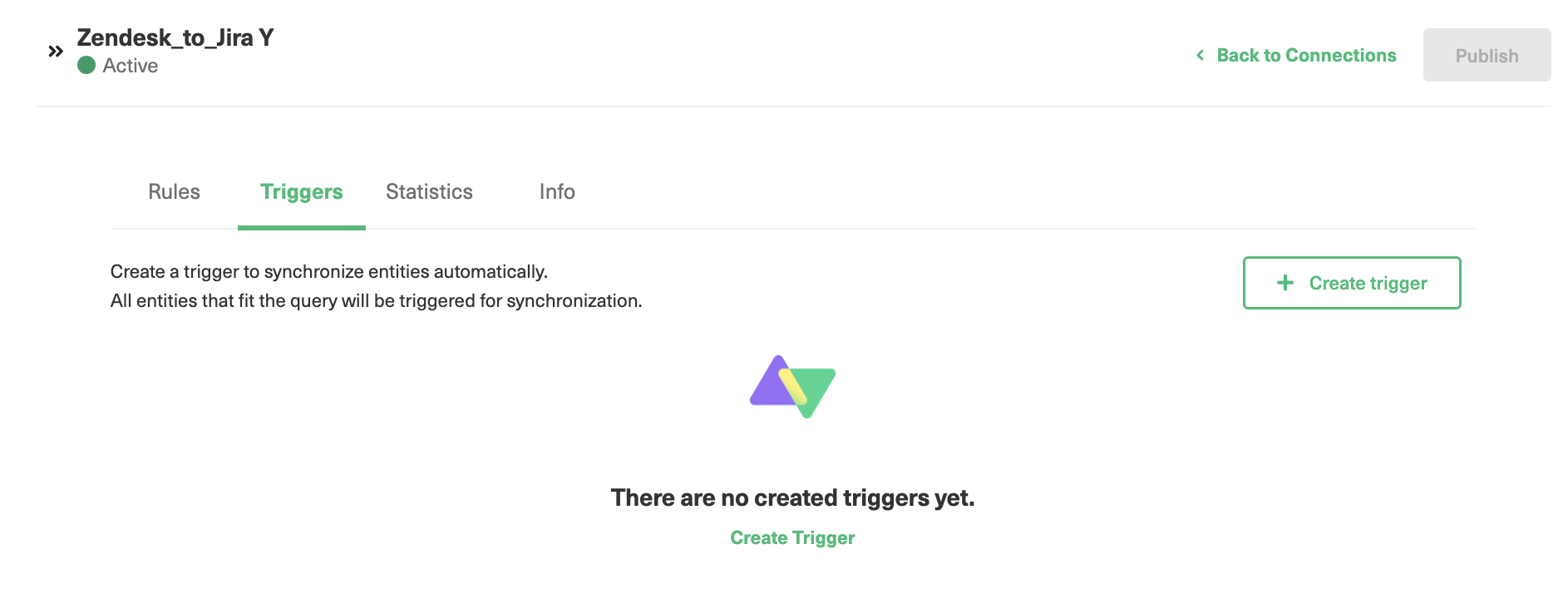

Step 4: Create Triggers for Syncing Zendesk Tickets to Jira
After the initial groundwork, it’s now time to sync a single Zendesk ticket to multiple Jira instances.
You must create “Triggers” in Exalate to implement such conditions of information exchange.
Click the “Triggers” tab. Then, click “+ Create trigger”.

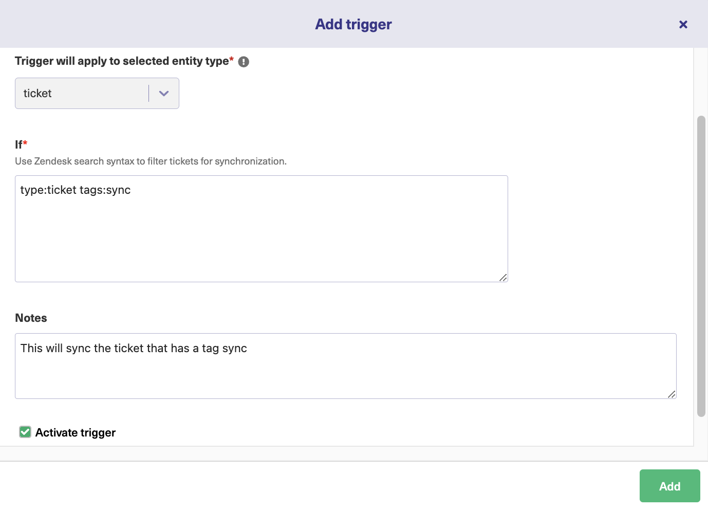

The triggers are created in the platform-native query language. For instance, you need to use Jira Query Language (JQL) for Jira and Zendesk search syntax for Zendesk.
We want the ticket to go from Zendesk to Jira, so click the trigger screen shown below for Zendesk.
Enter the search query. Here, we are syncing the tickets that have been assigned the label = “sync”. You can create all kinds of conditions depending on your requirements. For example, sync an “Open” ticket assigned to a specific user, having a label = “sync”.

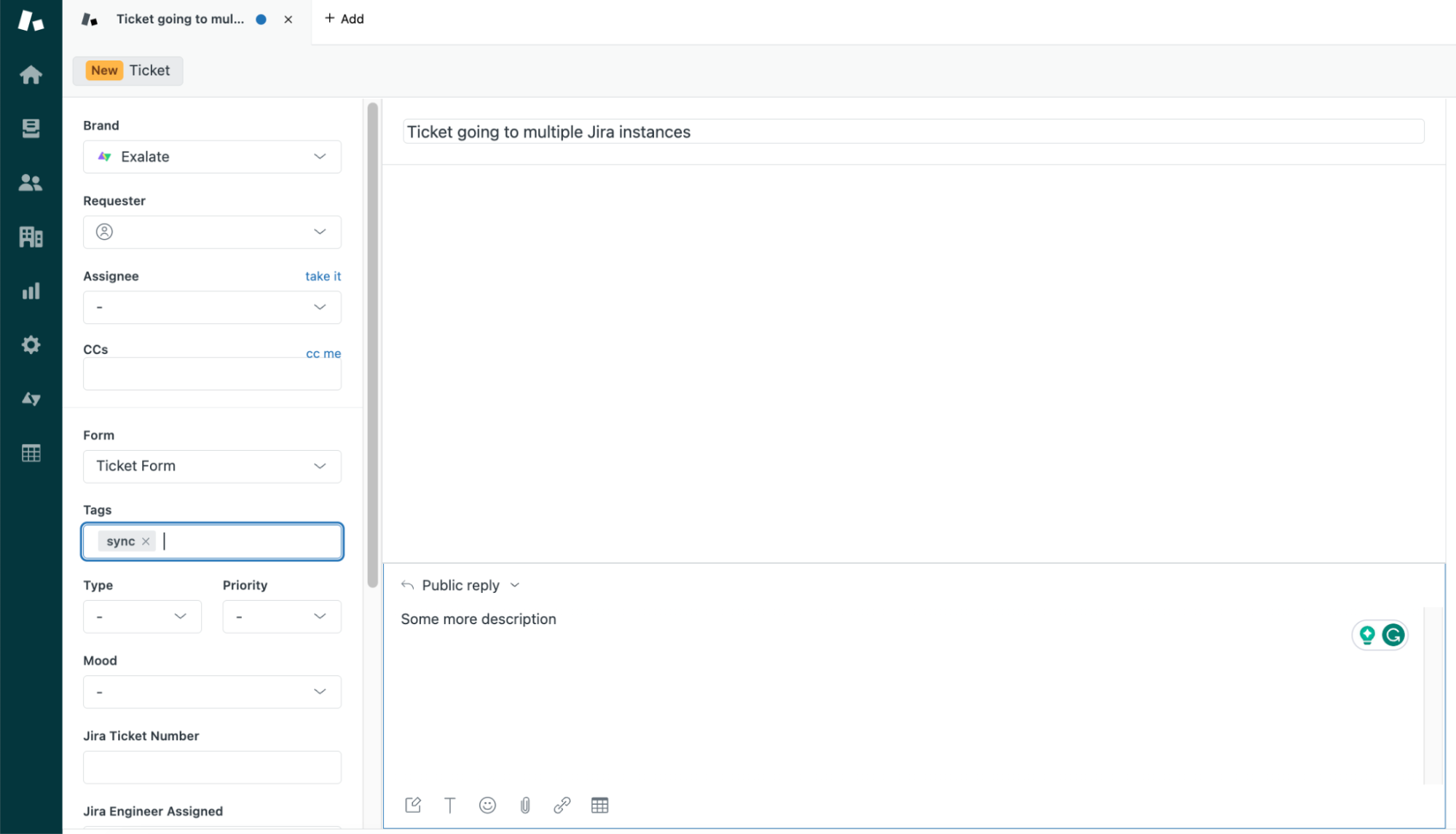

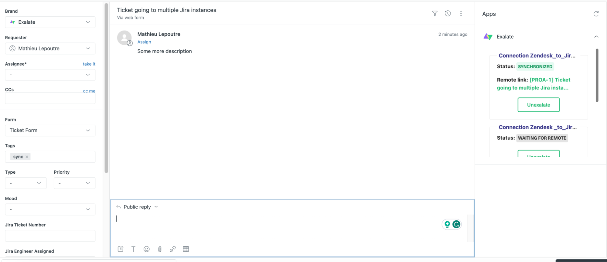

You can create a ticket in Zendesk and assign Tags = sync to it.

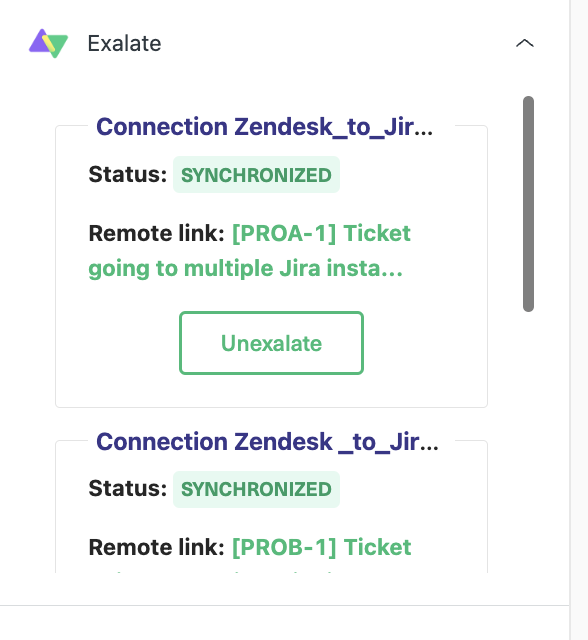

Exalate will pick this up automatically and start syncing the ticket to all the Jira instances. Appropriate status messages will be displayed when the ticket is being transferred to Jira.
You can view the sync status in the Exalate panel present under the ticket view in Zendesk and the issue view in Jira.
