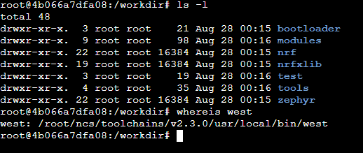

If you run this image locally, you can find something like this:

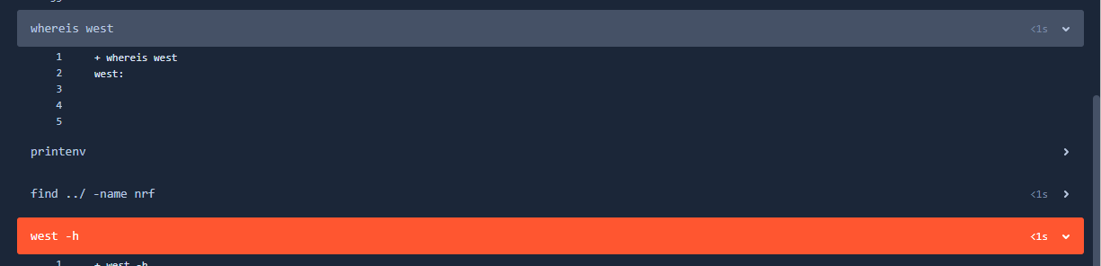

However, when this image is launched using Bitbucket pipeline, you will find other "WORKDIR", you do not find any of that folders described above nor "west" tool installed
I am trying to fix the problem, but I do not know how our image is started, neither what happens with our files and environment variables.
