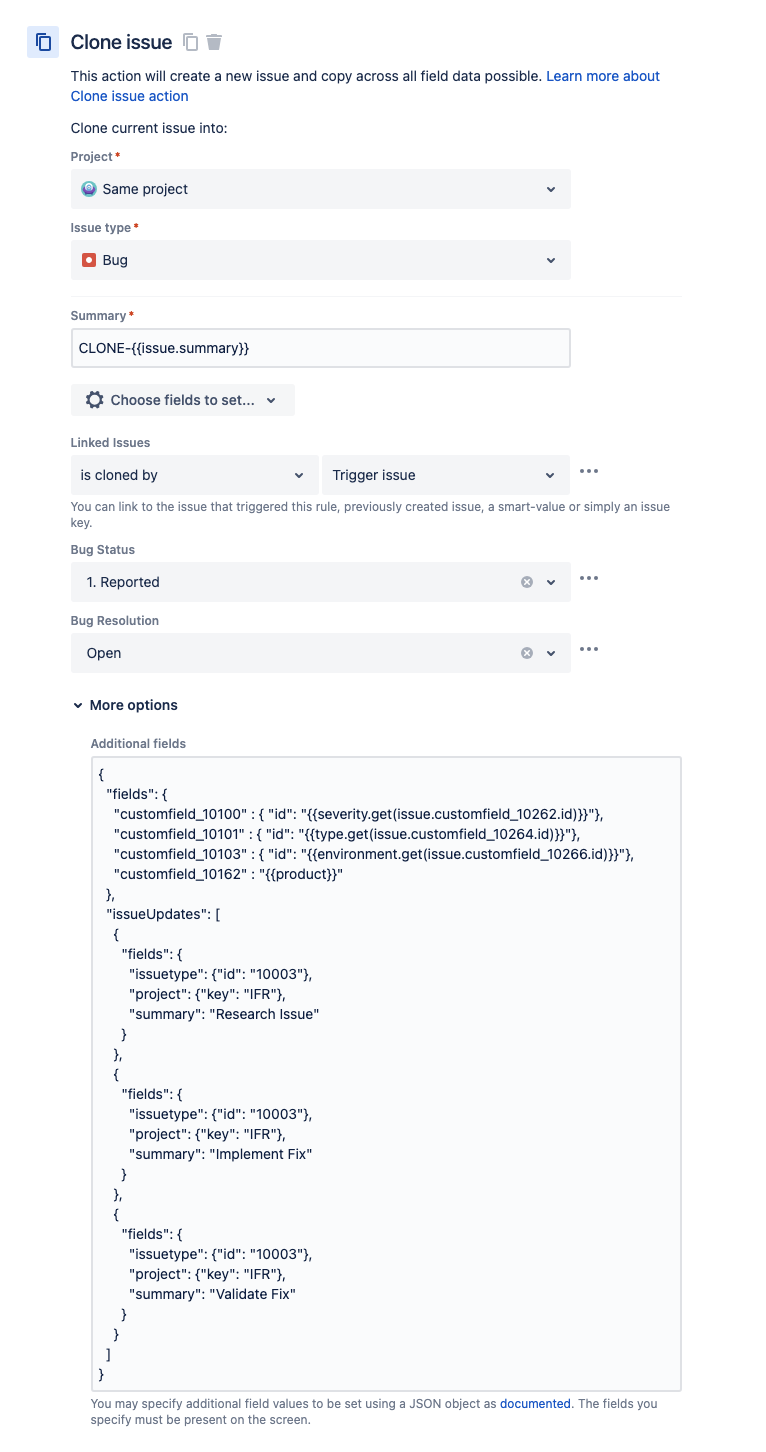

Here is for example the JSON file for the case the bug is created within the same project:
"fields": {
"customfield_10100" : { "id": "{{severity.get(issue.customfield_10262.id)}}"},
"customfield_10101" : { "id": "{{type.get(issue.customfield_10264.id)}}"},
"customfield_10103" : { "id": "{{environment.get(issue.customfield_10266.id)}}"},
"customfield_10162" : "{{product}}"
"issueUpdates": [
"fields": {
"issuetype": {"id": "10003"},
"project": {"key": "IFR"},
"summary": "Research Issue"
"fields": {
"summary": "Implement Fix"
"fields": {
"summary": "Validate Fix"
When I run the rule I don't get any error, the bug is created, with the corresponding values and linked to the defect, but the subtasks are not created. For creating the subtasks I took the idea from the Bulk create issue,
So the portion of the JSON file that is not working is the action: issueUpdates. Instead of using the project id, I am using the project key, but the rest is the same, removing the fields I don't need to set.

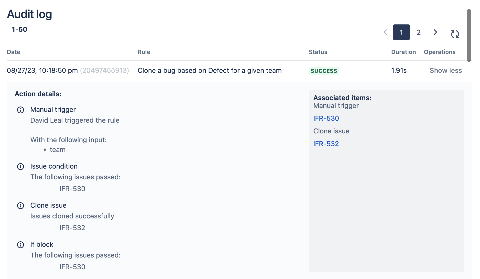

here is the Audit log of the execution:

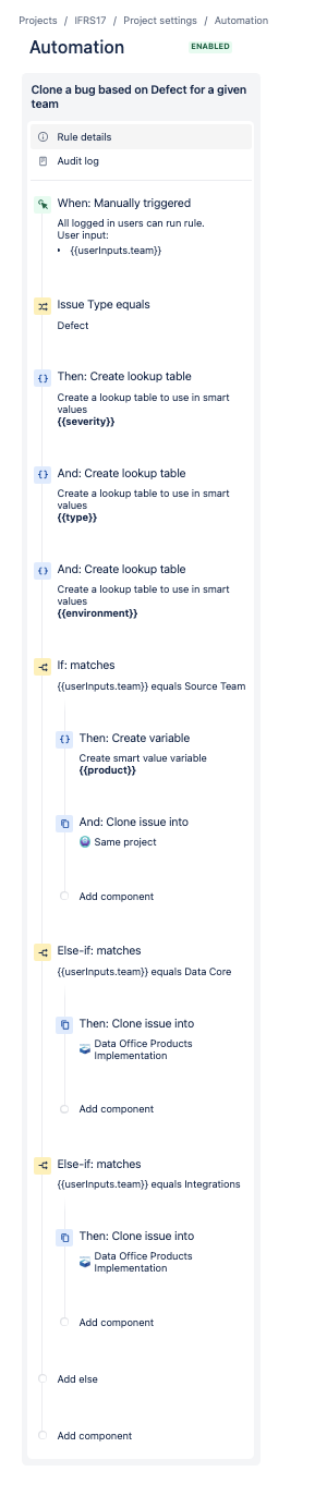

and here is the content of the rule:
Here is the portion of the rule for the case of generating the bug within the same project:

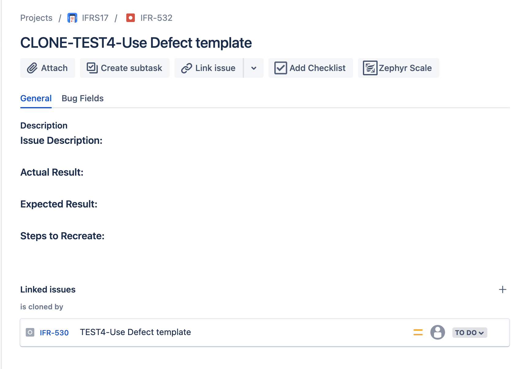

Here is the bug generated:
