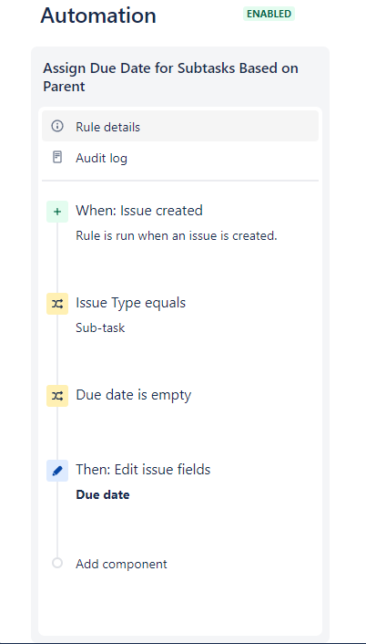

Created a simple Jira automation in a test project. Works perfectly. Applied it to multiple projects via Global Automation and it does not work on any of the selected projects.
Automation
Trigger: When a new issue is created
Condition: issue = subtask
Condition: due date = blank
Then edit issue: Copy due date from parent date

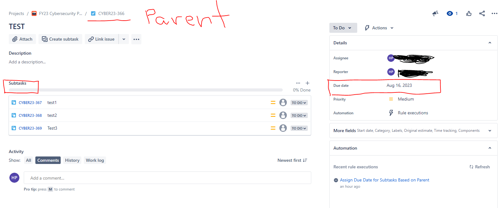

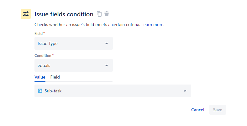

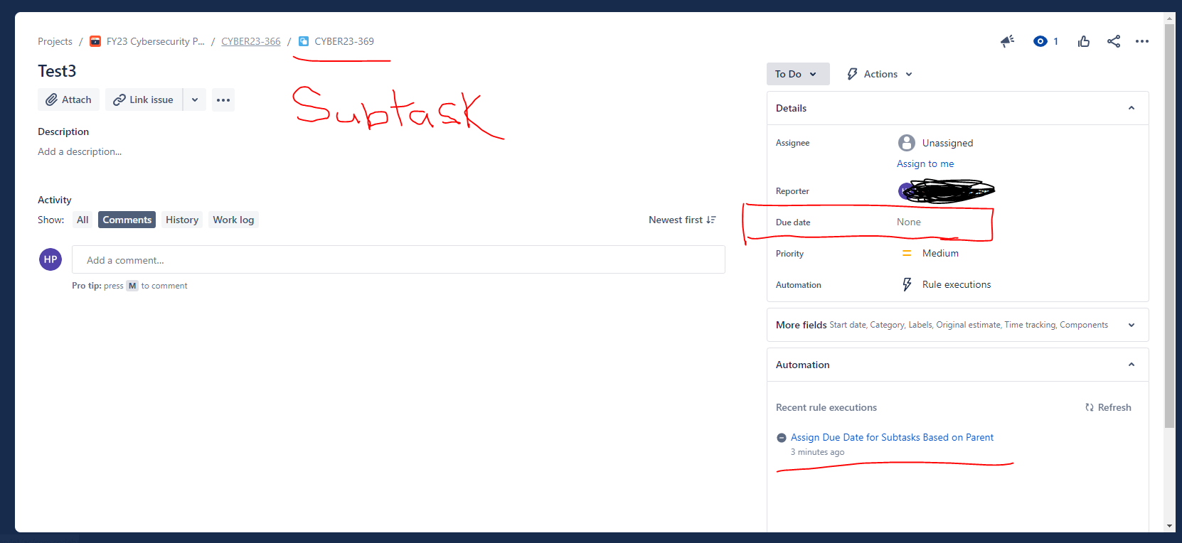

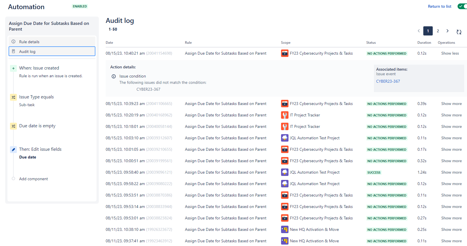

Per the audit log, the rule is executing without failures, but the issue condition of ‘Issue Type equals Sub-task’ is not met. It should be. I am creating a subtask. The parent task has a due date.
Been trying to identify potential differences between my test project where the rule is working, and every other project the automation is applied to. I can’t find anything obvious. They all have the same issue types: task, subtask. I see the rule under project settings and the rule is executing.
Any idea how to troubleshoot?
