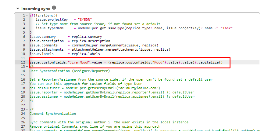

On the Jira side, enter the following code into the “Incoming Sync” text area:
issue.customFields."Jira Mood".value = (replica.customFields."Mood"?.value?.value)?.capitalize()
Note: This line of code receives the value from the Zendesk custom field. The .capitalize() method converts the first letter of the received value into uppercase.

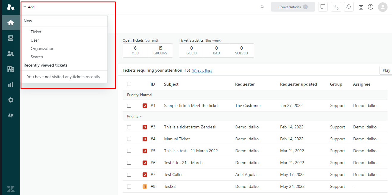

Go to the Zendesk dashboard and click “Add Item” to start. Select “Ticket” from the dropdown menu.
Enter a subject and description. You can also change the brand, requester, assignee, tags, and form. Then click “Submit as New” to save the ticket.

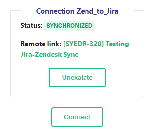

Once the sync is complete, the status will change to “Synchronized”. You will then see a Remote Link leading to the Jira side. Click on the remote link.
On the Jira issue, you will see that the label has changed and the mood has been updated.

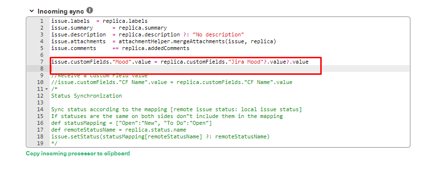

Then go back to the Zendesk side and change the config for the Incoming sync.
issue.customFields."Mood".value = replica.customFields."Jira Mood"?.value?.value
Note: This line of code returns the (already capitalized) value from the Jira side using a slightly different syntax.
