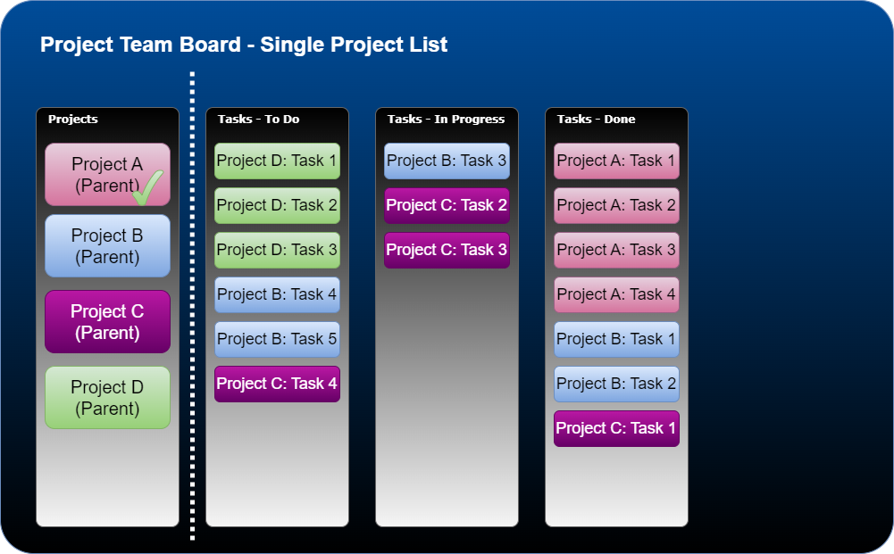

Option 1 - Single Project List and Tasks workflow
In this option, you keep your projects in a list on the left then have your task workflow on the right, with an imaginary line between them:
You can use labels, due dates and stickers to set the status of the projects based on the status of the tasks

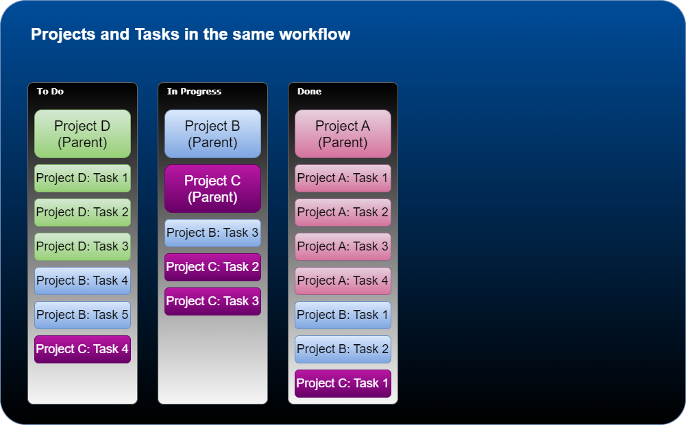

Option 3 - Merged workflow
As with tasks, a project/story/deliverable has the same states of not done, in progress and done. You let them flow through the same workflow together. You could use labels and filters to display only projects or only tasks.

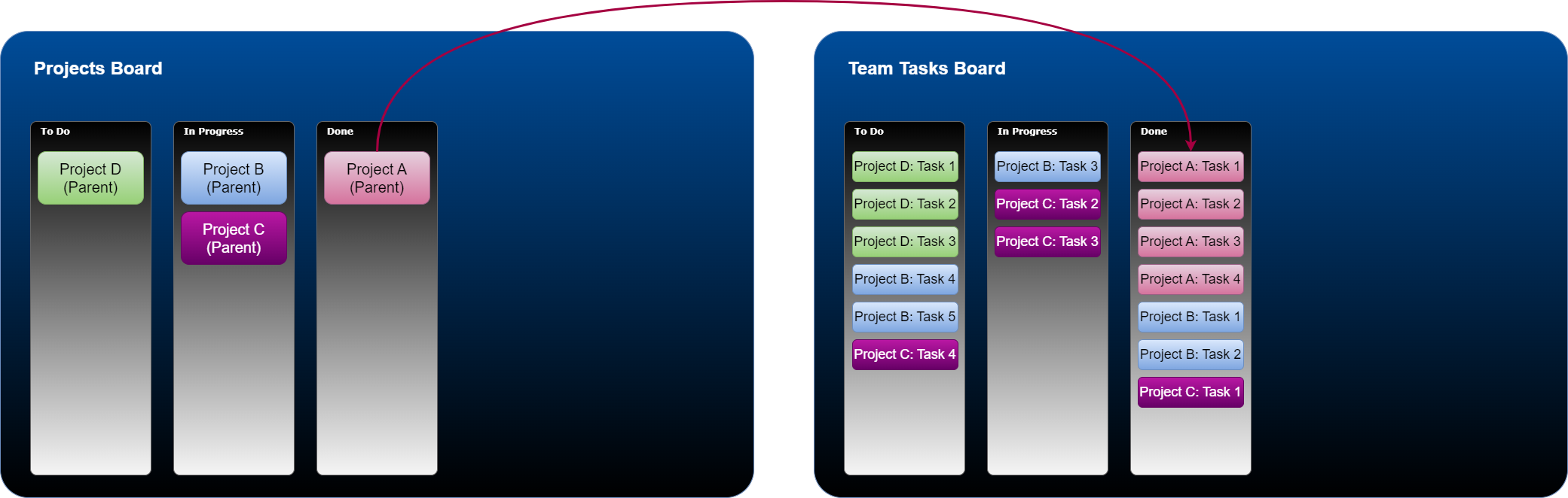

Option 4 - Dual Board
This option is particularly useful if the workflow context is too different between the parent and child that they need different boards. This allows you to use different custom fields and labels and it also means that the board context is focus around the needs of the particular team.

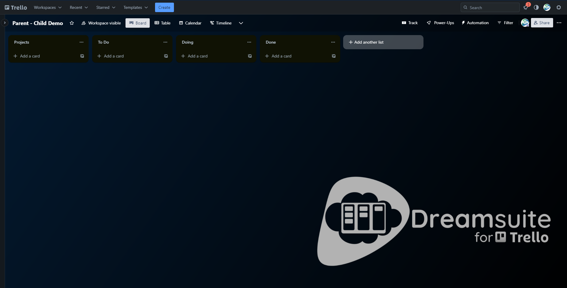

I am going to keep it simple and use the structure from Example 1
- Set up your Trello Board
Create a Trello Board with the lists as show below:
- Create a temporary card anywhere on the board to add a custom text field called "Project"

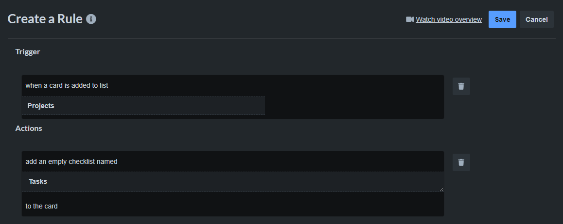

- Automation that adds an empty list called Tasks to a card added to list Projects

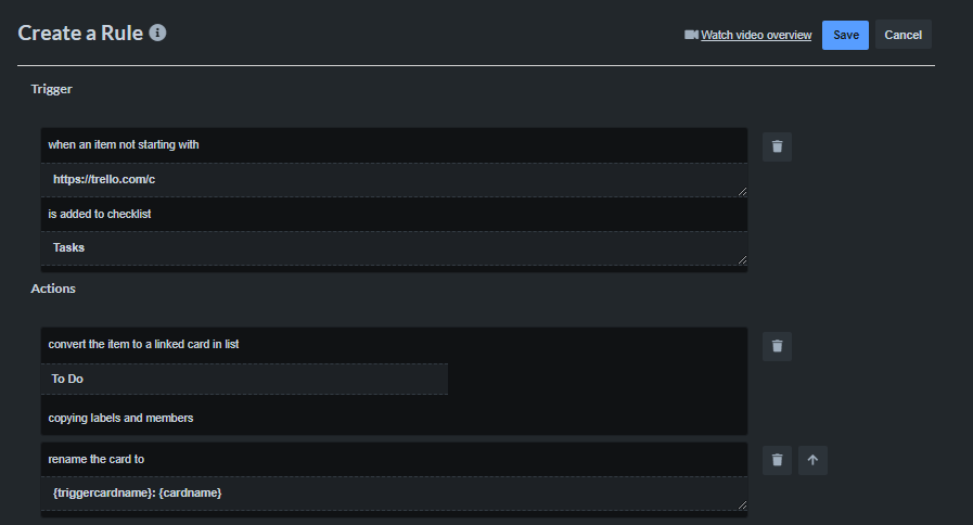

- Automation to convert a checklist item into a linked card and rename it with a prefix of the parent card name (this is for filtering)
Note: the "does not start with https://trello.com/c" is to allow the next automation to work correctly without causing a loop

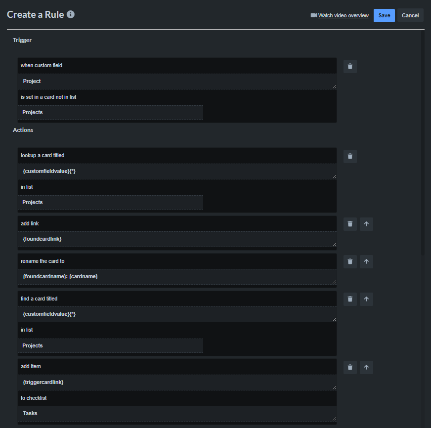

- Now, you may want to link the cards at a later stage, this is where the Project custom field comes in. Automation to link the task to a project when the Project custom field is set

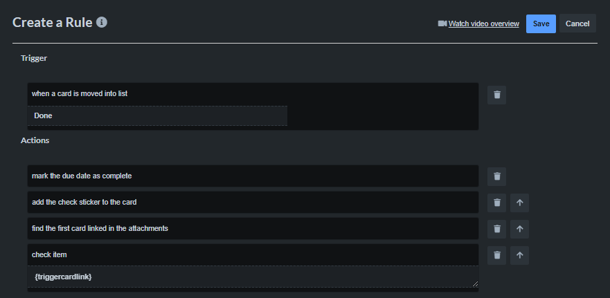

- When a child card is moved to done, you want to check that item off on the tasks checklist of the parent card

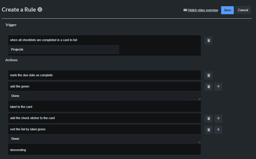

- When all the Tasks are complete, this automation will mark the project as complete

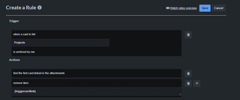

- Finally, you as the owner of the board may want to be able to remove tasks. These 2 automations allow you to remove the child card by archiving it or by removing it from the Tasks checklist of the parent

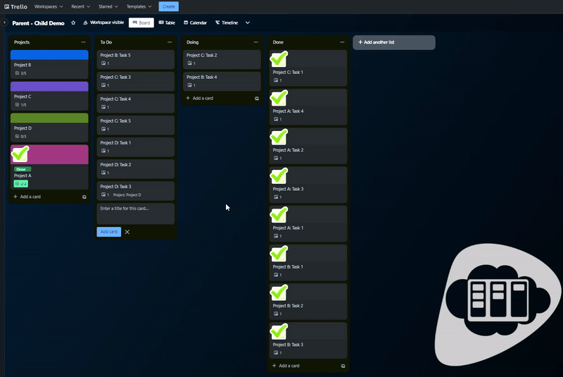

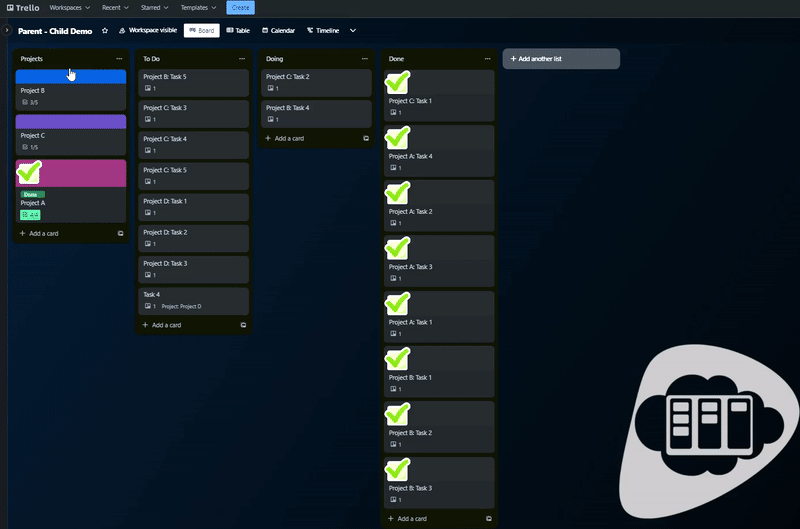

- Start Adding your tasks
- Need to link a new task to an existing project? Use the Project custom field you created to enter the project name...

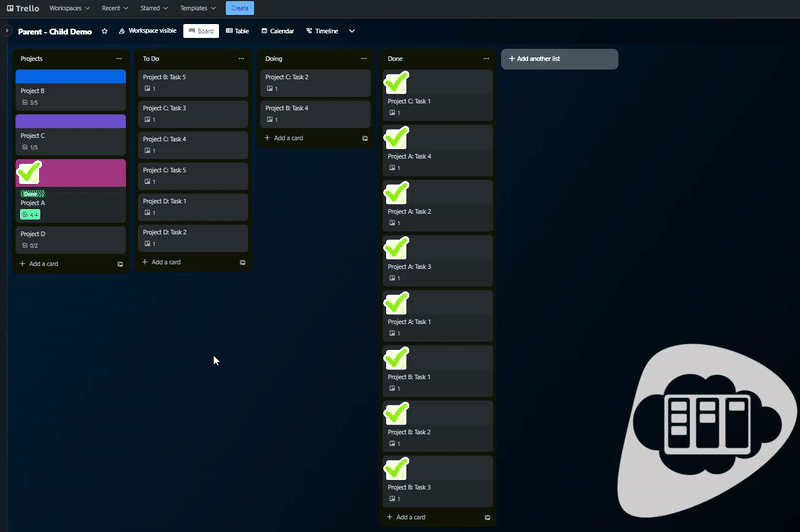

- Need to delete a task? Here are both ways in action...

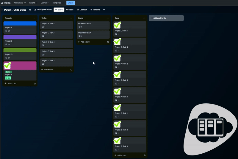

- Lets test the tasks going through their workflow and updating the parent card...

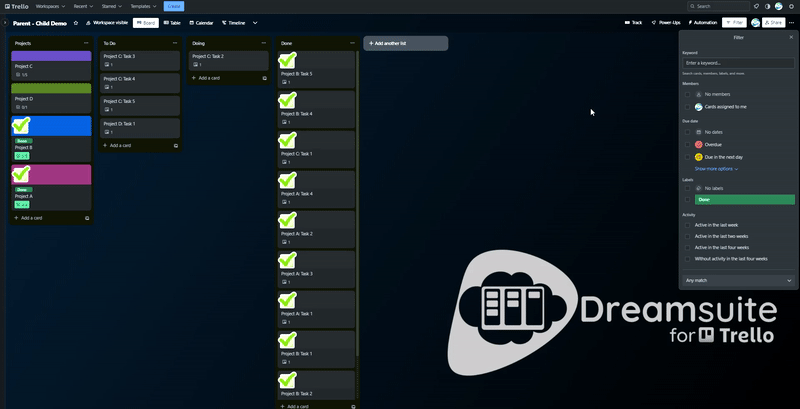

- Lets check out how easy it is to filter in this system
