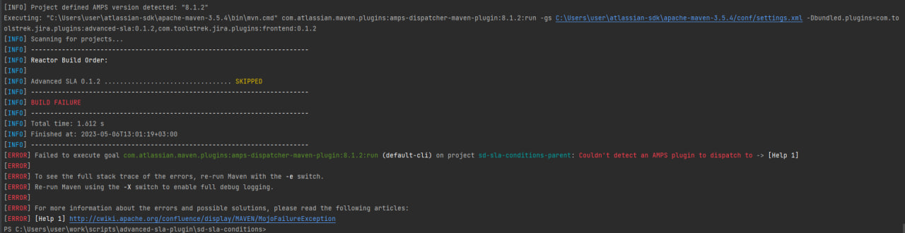

I trying to deploy a plugin. It consists of 2 modules. Frontend and advanced-sla. I run it from the main directory via atlas-run. I get the following error:
[ERROR] Failed to execute goal com.atlassian.maven.plugins:amps-dispatcher-maven-plugin:8.1.2:run (default-cli) on project sd-sla-conditions-parent: Cou
ldn't detect an AMPS plugin to dispatch to -> [Help 1]

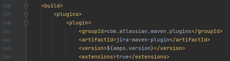

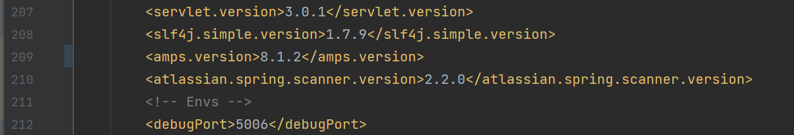

In my advanced-sla-pom.xml I define AMPS version 8.1.2:

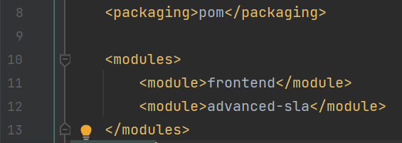

In main pom.xml I define 2 modules:
In the screenshot with the error you can see that the modules bind and in the first line is defined AMPS version 8.1.2.

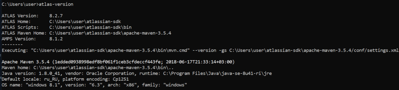

Below are my settings Atlassian SDK:
Also I checked the work on HelloWorld Plugin and it run successfully.
