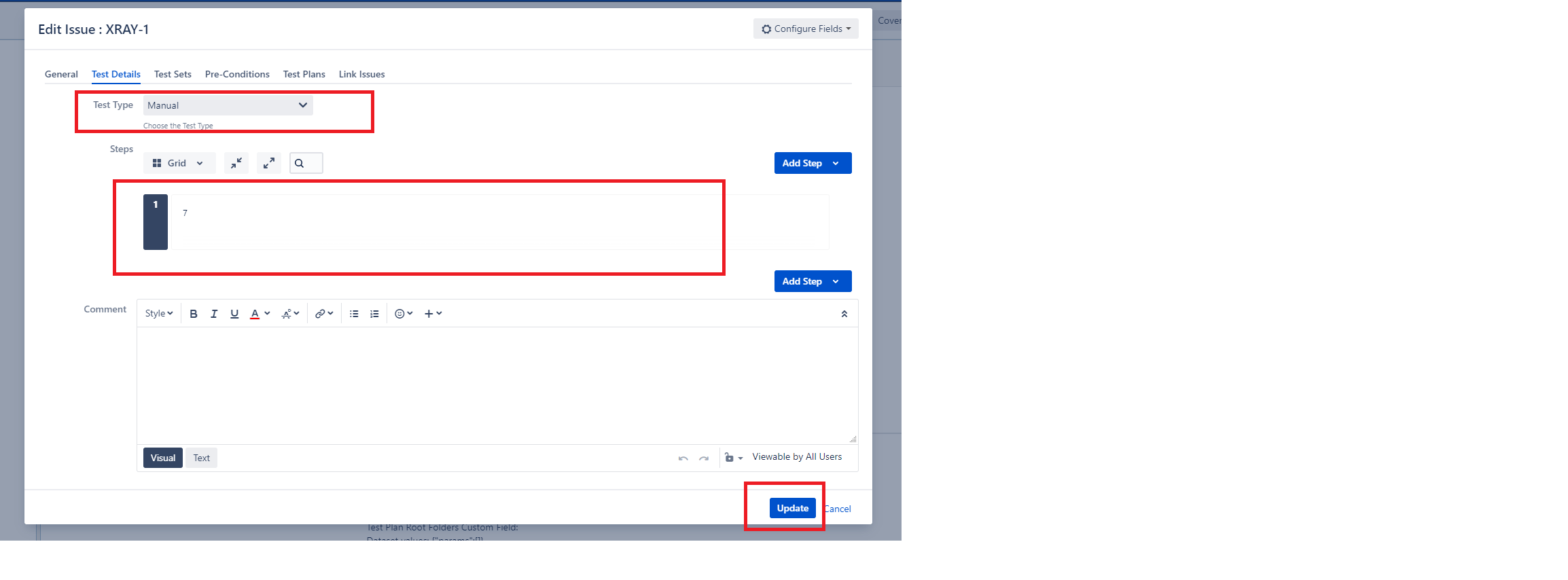

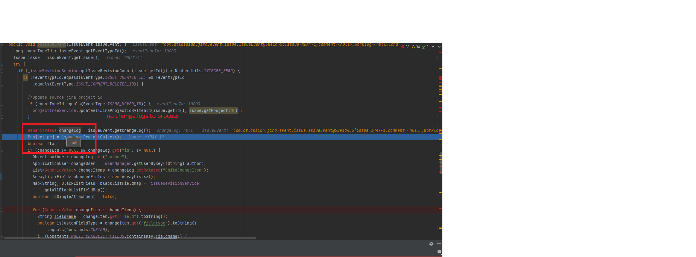

I have a listener that listens on Edit Issue Events and that event usually has changelogs information of what was the old and the current value of a certain field, for some reason
when an Xray "Test" Issue Type is edited specifically is "Manual Test Steps" it does not have a changelog of the value before and after the edit
