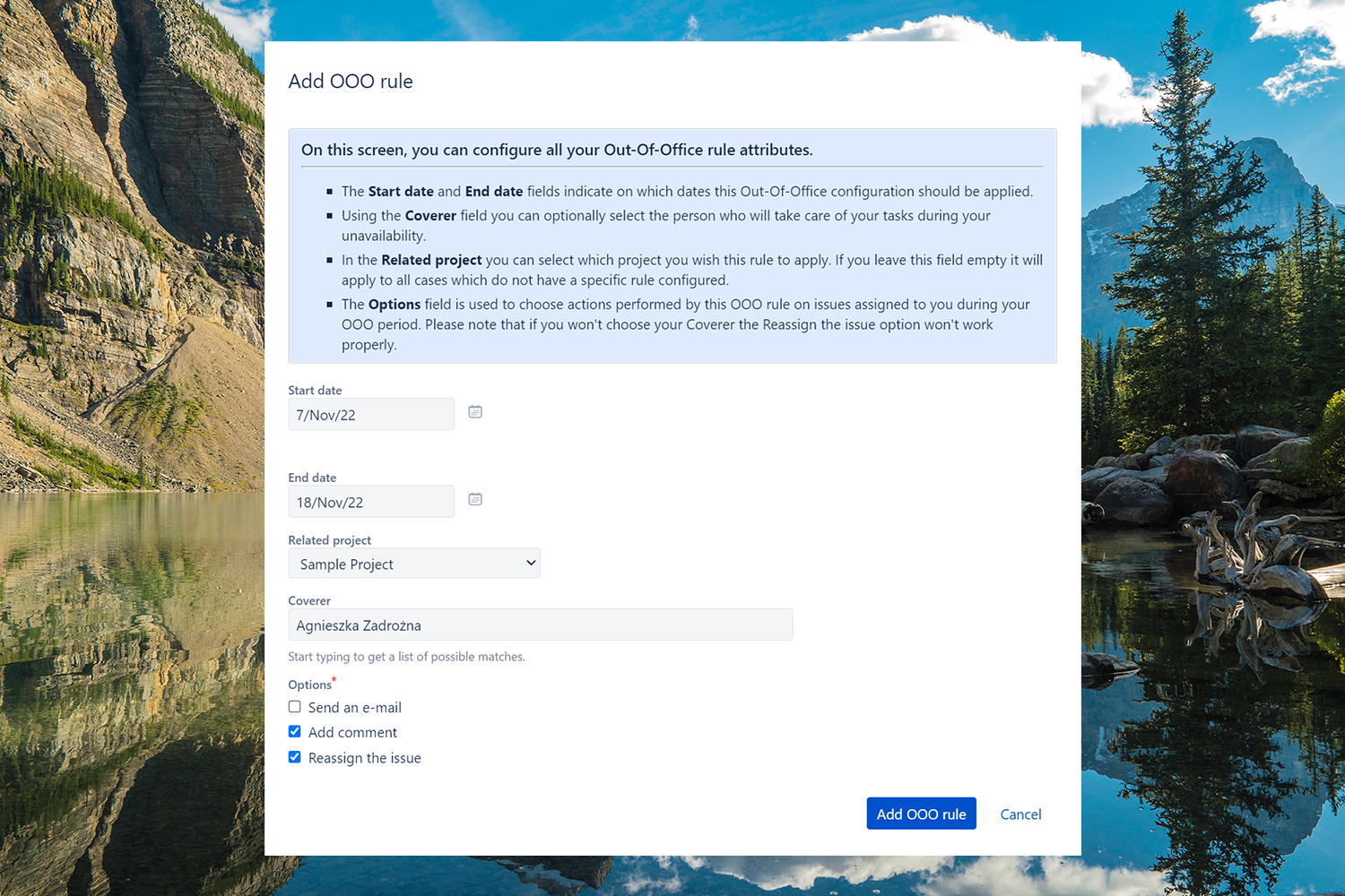

The workflow associated with the Task issue type requires only a few modifications - I suggest changing the name of the transition used to configure OOO to "Add OOO rule" and modifying the screen attached to this transition.

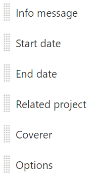

From the screen, we will remove the "Auto assign" field which will be replaced with a more functional alternative. We will add two new fields to this screen:
- Related project - a new custom field of the Project Picker type indicating the Jira project on which the rule should apply
- Options - new custom field of Checkbox type with a new context for OOO project with options Send an e-mail (default option), Add comment, Reassign the issue. This field will define the operating mode of the implemented solution. The field allows you to check multiple options.
Additionally, let's modify the Default Value of the Info message field to one that more precisely describes how to fill in fields on this screen:
{panel:bgColor=#deebff}
h4. On this screen, you can configure all your Out-Of-Office rule attributes.\\
- The *Start date* and *End date* fields indicate on which dates this Out-Of-Office configuration should be applied.
- Using the *Coverer* field you can optionally select the person who will take care of your tasks during your unavailability.
- In the *Related project* field you can select which project you wish this rule to apply. If you leave this field empty it will apply to all cases which do not have a specific rule configured.
- The *Options* field is used to choose actions performed by this OOO rule on issues assigned to you during your OOO period. Please note that if you won't choose your Coverer the Reassign the issue option won't work properly.

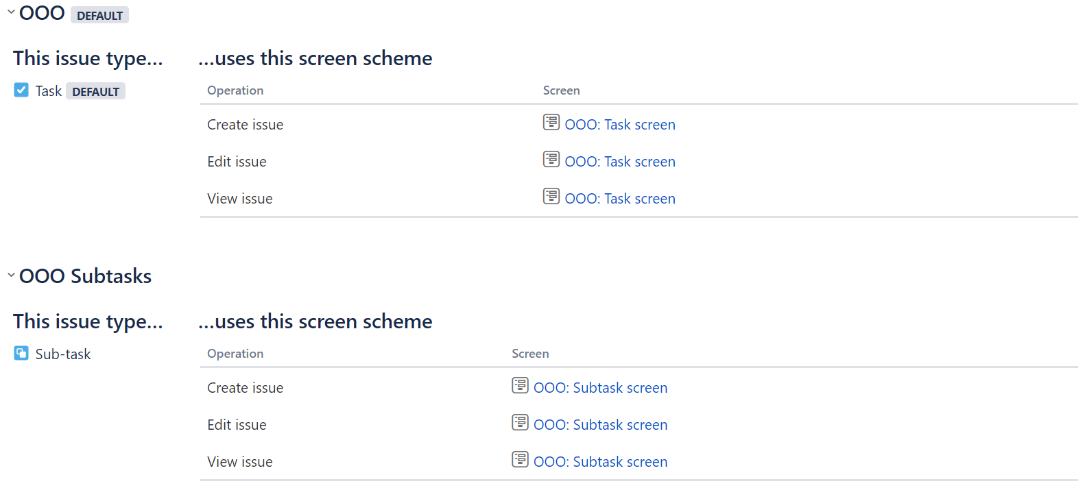

Screens / Screen Schemes / Issue type screen scheme
Before we start creating this Jira automation rule, let's modify the screens used in the Issue Type Screen Scheme assigned to the project:
- All operations for Task have an associated screen with the fields: Summary and Assignee

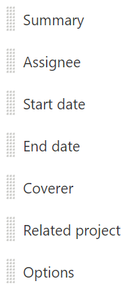

- All operations for Subtask have an associated screen with the following fields: Summary, Assignee, Start date, End date, Coverer, Related project, Options

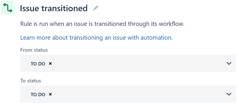

- Trigger: Issue transitioned - from "To do" status to itself

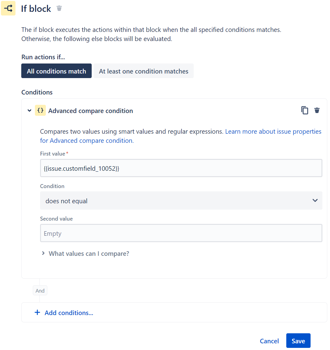

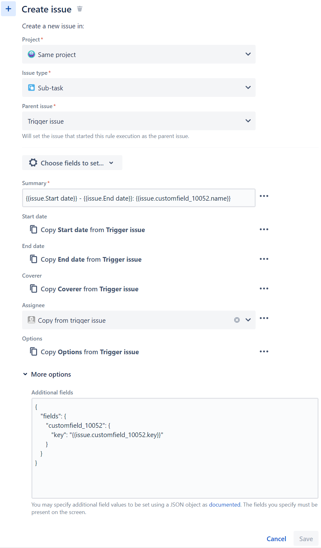

- Create a sub-task if the project was selected in the Related project field (field id - 10052: you can check any custom field id in the ways described here). Because the project picker field is not fully supported in some Jira Automation components (for example they are not visible in choose field during issue creation or edit actions) we need to take care of them in a more advanced way shown below:
- "If" block with Advanced compare condition: {{issue.customfield_10052}} does not equal Empty
- Create issue action with the following configuration:

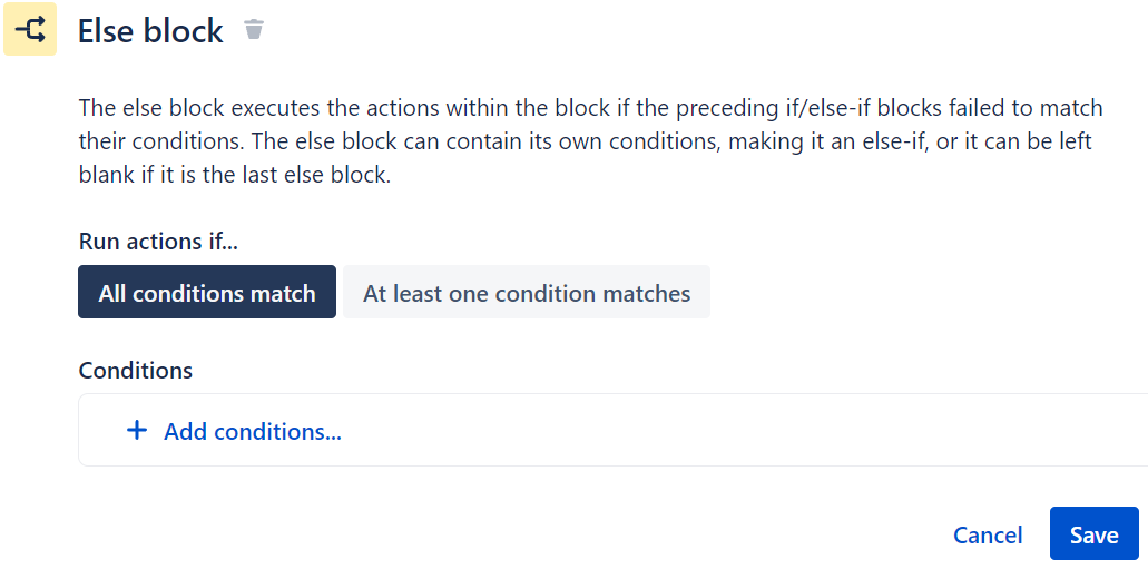

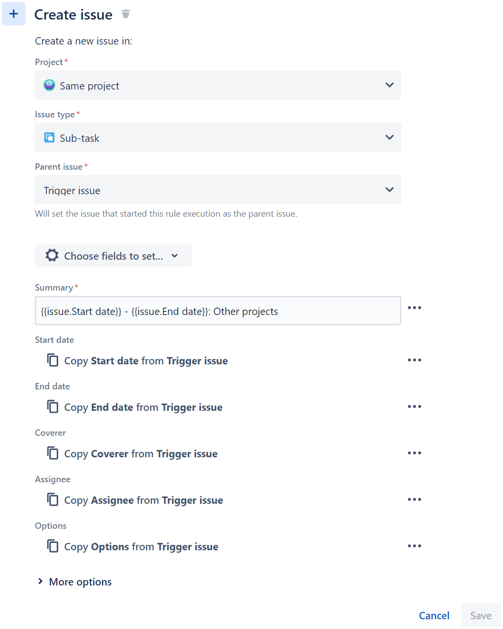

- Create a sub-task if the project was not selected in the Related project field
- "Else" block without any additional conditions

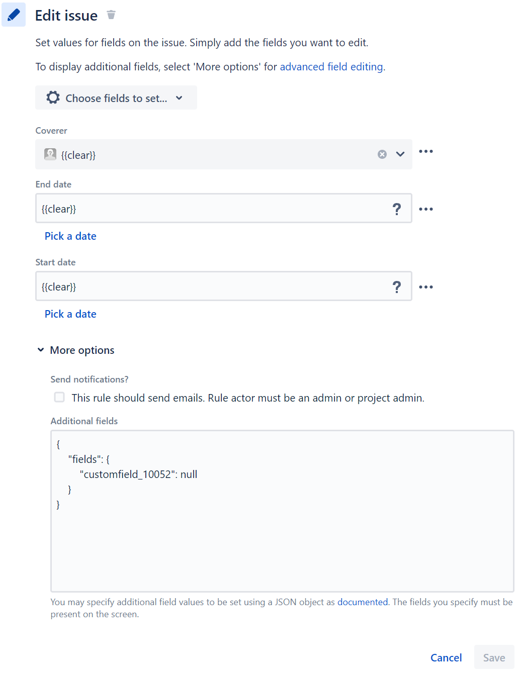

- Clean Task fields regardless of the Related project field using the Edit issue action:

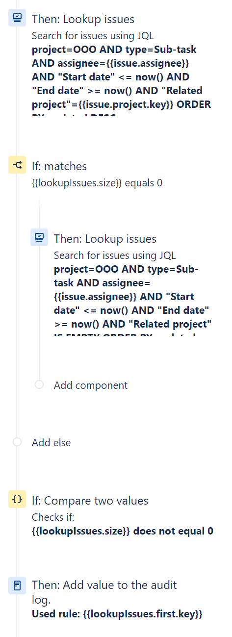

- To retrieve the correct Out Of Office rule we will use the following set of components:

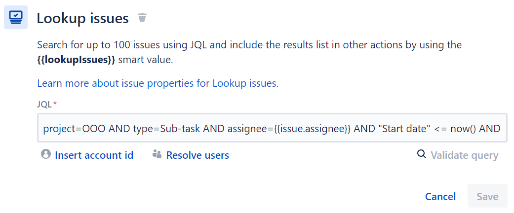

- Lookup issues action with configured JQL:
project=OOO AND type=Sub-task AND assignee={{issue.assignee}} AND "Start date" <= now() AND "End date" >= now() AND "Related project"={{issue.project.key}} ORDER BY updated DESC
to get the newest user OOO sub-task related to the current date with the current project selected in the Related project field.

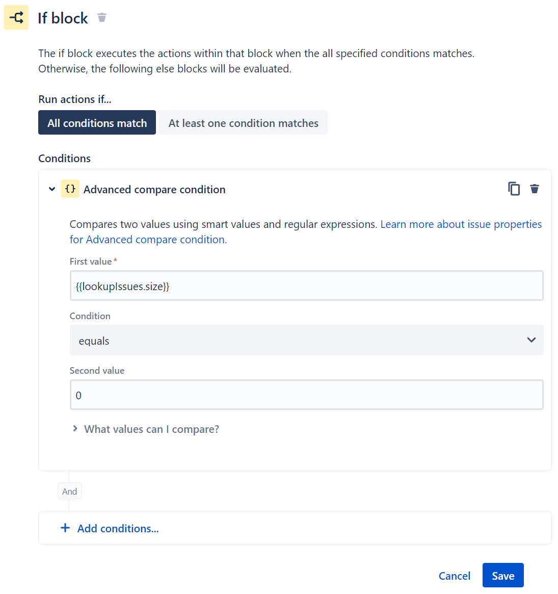

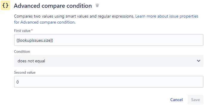

- Advanced compare condition: {{lookupIssues.size}} equals 0 - to overwrite the OOO rule in case there is no specific rule for the current project (if the previous component did not return any sub-task)
project=OOO AND type=Sub-task AND assignee={{issue.assignee}} AND "Start date" <= now() AND "End date" >= now() AND "Related project" IS EMPTY ORDER BY updated DESC
to get the newest user OOO sub-task related to the current date with an empty Related project field.
- Advanced compare condition: {{lookupIssues.size}} does not equal 0 - to run the rule only if the user configured the proper OOO rule.

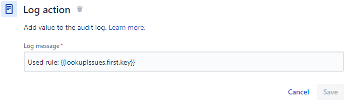

- Log action: Used rule: {{lookupIssues.first.key}} - to save this information in the rule audit log for future troubleshooting purposes.

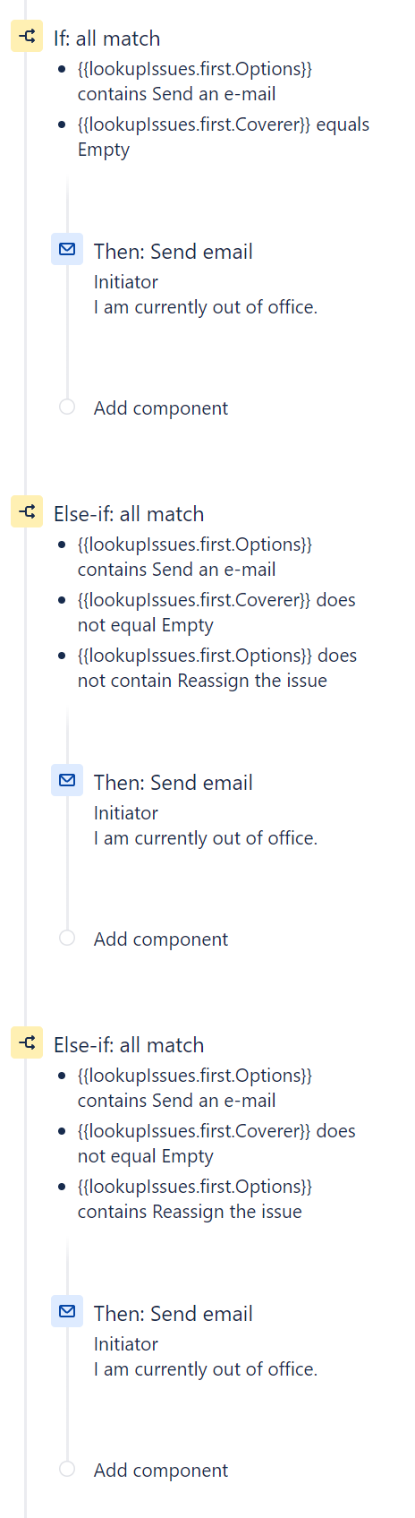

- Main rule components are divided into 3 sections - one for each action possible to configure in the Options field:

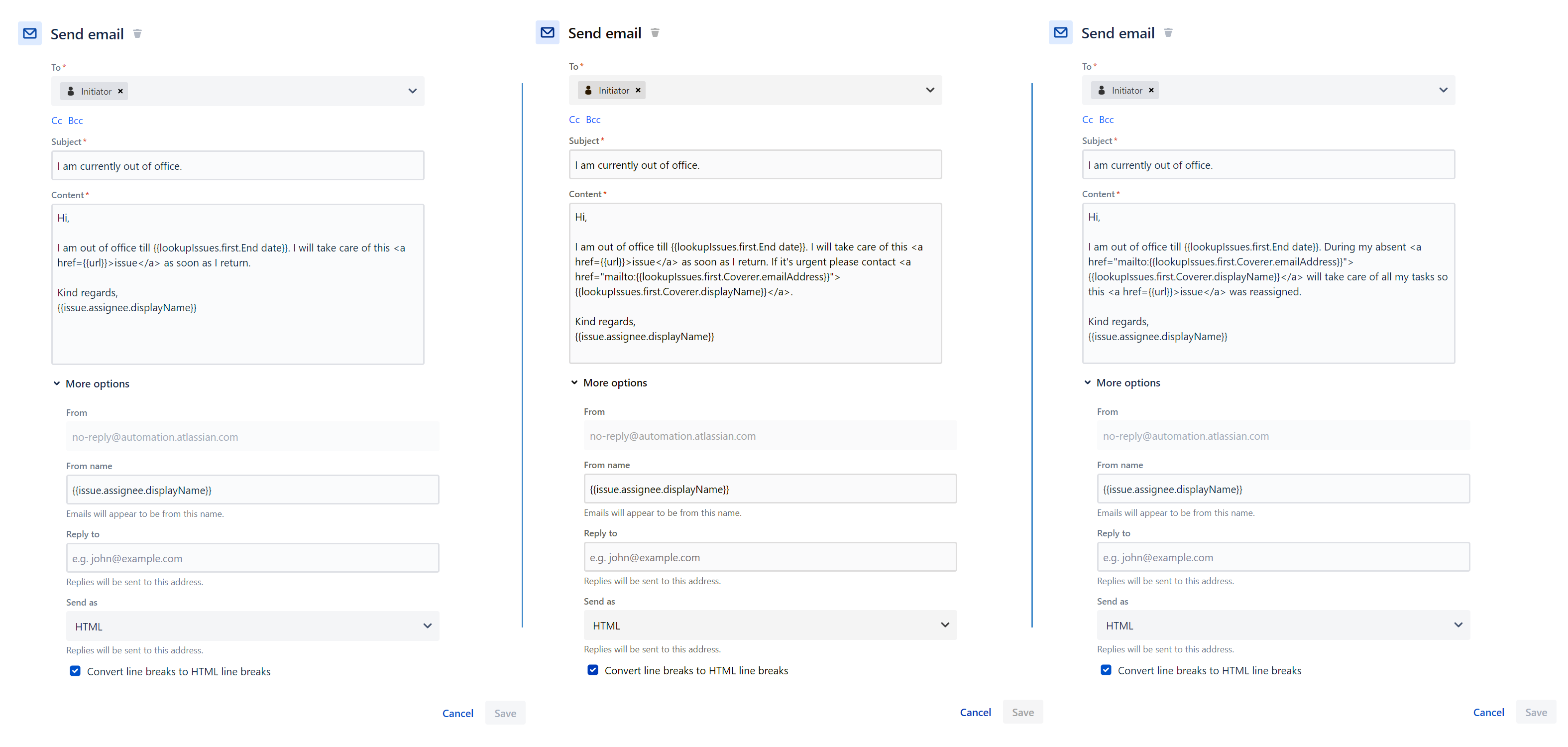

- The first section is used to send an e-mail notification to the user who has assigned an issue to an absent user.
As you can notice there are 3 possible outcomes with different e-mail body content:

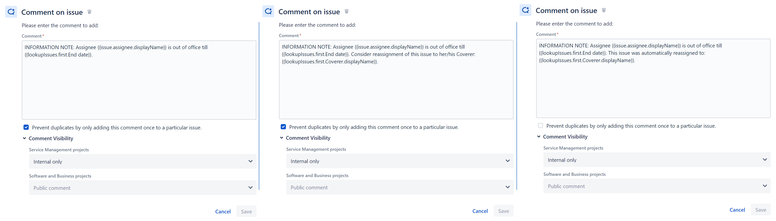

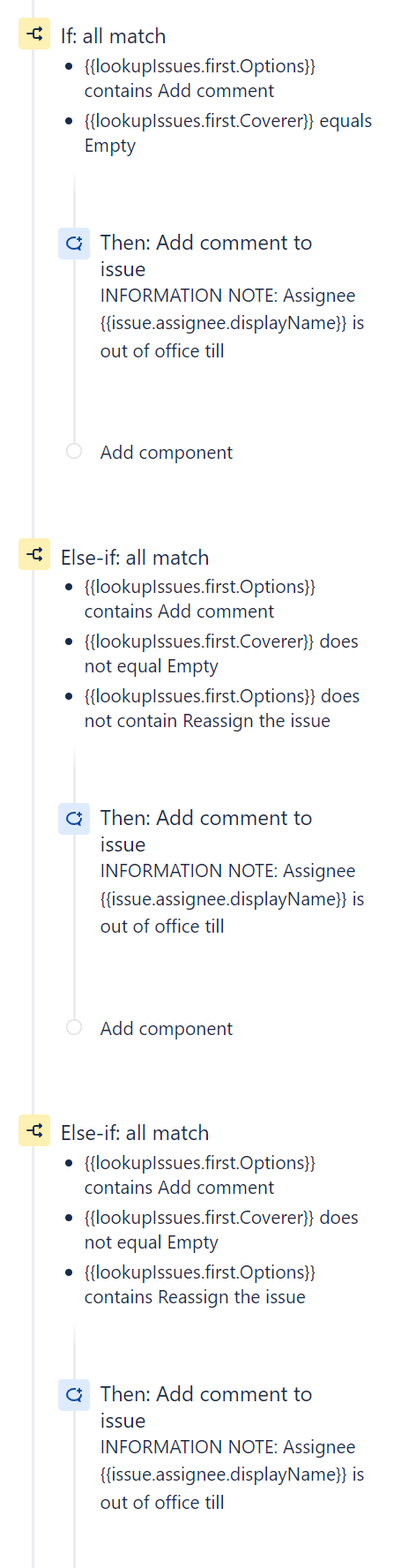

- The next section is used to add a comment to an issue assigned to an absent user.
As you can notice there are 3 possible outcomes with different comment content:

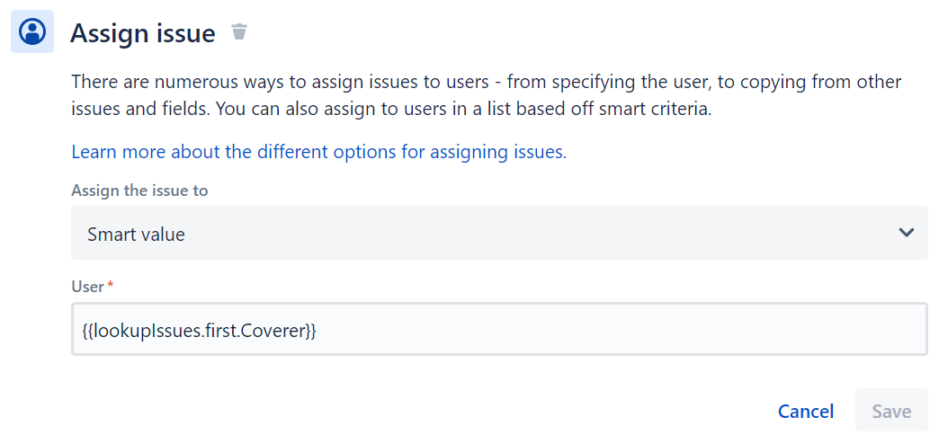

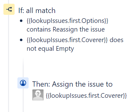

- The last section is responsible to reassign an issue to the coverer
