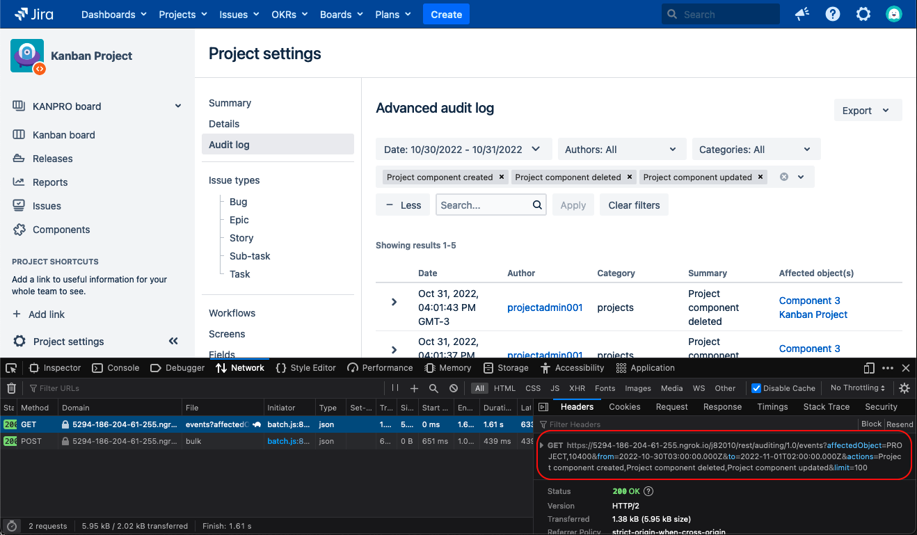

Project administrators have access to the project audit log with entries about changes on the project configuration.
The Project admin can create filters for the specific areas they would like to audit.
For example, below is a filter selecting only some events associated to Project Components.
Below is an example when applying a similar filter while checking for the network requests made from the browser to the Jira backend server.
As highlighted above, this feature relies on an internal API method /rest/auditing/1.0/events, which provide a JSON list with the results of the filter - this is an internal API which is subject to changes on Jira version upgrades.

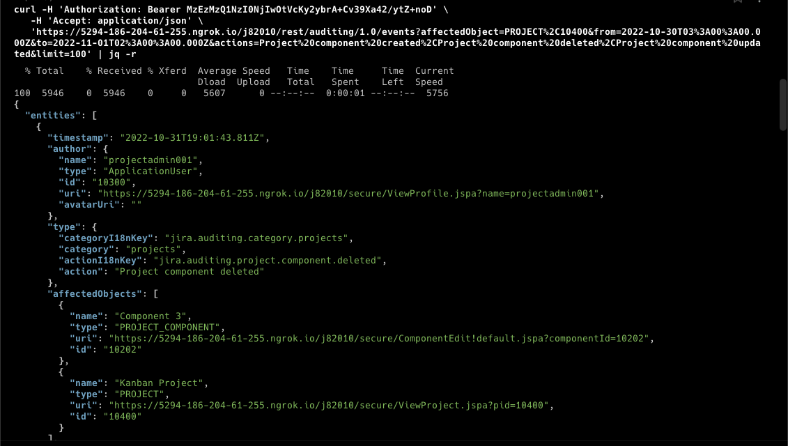

The API structure is as below:
<Jira-Base-URL>/rest/auditing/1.0/events?affectedObject=PROJECT%2C<Project-ID>&from=<from-Date>&to=<to-Date>&actions=<list-of-selected-actions>&limit=100
Running a request to this API would give us an output similar to the below.

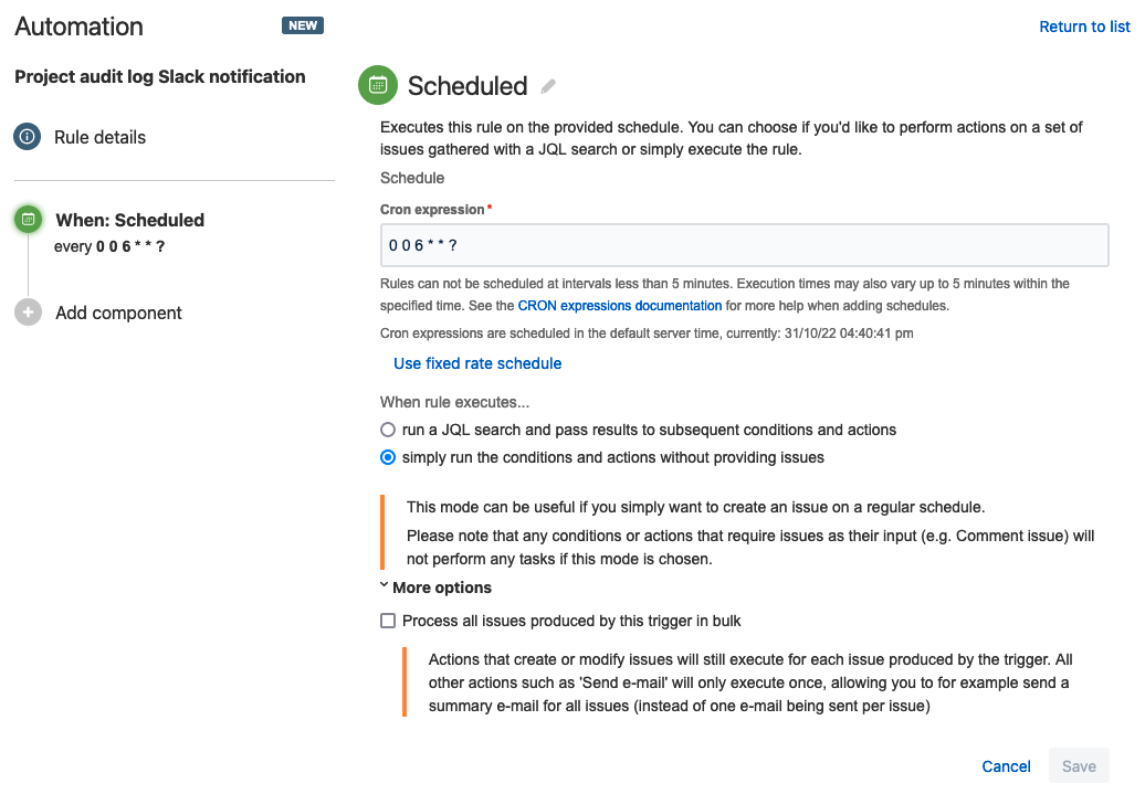

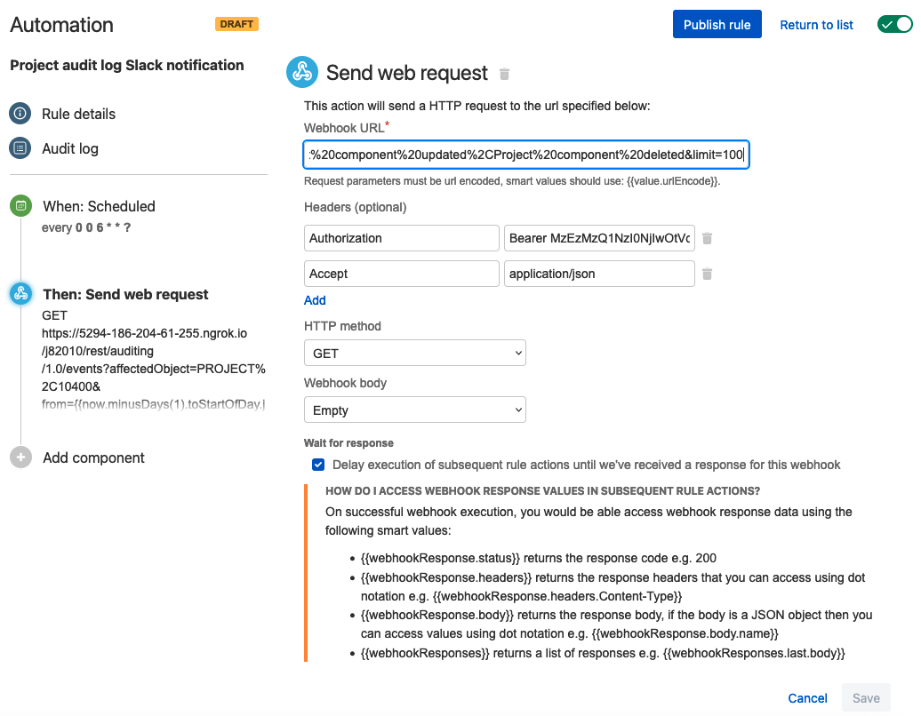

I've created a scheduled trigger to run the rule every day based on a cron expression.
Then I've created a send web request action to run the project audit log API.
Here's the request (webhook URL) I used and the explanation for some of the parameters:
https://5294-186-204-61-255.ngrok.io/j82010/rest/auditing/1.0/events?affectedObject=PROJECT,10400&from={{now.minusDays(1).toStartOfDay.jiraDateTime.substring(0,19).concat("Z").urlEncode()}}&to={{now.toStartOfDay.jiraDateTime.substring(0,19).concat("Z").urlEncode()}}&actions=Project%20component%20created%2CProject%20component%20updated%2CProject%20component%20deleted&limit=100
- from={{now.minusDays(1).toStartOfDay.jiraDateTime.substring(0,19).concat("Z").urlEncode()}} – indicates yesterday at the start of the day using A4J smart values.
- to={{now.toStartOfDay.jiraDateTime.substring(0,19).concat("Z").urlEncode()}} – indicates today at the start of the day using A4J smart values.
If you want to change how often the rule runs, these two smart values should be modified to prevent sending duplicated notifications.

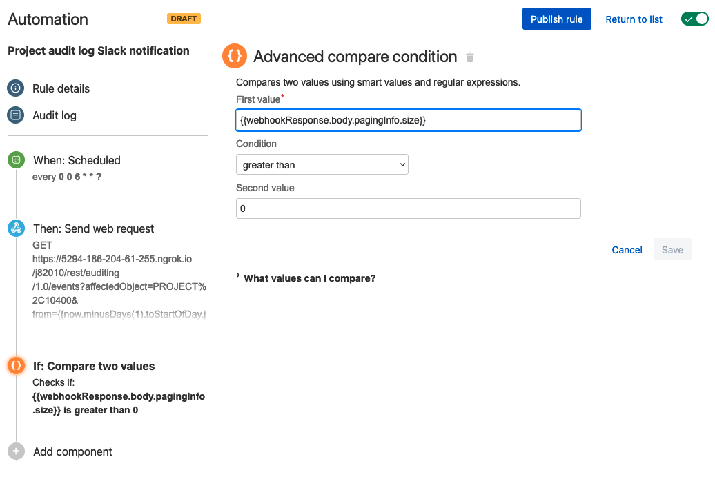

With an advanced compare condition we check if the API response gives us any list of changes.

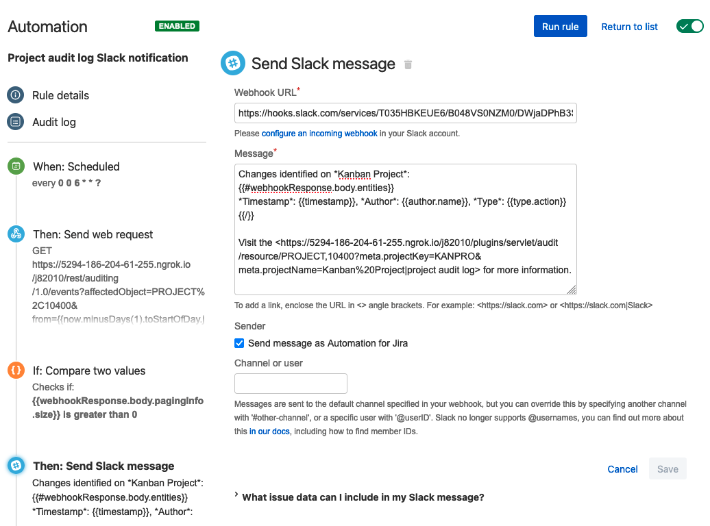

As the last piece of the puzzle, we need to use the send Slack message action to create the notification.
The message used in this example is as below.
Changes identified on *Kanban Project*:
{{#webhookResponse.body.entities}}
*Timestamp*: {{timestamp}}, *Author*: {{author.name}}, *Type*: {{type.action}}
Visit the <https://5294-186-204-61-255.ngrok.io/j82010/plugins/servlet/audit/resource/PROJECT,10400?meta.projectKey=KANPRO&meta.projectName=Kanban Project|project audit log> for more information.

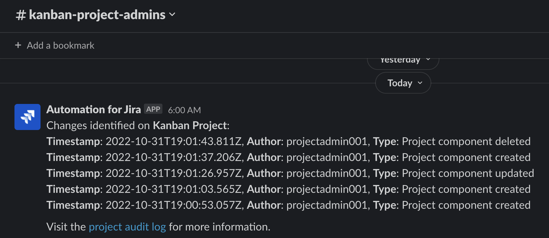

When the rule is executed, the message in Slack looks like below.
