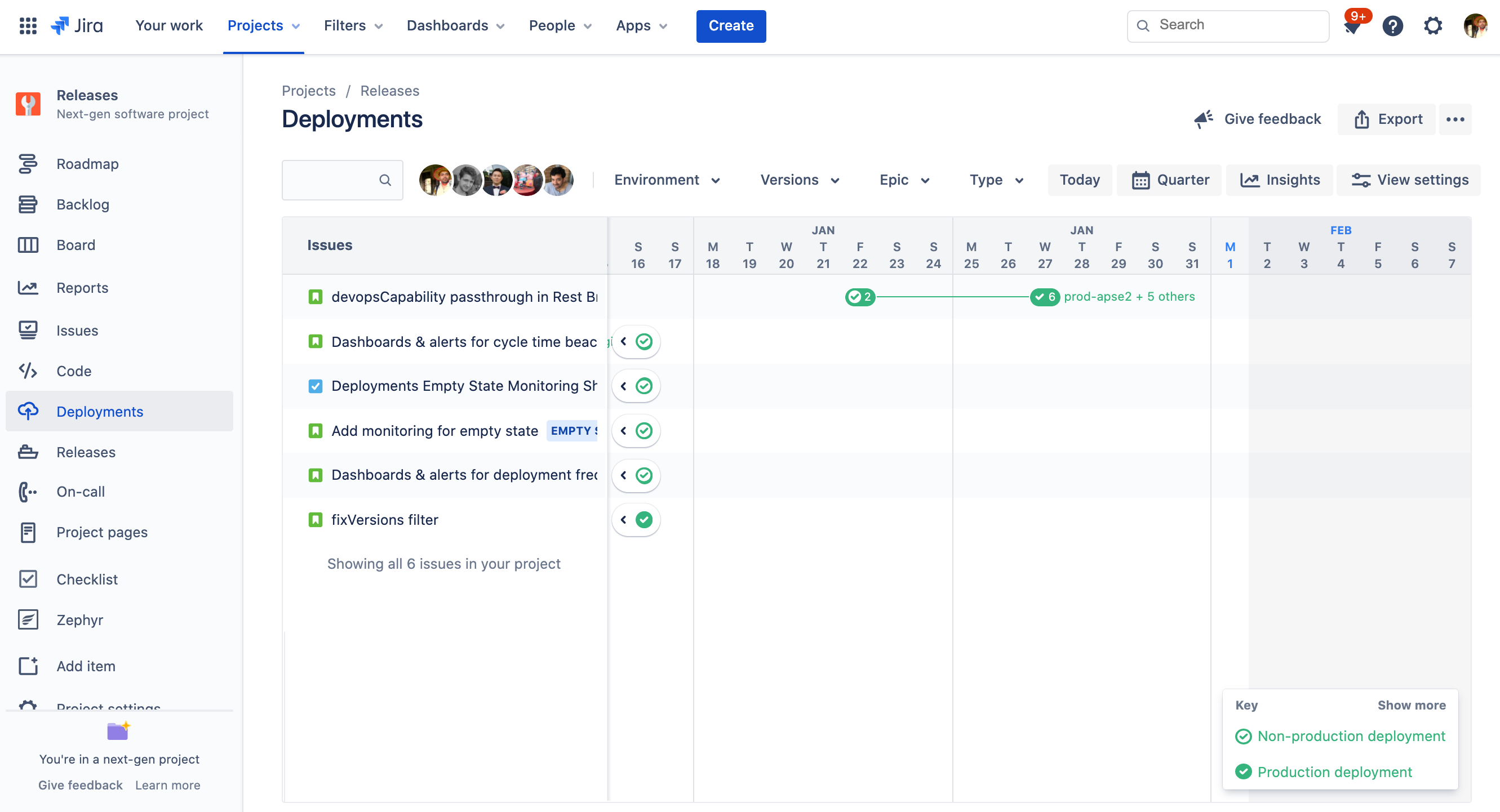

Deployments View
This gives you a global view of the tickets that have been recently deployed to your various environments on very handy timeline:
This view is really useful to find the tickets that have been recently deployed to your various environments.

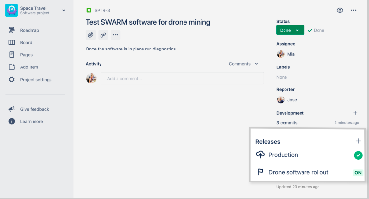

Issue Deployment View
Jira Software provides also an easy way to access the deployment status of an issue from its “Development” information tab:

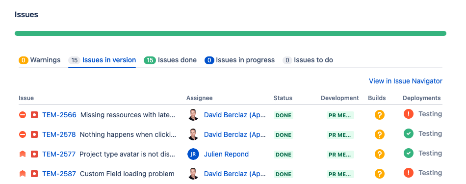

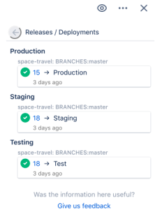

Releases Panel
The last deployments of an issue can now also be accessed directly from the “Releases” page:
