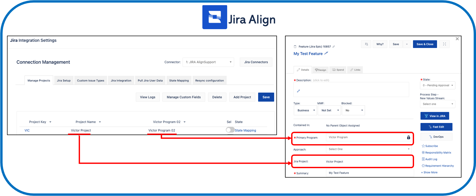

Jira Align work item’s Program and Jira Project fields do not match with Jira Connector’s Jira Project and Program mapping
Take for example when we need to change the Program assigned to an already integrated Jira project that has already several work items (Stories, Features) already synced properly. Also, when you move currently integrated Jira work items between Jira Projects and you must adjust Jira Align Project to Program mapping.
This concurrence match may happen due to a migration/change of a Project to Program mapping on the Jira Connector’s settings in addition to not pushing sync data for all the work items related to this Project from the Jira to Jira Align direction (and not the opposite) right after.
If after this change Jira Align pushes data to Jira’s Work items before Jira does, then all of the related work items will throw the “No changes were pulled (…)" error entry, and block their subsequent syncs.

Correcting the work item’s Program would fix the problem, however, the Primary Program field is blocked for manual changes, so for these cases, we recommend disabling the sync from Jira Align to Jira, and forcing a sync from Jira to Jira Align:

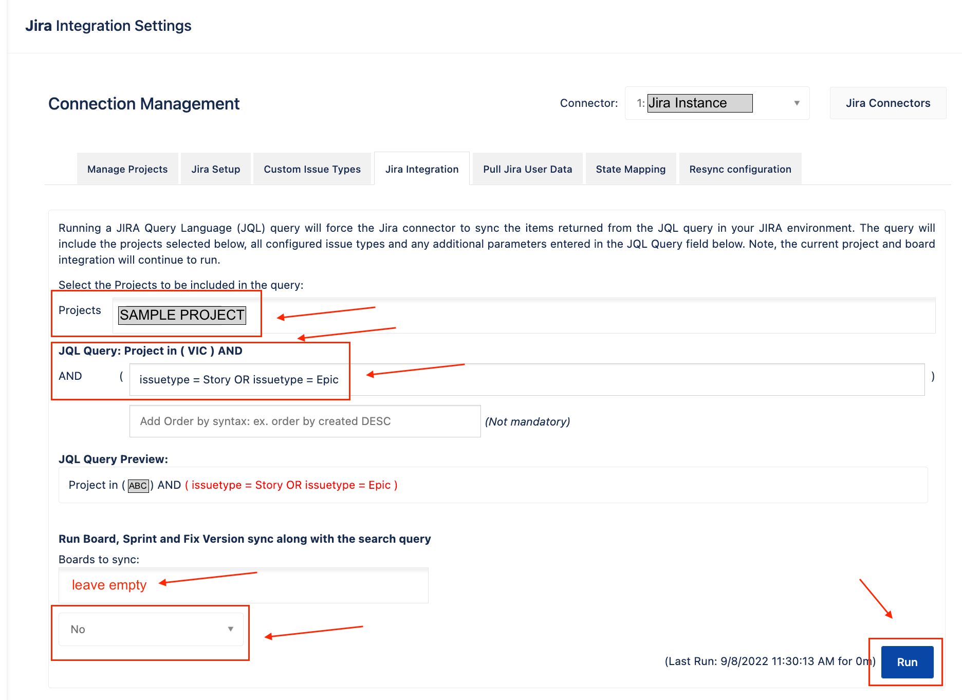

Browse to Jira Settings (:coggmail: Administration > Jira Settings > Jira Integration tab), then fill in the following fields accordingly, as we’ll run a custom JQL to pull the stories/features from Jira:
Projects field: inform the affected work item’s Jira Project
AND constraint: fill in with the following custom JQL query
issuetype = Story OR issuetype = Epic
Leave Run Board field empty
Select No in the corresponding dropdown
Hit the Run button to commence sync
- Refresh the page then check the timestamp near the Run button to see how the sync is progressing (clicking browser's refresh button is good enough)
- When the "Last Run (…)” message is seen, that means the Custom JQL is done
- Revert Jira Connector settings to the previous configuration (noted in step 2.a)
- The affected work items should now get synchronized as expected
