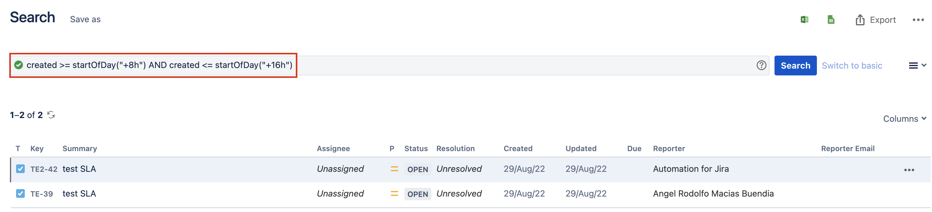

Creating a JQL query that finds ticket targets to which you would want to apply your new SLA to
First step is simple, we will work on a JQL query that finds all tickets we need to apply this new SLA to.
An example of this JQL is:
created >= startOfDay("+8h") AND created <= startOfDay("+16h")
You can use the advanced search feature to test that your JQL gives you the correct results.
The above will find all tickets that are created from your current from 8AM to 4PM on your current Calendar Time.

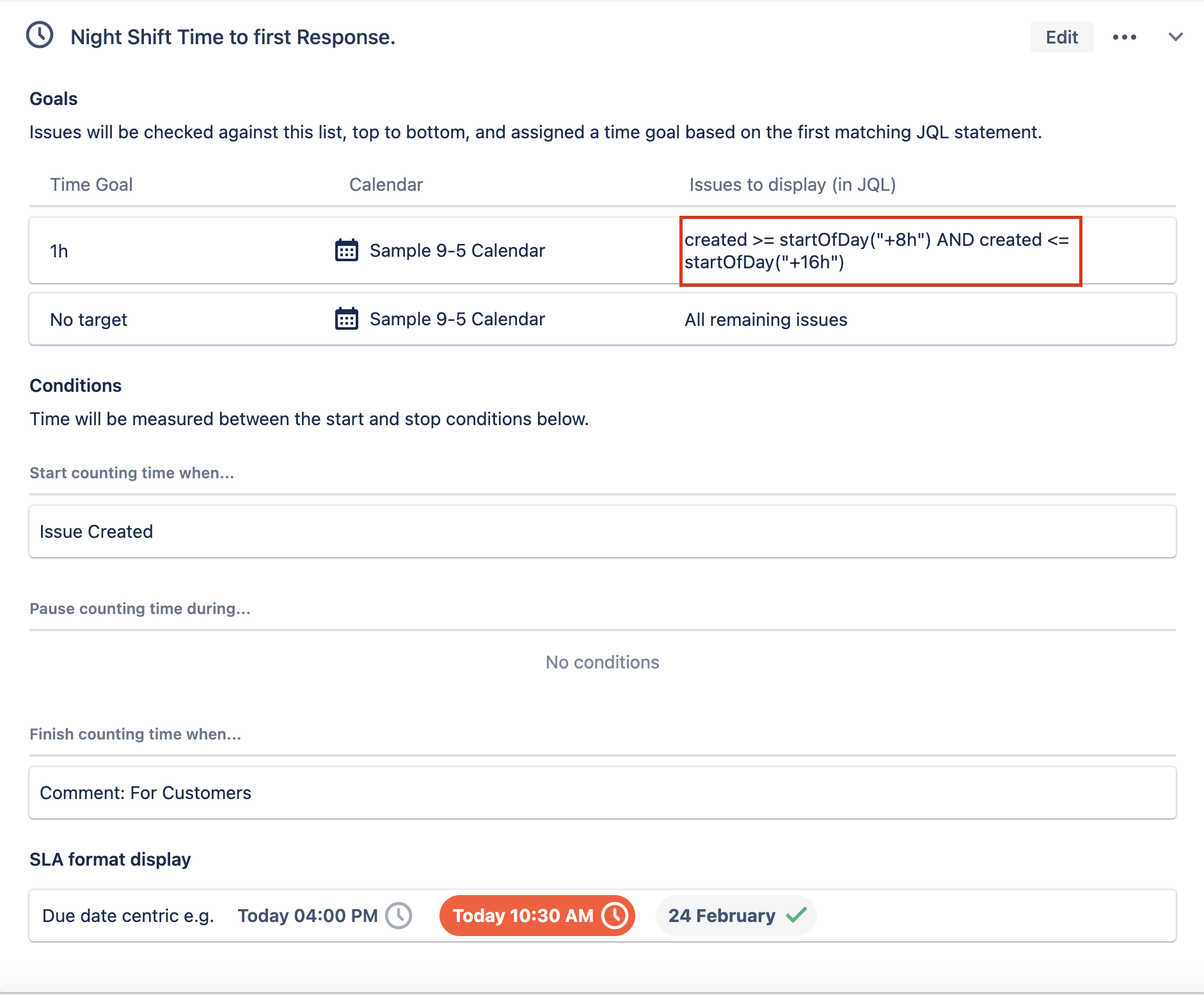

Creating an SLA for the Time Zone using the JQL we just created.
To implement this into an SLA we need to do the following steps.
Go to:
Project Settings → SLAs → Add SLA
NOTE: In this example i’m using the Jira Default 9 to 5 Calendar that is already in the system, however if you want to add additional Calendars you can feel free to do so and adjust to match.
We would want to create something like below:
On the above example, I’m utilizing the example to implement a Night Shift Time to First Response.
I’m Utilizing the time period/interval that would match their work period while still taking into account the system time.
That is it!
Once you’ve saved your SLA if you used the correct time interval it will begin to apply it to the applicable tickets.
