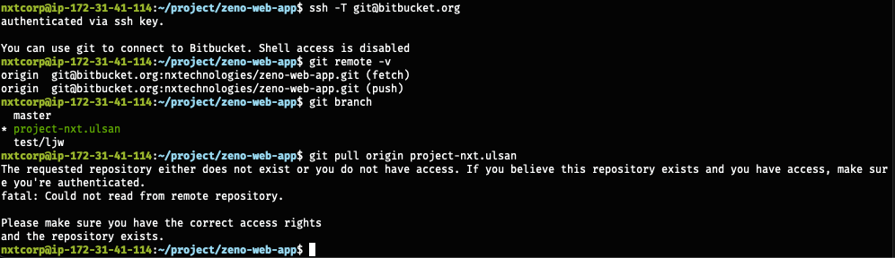

git repository : bitbucket
server : aws ec2
occur situation : $git pull, $git push, $git merge ...
We have to deploy our service app.
So, first I accessed server and did git pull, but printed Error message as screenshot image.
Already tested access to git@bitbucket.org through ssh-key and re-connect remote url, but still occur this issue...
I've been suffering 2 days... I don't know reason of this issue.
Please help me.
[Error msg]
The requested repository either does not exist or you do not have access. If you believe this repository exists and you have access, make sure you're authenticated.
fatal: Could not read from remote repository.
Please make sure you have the correct access rights
and the repository exists.
nxtcorp@ip-172-31-41-114:~/project/zeno-web-app$ GIT_TRACE_PACKET=1 GIT_TRACE=1 GIT_CURL_VERBOSE=1 GIT_SSH_COMMAND="ssh -vvv" git clone git@bitbucket.org:workspace/repository
15:45:41.925964 git.c:419 trace: built-in: git clone git@bitbucket.org:workspace/repository
Cloning into 'repository'...
15:45:41.931385 run-command.c:643 trace: run_command: unset GIT_DIR; 'ssh -vvv' git@bitbucket.org 'git-upload-pack '\''workspace/repository'\'''
OpenSSH_7.2p2 Ubuntu-4ubuntu2.8, OpenSSL 1.0.2g 1 Mar 2016
debug1: Reading configuration data /home/nxtcorp/.ssh/config
debug1: /home/nxtcorp/.ssh/config line 1: Applying options for bitbucket.org
debug1: Reading configuration data /etc/ssh/ssh_config
debug1: /etc/ssh/ssh_config line 19: Applying options for *
debug2: resolving "bitbucket.org" port 22
debug2: ssh_connect_direct: needpriv 0
debug1: Connecting to bitbucket.org [104.192.141.1] port 22.
debug1: Connection established.
debug1: identity file /home/nxtcorp/.ssh/id_rsa type 1
debug1: key_load_public: No such file or directory
debug1: identity file /home/nxtcorp/.ssh/id_rsa-cert type -1
debug1: Enabling compatibility mode for protocol 2.0
debug1: Local version string SSH-2.0-OpenSSH_7.2p2 Ubuntu-4ubuntu2.8
debug1: Remote protocol version 2.0, remote software version conker_3fc4c14a25 71611c9a05b6
debug1: no match: conker_3fc4c14a25 71611c9a05b6
debug2: fd 3 setting O_NONBLOCK
debug1: Authenticating to bitbucket.org:22 as 'git'
debug3: hostkeys_foreach: reading file "/home/nxtcorp/.ssh/known_hosts"
debug3: record_hostkey: found key type RSA in file /home/nxtcorp/.ssh/known_hosts:1
debug3: load_hostkeys: loaded 1 keys from bitbucket.org
debug3: order_hostkeyalgs: prefer hostkeyalgs: ssh-rsa-cert-v01@openssh.com,rsa-sha2-512,rsa-sha2-256,ssh-rsa
debug3: send packet: type 20
debug1: SSH2_MSG_KEXINIT sent
debug3: receive packet: type 20
debug1: SSH2_MSG_KEXINIT received
debug2: local client KEXINIT proposal
debug2: KEX algorithms: curve25519-sha256@libssh.org,ecdh-sha2-nistp256,ecdh-sha2-nistp384,ecdh-sha2-nistp521,diffie-hellman-group-exchange-sha256,diffie-hellman-group-exchange-sha1,diffie-hellman-group14-sha1,ext-info-c
debug2: host key algorithms: ssh-rsa-cert-v01@openssh.com,rsa-sha2-512,rsa-sha2-256,ssh-rsa,ecdsa-sha2-nistp256-cert-v01@openssh.com,ecdsa-sha2-nistp384-cert-v01@openssh.com,ecdsa-sha2-nistp521-cert-v01@openssh.com,ssh-ed25519-cert-v01@openssh.com,ecdsa-sha2-nistp256,ecdsa-sha2-nistp384,ecdsa-sha2-nistp521,ssh-ed25519
debug2: ciphers ctos: chacha20-poly1305@openssh.com,aes128-ctr,aes192-ctr,aes256-ctr,aes128-gcm@openssh.com,aes256-gcm@openssh.com,aes128-cbc,aes192-cbc,aes256-cbc,3des-cbc
debug2: ciphers stoc: chacha20-poly1305@openssh.com,aes128-ctr,aes192-ctr,aes256-ctr,aes128-gcm@openssh.com,aes256-gcm@openssh.com,aes128-cbc,aes192-cbc,aes256-cbc,3des-cbc
debug2: MACs ctos: umac-64-etm@openssh.com,umac-128-etm@openssh.com,hmac-sha2-256-etm@openssh.com,hmac-sha2-512-etm@openssh.com,hmac-sha1-etm@openssh.com,umac-64@openssh.com,umac-128@openssh.com,hmac-sha2-256,hmac-sha2-512,hmac-sha1
debug2: MACs stoc: umac-64-etm@openssh.com,umac-128-etm@openssh.com,hmac-sha2-256-etm@openssh.com,hmac-sha2-512-etm@openssh.com,hmac-sha1-etm@openssh.com,umac-64@openssh.com,umac-128@openssh.com,hmac-sha2-256,hmac-sha2-512,hmac-sha1
debug2: compression ctos: none,zlib@openssh.com,zlib
debug2: compression stoc: none,zlib@openssh.com,zlib
debug2: languages ctos:
debug2: languages stoc:
debug2: first_kex_follows 0
debug2: reserved 0
debug2: peer server KEXINIT proposal
debug2: KEX algorithms: curve25519-sha256@libssh.org,ecdh-sha2-nistp256,ecdh-sha2-nistp384,ecdh-sha2-nistp521,diffie-hellman-group14-sha1,diffie-hellman-group1-sha1,ext-info-s
debug2: host key algorithms: ssh-rsa,rsa-sha2-256,rsa-sha2-512,ssh-dss
debug2: ciphers ctos: aes128-ctr,aes192-ctr,aes256-ctr,aes128-gcm@openssh.com,chacha20-poly1305@openssh.com
debug2: ciphers stoc: aes128-ctr,aes192-ctr,aes256-ctr,aes128-gcm@openssh.com,chacha20-poly1305@openssh.com
debug2: MACs ctos: hmac-sha2-256-etm@openssh.com,hmac-sha2-256,hmac-sha1,hmac-sha1-96
debug2: MACs stoc: hmac-sha2-256-etm@openssh.com,hmac-sha2-256,hmac-sha1,hmac-sha1-96
debug2: reserved 0
debug1: kex: algorithm: curve25519-sha256@libssh.org
debug1: kex: host key algorithm: rsa-sha2-512
debug1: kex: server->client cipher: chacha20-poly1305@openssh.com MAC: <implicit> compression: none
debug1: kex: client->server cipher: chacha20-poly1305@openssh.com MAC: <implicit> compression: none
debug3: send packet: type 30
debug1: expecting SSH2_MSG_KEX_ECDH_REPLY
debug3: receive packet: type 31
debug1: Server host key: ssh-rsa SHA256:zzXQOXSRBEiUtuE8AikJYKwbHaxvSc0ojez9YXaGp1A
debug3: record_hostkey: found key type RSA in file /home/nxtcorp/.ssh/known_hosts:8
debug3: load_hostkeys: loaded 1 keys from 104.192.141.1
debug1: Host 'bitbucket.org' is known and matches the RSA host key.
debug1: Found key in /home/nxtcorp/.ssh/known_hosts:1
debug3: send packet: type 21
debug2: set_newkeys: mode 1
debug1: rekey after 134217728 blocks
debug1: SSH2_MSG_NEWKEYS sent
debug1: expecting SSH2_MSG_NEWKEYS
debug3: receive packet: type 21
debug1: SSH2_MSG_NEWKEYS received
debug2: set_newkeys: mode 0
debug2: key: /home/nxtcorp/.ssh/id_rsa (0x565297730700), explicit, agent
debug3: send packet: type 5
debug3: receive packet: type 7
debug1: SSH2_MSG_EXT_INFO received
debug1: kex_input_ext_info: server-sig-algs=<ecdsa-sha2-nistp384-cert-v01@openssh.com,ssh-rsa,rsa-sha2-512,ecdsa-sha2-nistp521,ecdsa-sha2-nistp256-cert-v01@openssh.com,ssh-rsa-cert-v01@openssh.com,ssh-dss-cert-v01@openssh.com,ecdsa-sha2-nistp521-cert-v01@openssh.com,rsa-sha2-256,ssh-dss,ecdsa-sha2-nistp256,ecdsa-sha2-nistp384>
debug3: receive packet: type 6
debug2: service_accept: ssh-userauth
debug1: SSH2_MSG_SERVICE_ACCEPT received
debug3: send packet: type 50
debug3: receive packet: type 51
debug1: Authentications that can continue: publickey
debug3: start over, passed a different list publickey
debug3: preferred publickey
debug3: authmethod_lookup publickey
debug3: remaining preferred:
debug3: authmethod_is_enabled publickey
debug1: Next authentication method: publickey
debug1: Offering RSA public key: /home/nxtcorp/.ssh/id_rsa
debug3: send_pubkey_test
debug2: we sent a publickey packet, wait for reply
debug3: receive packet: type 60
debug1: Server accepts key: pkalg rsa-sha2-512 blen 279
debug2: input_userauth_pk_ok: fp SHA256:s9DM6Of20tAJFnxY7D0FT8gZuCAjHtffcvDVCMy7agU
debug3: sign_and_send_pubkey: RSA SHA256:s9DM6Of20tAJFnxY7D0FT8gZuCAjHtffcvDVCMy7agU
debug3: receive packet: type 52
debug1: Authentication succeeded (publickey).
Authenticated to bitbucket.org ([104.192.141.1]:22).
debug2: fd 5 setting O_NONBLOCK
debug2: fd 6 setting O_NONBLOCK
debug1: channel 0: new [client-session]
debug3: ssh_session2_open: channel_new: 0
debug2: channel 0: send open
debug3: send packet: type 90
debug1: Entering interactive session.
debug1: pledge: network
debug3: receive packet: type 91
debug2: callback start
debug2: fd 3 setting TCP_NODELAY
debug3: ssh_packet_set_tos: set IP_TOS 0x08
debug2: client_session2_setup: id 0
debug1: Sending environment.
debug3: Ignored env LESSOPEN
debug3: Ignored env MAIL
debug3: Ignored env GIT_SSH_COMMAND
debug3: Ignored env SSH_CLIENT
debug3: Ignored env USER
debug3: Ignored env GIT_EXEC_PATH
debug3: Ignored env SSH_AGENT_PID
debug3: Ignored env SHLVL
debug3: Ignored env HOME
debug3: Ignored env OLDPWD
debug3: Ignored env NVM_BIN
debug3: Ignored env SSH_TTY
debug1: Sending env LC_TERMINAL_VERSION = 3.4.15
debug2: channel 0: request env confirm 0
debug3: send packet: type 98
debug3: Ignored env NVM_DIR
debug3: Ignored env LOGNAME
debug3: Ignored env _
debug3: Ignored env TERM
debug3: Ignored env XDG_SESSION_ID
debug3: Ignored env GIT_CURL_VERBOSE
debug3: Ignored env PATH
debug3: Ignored env GIT_TRACE_PACKET
debug3: Ignored env XDG_RUNTIME_DIR
debug1: Sending env LANG = en_US.UTF-8
debug3: Ignored env LS_COLORS
debug3: Ignored env SSH_AUTH_SOCK
debug3: Ignored env SHELL
debug3: Ignored env LESSCLOSE
debug1: Sending env LC_TERMINAL = iTerm2
debug3: Ignored env PWD
debug3: Ignored env NVM_CD_FLAGS
debug3: Ignored env SSH_CONNECTION
debug3: Ignored env XDG_DATA_DIRS
debug3: Ignored env TZ
debug3: Ignored env NODE_ENV
debug1: Sending command: git-upload-pack 'workspace/repository'
debug2: channel 0: request exec confirm 1
debug2: callback done
debug2: channel 0: open confirm rwindow 2097152 rmax 32768
debug3: receive packet: type 99
debug2: channel_input_status_confirm: type 99 id 0
debug2: exec request accepted on channel 0
debug2: channel 0: rcvd ext data 165
debug3: receive packet: type 98
debug1: client_input_channel_req: channel 0 rtype exit-status reply 0
debug3: receive packet: type 96
debug2: channel 0: rcvd eof
debug2: channel 0: output open -> drain
debug3: receive packet: type 97
debug2: channel 0: rcvd close
debug2: channel 0: close_read
debug2: channel 0: input open -> closed
debug3: channel 0: will not send data after close
debug2: channel 0: obuf_empty delayed efd 7/(165)
debug2: channel 0: written 165 to efd 7
debug2: channel 0: obuf empty
debug2: channel 0: close_write
debug2: channel 0: output drain -> closed
debug2: channel 0: almost dead
debug2: channel 0: gc: notify user
debug2: channel 0: gc: user detached
debug2: channel 0: send close
debug3: send packet: type 97
debug2: channel 0: is dead
debug2: channel 0: garbage collecting
debug1: channel 0: free: client-session, nchannels 1
debug3: channel 0: status: The following connections are open:
#0 client-session (t4 r0 i3/0 o3/0 fd -1/-1 cc -1)debug3: send packet: type 1
debug1: fd 0 clearing O_NONBLOCK
debug1: fd 1 clearing O_NONBLOCK
Transferred: sent 2780, received 2220 bytes, in 0.4 seconds
Bytes per second: sent 7356.9, received 5874.9
debug1: Exit status 1
fatal: Could not read from remote repository.Please make sure you have the correct access rights
