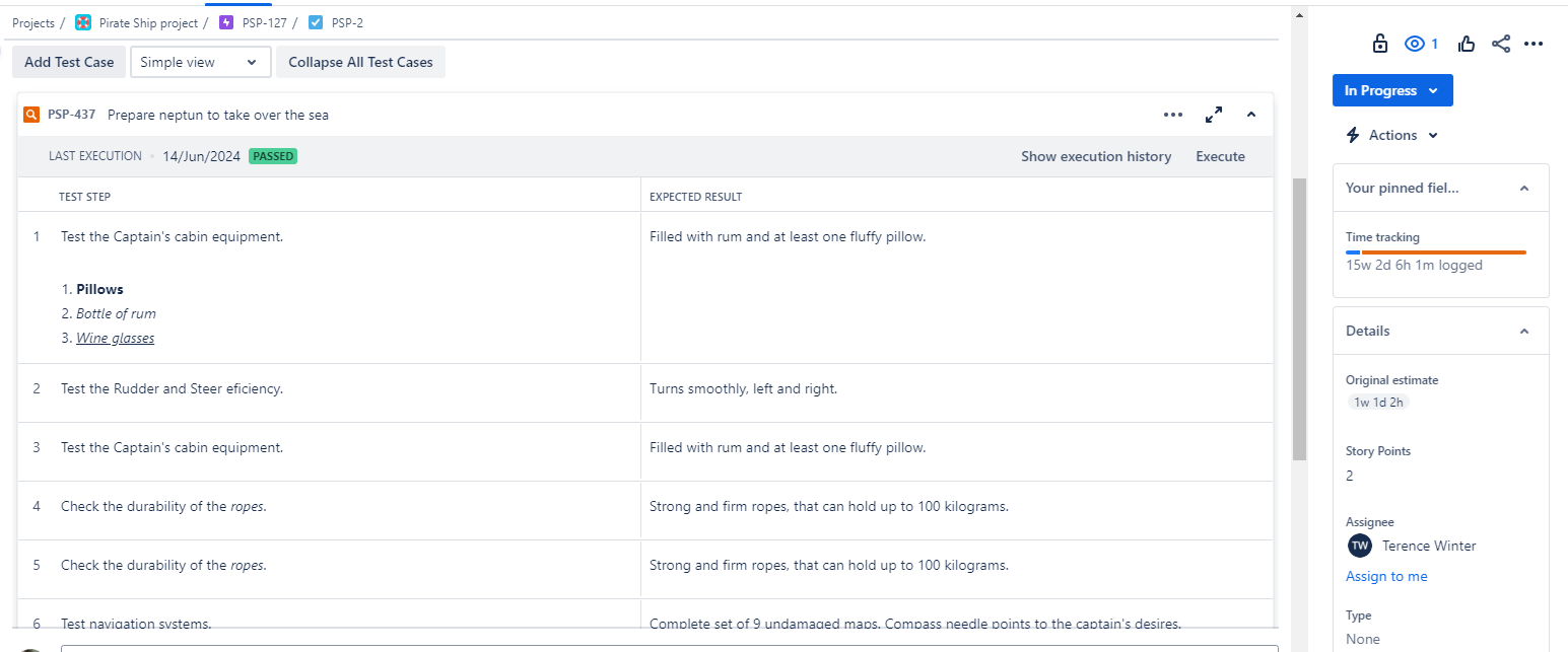

Test cases will be visible in Jira as QAlity Tests. They will have an orange square with a magnifying glass icon next to them:
A test case will contain test steps. With each of them, you can describe what you want to test. Whatever you want to achieve with your test, write it down as an Expected result – it’s a definition of your desired outcome of the test. When you display test cases (and test steps assigned to them), you can choose between a Simple and a Detail view. If you go for the latter, additionally to a test step and expected result, there will be more information to put – test data (data connected with this particular step) and test attachments (like images and other useful files). This allows you to better describe how your tests should be performed.
Once you have a test case ready, you can edit it, add or remove steps, reorganize, clone, or delete any of them. Moreover, you can also hide test cases you don’t want to see at the moment. If they become relevant again, you can easily reveal them. There’s also an option to add labels to group test cases into functional (or other) areas. Remember that a test case with all the test steps it encompasses serves as a plan for your testing – you don’t record the testing results in test cases.

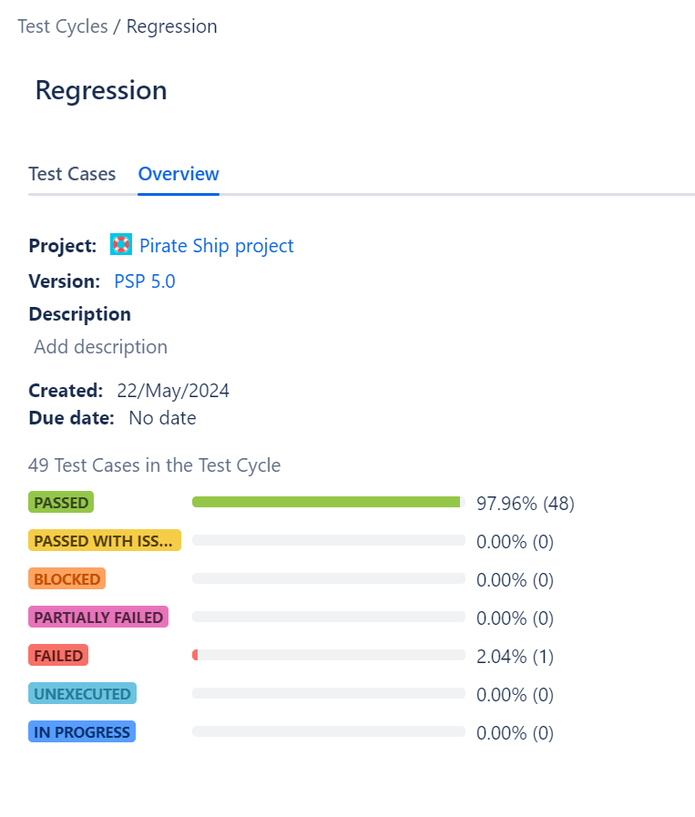

With test cycles, it’s easier to organize and manage test cases (especially when there are many of them). You can monitor the progress of your tests – see how many were carried out, and how many of those passed & failed.

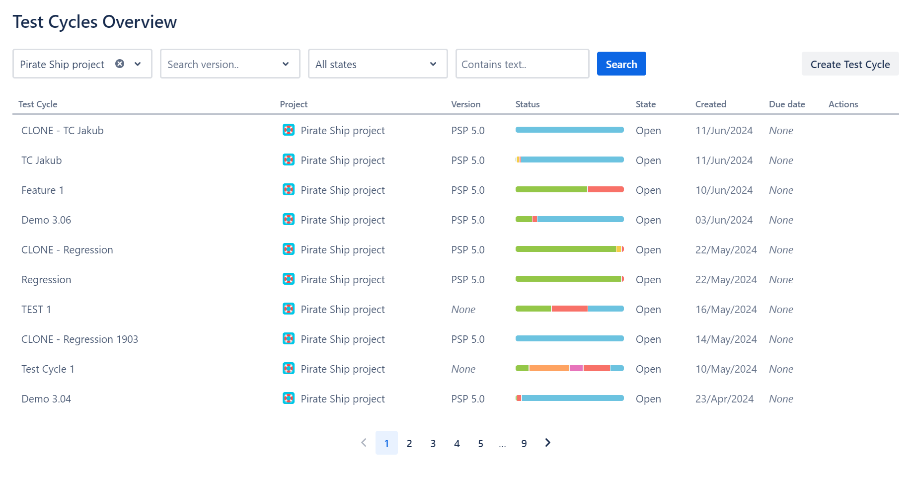

You can see all your test cycles on the overview page.
When you click on a particular test cycle on the list, you will be able to see details of it, such as its status and the number of test cases it contains.

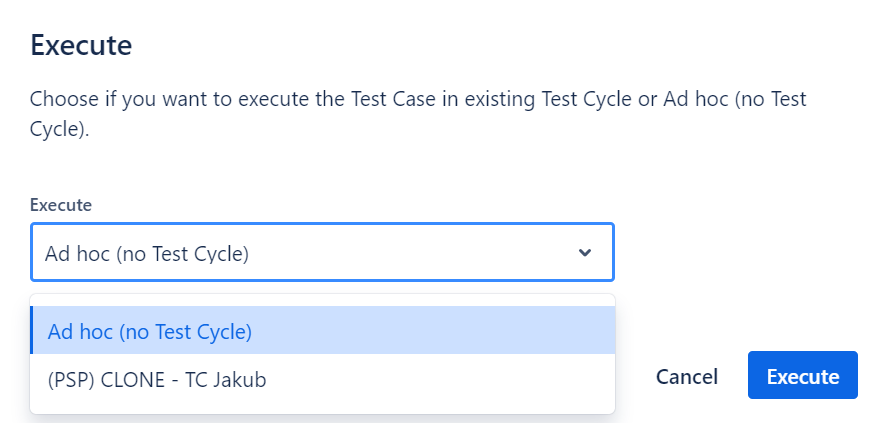

When you have your test case and/or test cycle(s) ready, this means you can now perform tests. This is what test execution is for. In other words, it’s the process of executing the previously prepared test case and checking whether the expected results match the actual results.
