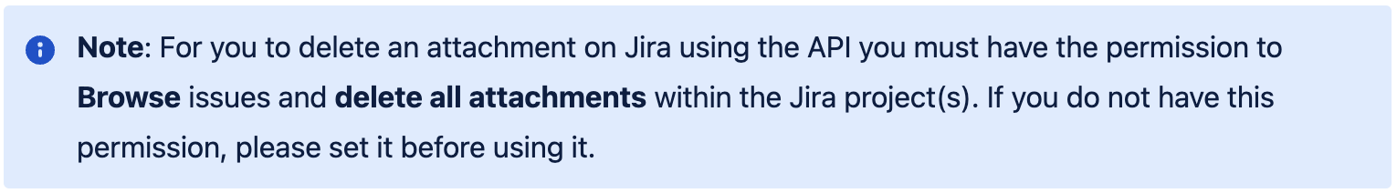

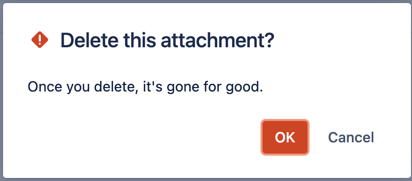

Disclaimer: Please note that deleting attachments is a destructive action that is not recoverable, so take proper care before attempting to use the below method.
This article is going to focus on two use cases that apply the use of the REST API to administer Jira projects in terms of deleting unwanted attachments within issues.

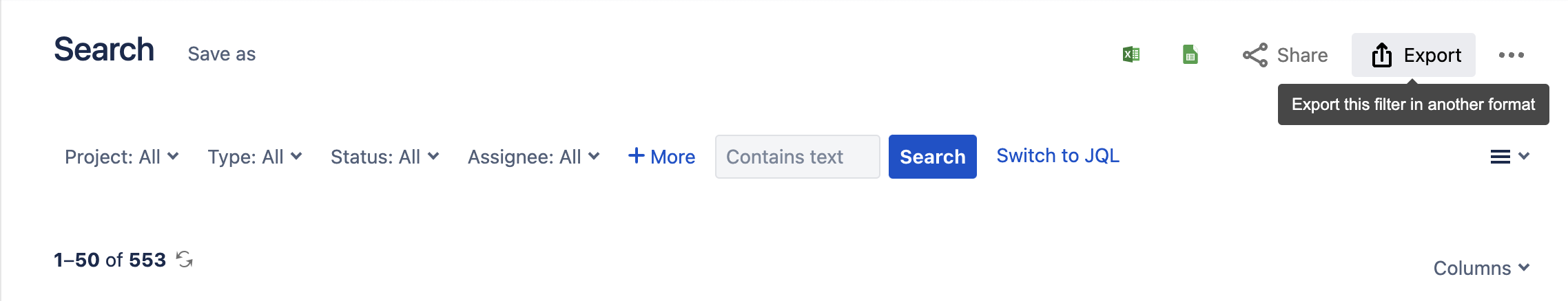

Subsequently, if you do not want to run a search, you can perform an entire export of your filter query from your Jira UI by navigating to your Filter > Advanced issue search, typing your query to get the desired result and click the export CSV all fields.
You do not have to edit the file or change the format in any way. If you’ve exported it as an xlsx file or you’ve modified the file by removing other columns. Please add a delimiter argument and use “;” as the delimiter. Always ensure that the headers are present and not removed. Also, ensure that the “Attachment” and “Issue key” columns are always present in the file.
