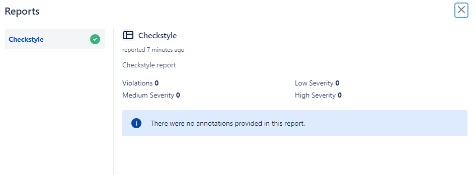

Hi Guys,
I am using scalaStyle maven plugin for my scala project. And I am using checkstyle-report for my bitbucket pipeline. The problem is, pipeline is not able to parse the scalaStyle xml. And I see no result in report.

Error
<span>java.lang.RuntimeException: "line" not found in "<error severity="error" message="Expected identifier, but got Token(RPAREN,),1282,))"/>"</span>
<span>at se.bjurr.violations.lib.util.ViolationParserUtils.getAttribute(<a href="http://violationparserutils.java:81/" rel="noopener nofollow noreferrer" target="_blank">ViolationParserUtils.java:81</a>)</span>
<span>at se.bjurr.violations.lib.util.ViolationParserUtils.getIntegerAttribute(<a href="http://violationparserutils.java:128/" rel="noopener nofollow noreferrer" target="_blank">ViolationParserUtils.java:128</a>)</span>
<span>at se.bjurr.violations.lib.parsers.CheckStyleParser.parseReportOutput(<a href="http://checkstyleparser.java:32/" rel="noopener nofollow noreferrer" target="_blank">CheckStyleParser.java:32</a>)</span>
<span>at se.bjurr.violations.lib.reports.Parser.findViolations(<a href="http://parser.java:117/" rel="noopener nofollow noreferrer" target="_blank">Parser.java:117</a>)</span>
<span>at se.bjurr.violations.lib.ViolationsApi.violations(<a href="http://violationsapi.java:58/" rel="noopener nofollow noreferrer" target="_blank">ViolationsApi.java:58</a>)</span>
<span>at com.atlassian.bitbucket.pipelines.checkstyle.report.Main.main(<a href="http://main.java:89/" rel="noopener nofollow noreferrer" target="_blank">Main.java:89</a>)</span>
<span>Submitted report. Response:200 OK</span>
<span>Request URI:<a href="http://api.bitbucket.org/2.0/repositories/economical/batch-file-ingestion-framework/commit/95f439405b1d4a9b5ade704b11fce8c953cab725/reports/checkstyle-1" rel="noopener nofollow noreferrer" target="_blank">http://api.bitbucket.org/2.0/repositories/economical/batch-file-ingestion-framework/commit/95f439405b1d4a9b5ade704b11fce8c953cab725/reports/checkstyle-1</a></span>
<span>Request Body -------</span>
<span>{"title":"Checkstyle","details":"Checkstyle report","external_id":"checkstyle-1","report_type":"BUG","result":"PASSED","data":[{"title":"Violations","type":"NUMBER","value":0},{"title":"Low Severity","type":"NUMBER","value":0},{"title":"Medium Severity","type":"NUMBER","value":0},{"title":"High Severity","type":"NUMBER","value":0}]}</span>
<span>--------------------</span>
<span>Response Body ------</span>
<span>{"result": "PASSED", "uuid": "{63fd9f91-08fd-5562-b3ee-97a0aca2b598}", "title": "Checkstyle", "remote_link_enabled": false, "type": "report", "created_by": {"type": "user", "uuid": "{415499a5-0b72-4b70-a07b-4e2a63577cee}"}, "created_on": "2021-12-02T18:43:41.591297Z", "details": "Checkstyle report", "report_type": "BUG", "updated_on": "2021-12-02T18:43:41.591297Z", "data": [{"title": "Violations", "type": "NUMBER", "value": 0}, {"title": "Low Severity", "type": "NUMBER", "value": 0}, {"title": "Medium Severity", "type": "NUMBER", "value": 0}, {"title": "High Severity", "type": "NUMBER", "value": 0}], "external_id": "checkstyle-1"}</span>
<span>--------------------</span><span>SEVERE: Error when parsing /opt/atlassian/pipelines/agent/build/checkstyle-result.xml as CHECKSTYLE</span>

warning file=/opt/atlassian/pipelines/agent/build/src/main/scala/com/batchingestion/validation/NotNullValidation.scala message=File must not end with newline character
warning file=/opt/atlassian/pipelines/agent/build/src/main/scala/com/batchingestion/validation/PrimaryUniqueKeyValidation.scala message=Header does not match expected text line=1
warning file=/opt/atlassian/pipelines/agent/build/src/main/scala/com/batchingestion/validation/PrimaryUniqueKeyValidation.scala message=File must not end with newline character
warning file=/opt/atlassian/pipelines/agent/build/src/main/scala/com/batchingestion/validation/Validation.scala message=Header does not match expected text line=1
warning file=/opt/atlassian/pipelines/agent/build/src/main/scala/com/batchingestion/validation/Validation.scala message=File must not end with newline character
warning file=/opt/atlassian/pipelines/agent/build/src/main/scala/com/batchingestion/validation/ThresholdValidation.scala message=Header does not match expected text line=1
warning file=/opt/atlassian/pipelines/agent/build/src/main/scala/com/batchingestion/validation/ThresholdValidation.scala message=File must not end with newline character
warning file=/opt/atlassian/pipelines/agent/build/src/main/scala/com/batchingestion/validation/TraitValidation.scala message=Header does not match expected text line=1
warning file=/opt/atlassian/pipelines/agent/build/src/main/scala/com/batchingestion/validation/TraitValidation.scala message=File must not end with newline character
warning file=/opt/atlassian/pipelines/agent/build/src/test/scala/com/batchingestion/TestingSparkSessionTrait.scala message=Header does not match expected text line=1
warning file=/opt/atlassian/pipelines/agent/build/src/test/scala/com/batchingestion/TestingSparkSessionTrait.scala message=File must not end with newline character
warning file=/opt/atlassian/pipelines/agent/build/src/test/scala/com/batchingestion/SampleTest.scala message=Header does not match expected text line=1
warning file=/opt/atlassian/pipelines/agent/build/src/test/scala/com/batchingestion/SampleTest.scala message=File must not end with newline character
warning file=/opt/atlassian/pipelines/agent/build/src/test/scala/com/batchingestion/services/configparser/YamlParserTest.scala message=Header does not match expected text line=1
warning file=/opt/atlassian/pipelines/agent/build/src/test/scala/com/batchingestion/services/configparser/YamlParserTest.scala message=File must not end with newline character
warning file=/opt/atlassian/pipelines/agent/build/src/test/scala/com/batchingestion/parser/DelimitedParserTest.scala message=Header does not match expected text line=1
warning file=/opt/atlassian/pipelines/agent/build/src/test/scala/com/batchingestion/parser/DelimitedParserTest.scala message=File must not end with newline character
warning file=/opt/atlassian/pipelines/agent/build/src/test/scala/com/batchingestion/domain/metadata/SchemaTest.scala message=Header does not match expected text line=1
warning file=/opt/atlassian/pipelines/agent/build/src/test/scala/com/batchingestion/domain/metadata/SchemaTest.scala message=File must not end with newline character
Saving to outputFile=/opt/atlassian/pipelines/agent/build/checkstyle-result.xml
Processed 50 file(s)
Found 0 errors
Found 112 warnings
Found 0 infos
Finished in 1036 ms
