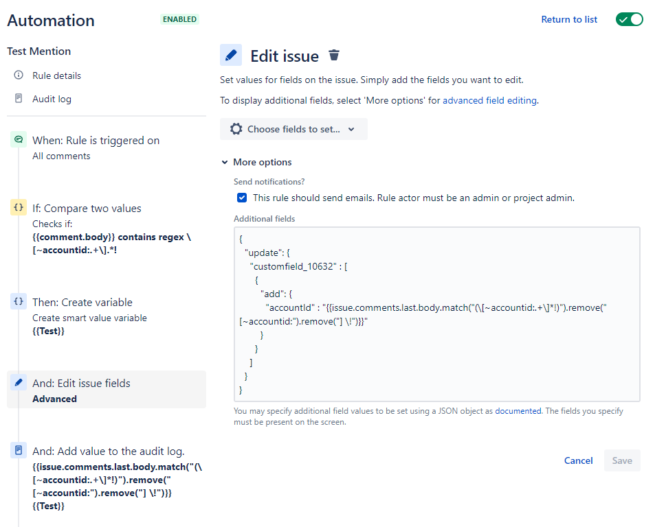

Here's the layout as is.

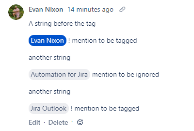

The objective to give people the ability to flag a particular user in a comment by putting an exclamation mark after their mention. The automation should then pick up that user's ID string and add it to a custom multi-user picker.

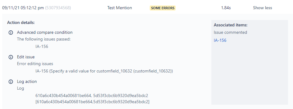

Using a conditional check of {{comment.body}} for \[~accountid:.+\].*! works perfectly, and the below smart value (and string it outputs) seems like the right combination to put into the multi-user picker, but no matter what it gives me the below error in the log.
The second string in the log is a .asJsonArray render from the {{Test}} custom smart value, which has the same smart value is as in the JSON additional field - just with ".asJsonArray" at the end. I've attempted to have the two strings with no space between the comma and second string, only the comma, only a space, asJsonString, asJsonArray - no luck with any of them.
So after all this : what on earth is the delimiter or format needed for multiple id strings for them to to be accepted by a multi-user picker box?
