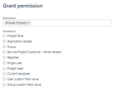

--> If Jira wants to see the board inside the Jira project. user must have "Browse Projects".
This can be customized by the Jira administrator. The permission can be enabled to Project Roles, Application Access, Groups and etc as below.
