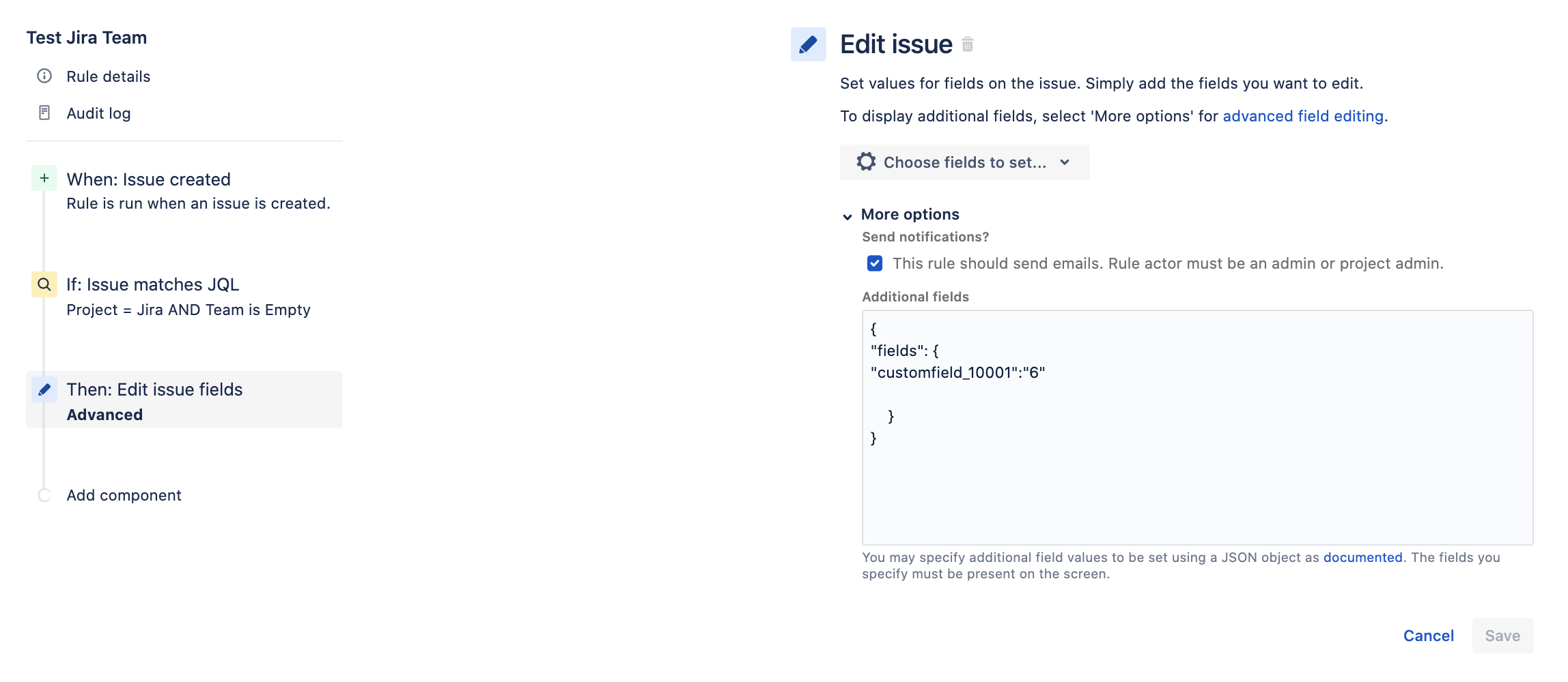

As the idea is to automatically update the Team field when an issue is created, we can set up a pretty simple rule with 3 components:
- The rule trigger is the issue created event.
- Next, we limit the selection of issues with an issue matches JQL condition. In the above example, I selected all issues in the Jira project where the Team custom filled has not been filled out yet. The idea here is to use the board filter for your team's scrum or kanban board.
- Finally, we update the Team custom field with the advanced syntax you can see on the right hand side of the above screenshot.
As this last step is the key to the entire automation, I'll dig in a bit deeper into the logic and decompose the code:
"fields": {
"customfield_10001":"6"
}Make sure you don't forget the { { } } in your code here, as they make sure everything is interpreted correctly by the automation engine.
Apart from that, all you need to do is fill out the custom field ID from the Team custom field and the numeric identifier of your team you retrieved earlier.
Just repeat the process for different teams.
